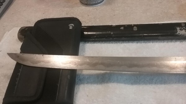

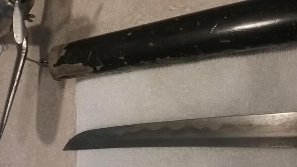

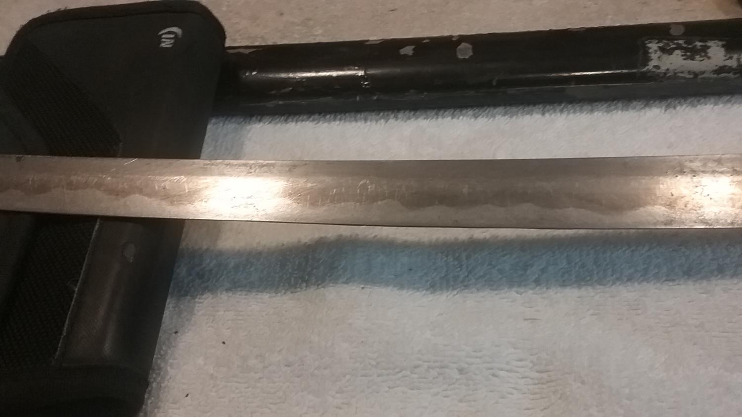

Hello NMB members,
This is a sword I recently purchased from an local area pawn shop. The blade is obviously in fairly poor condition, however, the hamon is still reasonably
visible. I'm having trouble with determining which style best describes the hamon pattern. Gunome, Notare, Toran, combination of all three??? Would definitely appreciate further opinions...
The sword has unfortunately too out of polish to determine any activites, although, there does seem to be a bit of Itame/Mokume grain visible.
Thanks in advance,
Dave
post-2175-0-56886100-1502046196_thumb.jpgpost-2175-0-59182900-1502046237_thumb.jpgpost-2175-0-67798700-1502046287_thumb.jpg
Is the hamon etched on the sword, or is it the real deal? If it is the real deal, as clear and bright as it is on a sword of this condition, then it's very promising. As Axel said, better closeup, focused pics of hamon, nakago, and a shot of the whole sword would help greatly.
Hoanh

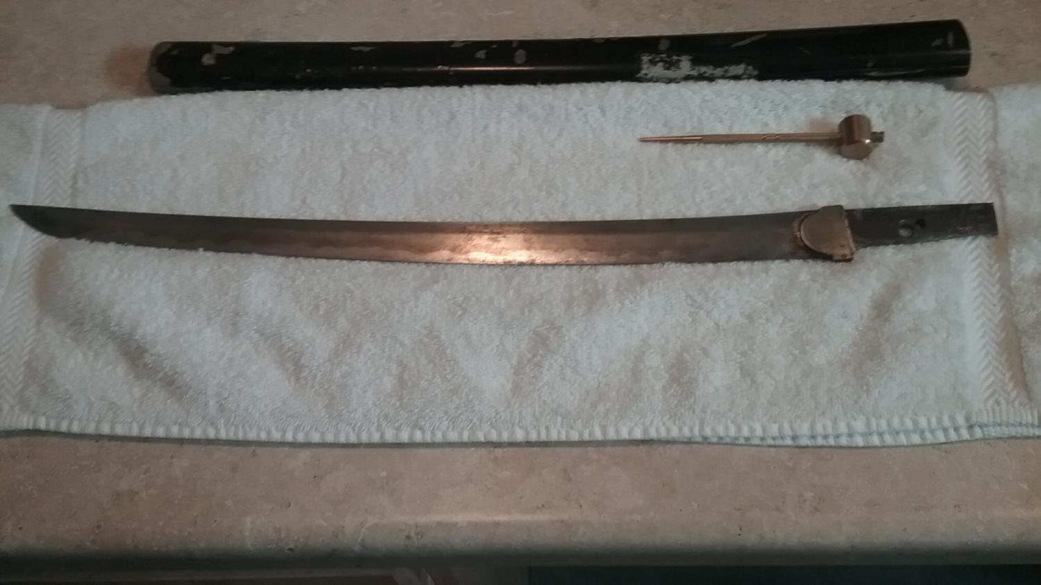

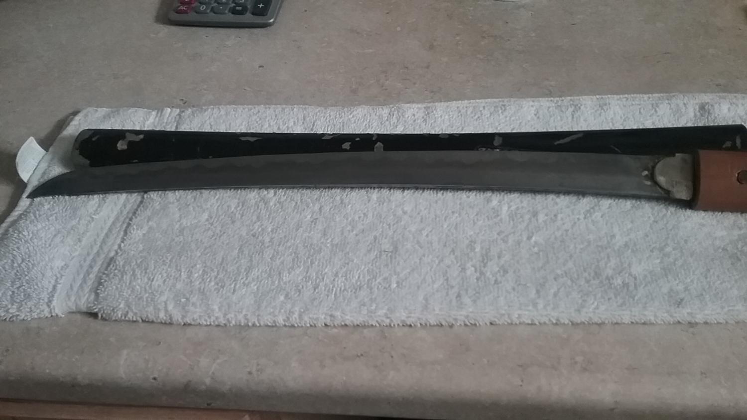

My apologies about poor photos,the sword was pretty much a rescue purchase. Out of polish,modified, etc...
Basically, was hoping there would be enough hamon visible to render an opinion as to style.
Additional photos added, but their not a great improvement beyond the previous...post-2175-0-24703000-1502051063_thumb.jpgpost-2175-0-53121700-1502051282_thumb.jpgpost-2175-0-39308800-1502051497_thumb.jpg
Again Thanks,
Dave

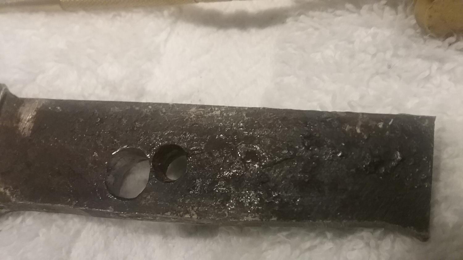

Ok gentlemen, I assure you, I was as horrified as you when I removed a Deer horn handle from the nakago. I was hoping the well meaning good old boy had left the original nakago intact. Oh no, it of course needed modification.
Don't get me wrong, the individual was most likely well meaning, and was simply unaware of what he was doing...
But heck, from the habaki onward, it still has the faded appearance of a once well made blade. I'll certainly keep this sword, and study still what it has left to offer..
Thanks always,
Davepost-2175-0-15892800-1502058356_thumb.jpgpost-2175-0-94091200-1502058421_thumb.jpgpost-2175-0-28659300-1502058472_thumb.jpg

That thing can be removed.
Whatever heat was required to solder it either did or didn't damage the blade. That ship sailed. The equivalent heat to remove it will not make a difference.
Or a chisel.
That said, the nakago is a pure horror show.

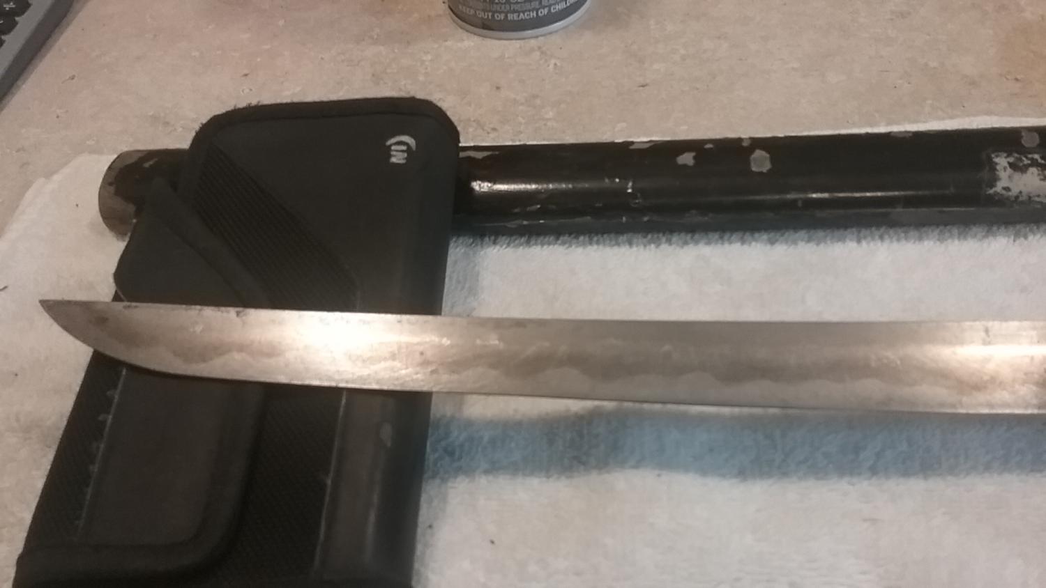

The mihaba of the blade increases just before the "habaki" which is weird "at best" for a suriage sword. So I don't think it's suriage, or normal. I think it is not legit, or if legit, one of the cheap tsunagi type of manufactured things that end up in export koshirae. Without seeing it in hand, I really don't know, but I don't see anything in the photos that would lead me to a hopeful feeling.
I also don't see any hamon, I see two colors of steel similar to reproduction blades that have reproduction hamon on them. Not sure what is causing the positive evaluations.

Darcy, SAS, and Carlo,
Please accept my apology for slow response.
Darcy, I agree fully with your assessment. Unfortunately, as you can see from the photos, this sword has seen an incredible amount of age and abuse. There are no pictures I can take that will present the sword in any better light than simply as is in it's present condition. The sword is difficult to make heads or tale from. It most certainly appears to be an acid etched something or another sword. I do however, as previously mentioned, thanks to folks such as yourselves and the NMB am extremely confident this sword is true nihonto. The Hamon? which which appears in the pictures I think is true hamon possibly enhanced by some means or another. The mihaba question may have been caused by the sword also looking as though it was sent through a mechanical sharpener a time or two.
I will still most likely ask Ted Tarnold to take a look in the near future and will post his opinion..
SAS, No, there's really not much hope, and honestly, not looking for much.
Carlos, No Yokote visible...Shinogi worn and rounded.
Thank you Gentlemen...
It might be interesting to see what Mr. Tarnold has to say with blade in hand. (After the initial horror of course.)
Dave
