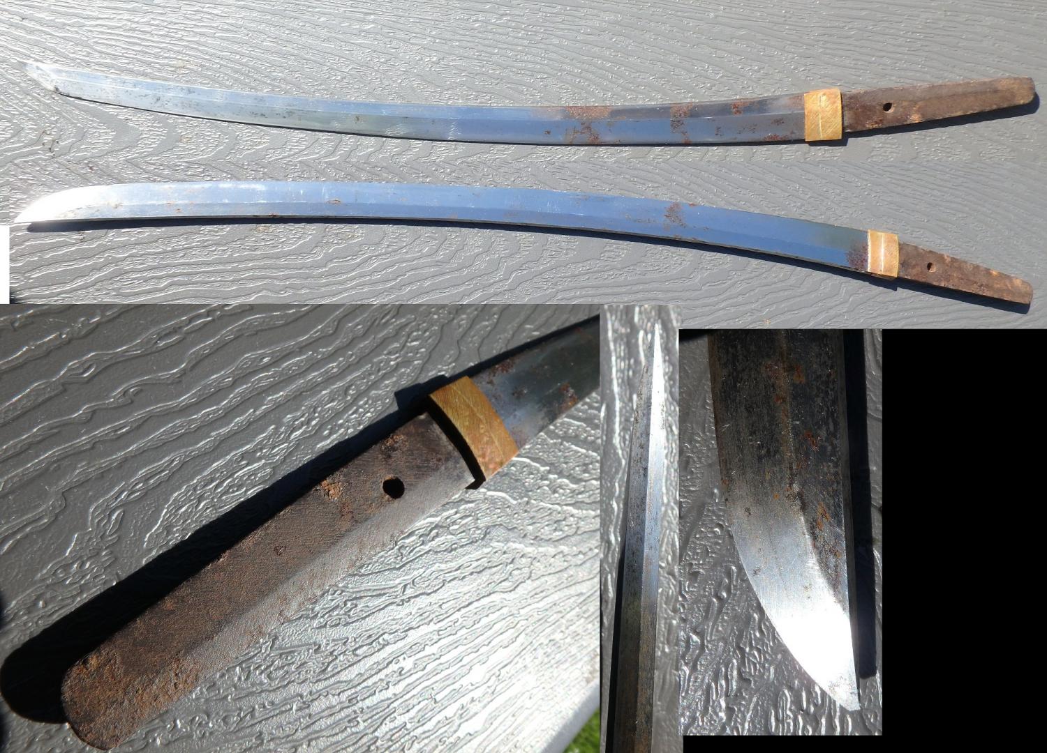

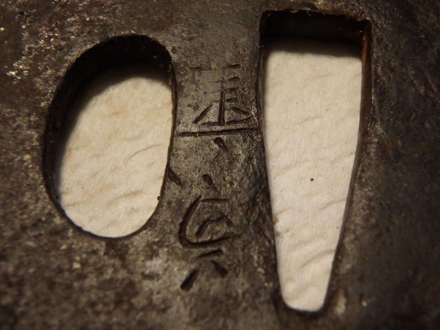

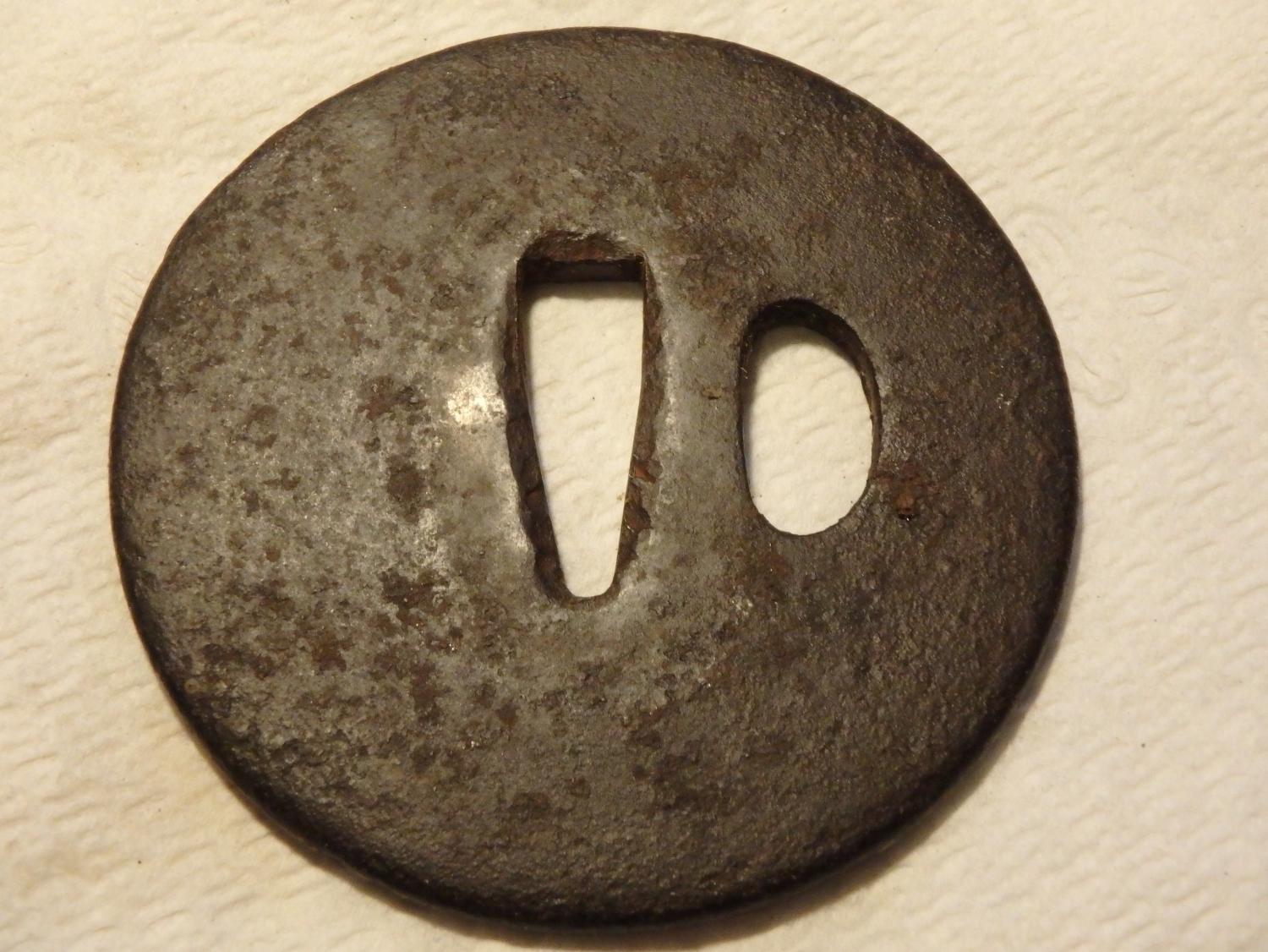

Brando Posted July 25, 2017 Report Posted July 25, 2017 Hello everybody! Im new here and would like to say hello! I used to be a member over at SFI but the Nihonto sub seems to have gone stale. I just recently acquired a wakazashi and was hoping for a little help identifying it or maybe getting an round about age hypotheses. I posted a few pictures on another forum and a very helpful and knowledgeable gentleman told me that the tsuba read "Kaneshige" and that more than likely the sword was from Shinto period. The sword appears to have been put together with strange parts. The tsuka seems to be made from Ceder and scraps of old same, f&k set seem to have that Chinese Ebay feel to them. The seppa dont match, the habaki, tsuba and blade all appear to be Japanese. I have quite the mess going on here. So for your veiwing pleasure or....daily chuckle I present ....Franken-sword. From tip to end it measures 26.5 inches Frome tip of kissaki to munemachi is 21 inches nakago from hamach to nakagojiri is just under 5.5 inches from mitsukado to fukura is 3.5 centimeters Quote

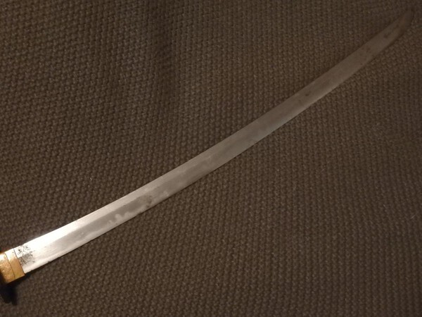

Brando Posted July 25, 2017 Author Report Posted July 25, 2017 Here are some more,..thank you for your patience. Quote

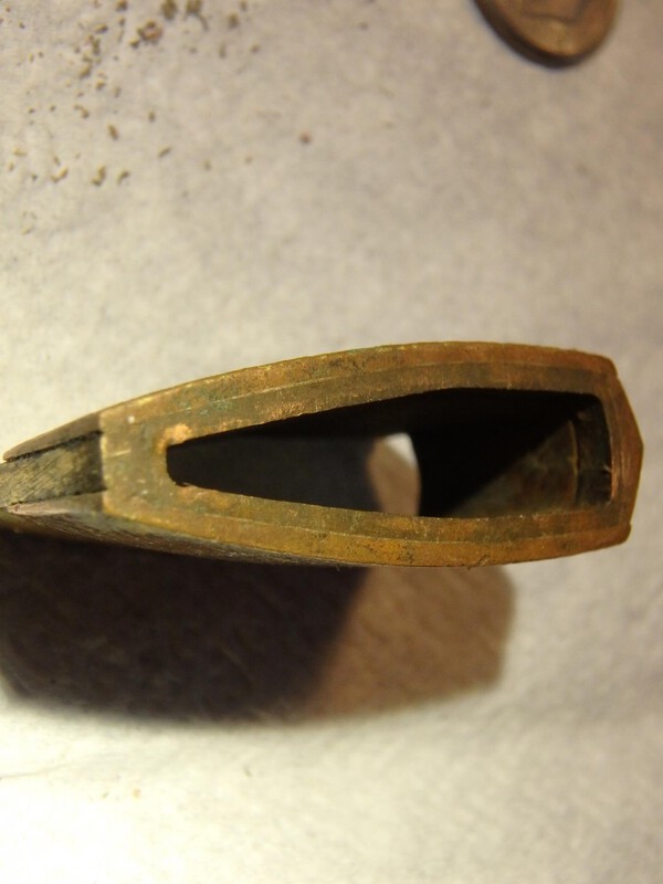

Brando Posted July 25, 2017 Author Report Posted July 25, 2017 Ive seen people wrap there boat oar handles like this....haha.. Quote
SwordGuyJoe Posted July 25, 2017 Report Posted July 25, 2017 Looks like a navy guy - likely boatswain's mate got a hold of it. When they're underway, they'll cover any damn thing sitting still long enough, in knots and braids. 1 Quote

Brando Posted July 26, 2017 Author Report Posted July 26, 2017 Is it such a piece of junk nobody wants to comment?.... or is it an enigma? I was hoping someone could confirm the era of the sword and tsuba. Even if its just a guess...I know nothing at all about it. Quote
Stephen Posted July 26, 2017 Report Posted July 26, 2017 Really? i dont see how we can tell much about it from pix posted. A shinto wakizashi in neglected condition in mid to lower end fittings? you could have it polished and sent to shinsa to know all there is to know about it. That money spent might be recouped by a third if sold. hows that? Quote
Ken-Hawaii Posted July 26, 2017 Report Posted July 26, 2017 Quote Is it such a piece of junk nobody wants to comment? No, it's not junk, but it's far from being in good-enough shape to say it's a collectible. The blade hasn't been taken care of, & the deep gouges caused by the rust COULD be removed by a polisher, but it's simplky not worth the investment. At about $100/inch to polish, you'll have a huge bill, but no way to recoup it when you eventually sell it. When Stephen says it's Shinto, he actually answered your question about era, but you have to look it up so you'll learn something. The tsuba looks to be about the same age, mid-Shinto. The poor condition of the blade makes it impossible to identify much more than that. So enjoy the blade for what it is, & buy some books to study so you won't get stuck with the same type of mess the next time you're ready to buy. Ken 1 Quote
Brando Posted July 26, 2017 Author Report Posted July 26, 2017 Thank you Ken-Hawaii! I realize that one individual identified it as Shinto but I was just fishing for other opinions. I will read more about it, Ive been doing so off and on for about 11 years now. I know enough not to pay for this, but I would find it hard not to pay something for it just to rescue it. Thankfully I dont have any money invested because I literally pulled it out of a waste bin. What do people do with swords like these anyway? Thanks again! Quote
Ken-Hawaii Posted July 27, 2017 Report Posted July 27, 2017 You know enough about the sword to look for info on this forum, so you know that it's Japanese. From the overall shape of the blade (sugata), we can tell the time period that it was made. Telling much of anything else requires the blade to be in better condition, & that's not worth doing. So, as I already suggested, you can keep the blade as it is, knowing you have an older Japanese sword, you can sell or trade it to someone else, or you can toss it back in that waste bin. There is a small amount of value attached to the wakizashi, even in its poor shape, just not enough to make it suitable for refurbishing. This forum is dedicated to preserving that value, so options 1 or 2 apply. My personal suggestion is to go find some uchiko (you can look that up), oil the blade real well while you're waiting, & then uchiko the heck out of your blade. It's cheap, it will remove some of the rust, it won't hurt the blade in its current condition, & it might give you enough details of the hamon & jihada to help you make an informed decision on whether you want to invest any more money. Good luck & have fun! Ken 2 Quote

Toryu2020 Posted July 27, 2017 Report Posted July 27, 2017 Brando Please dont toss it away, and please dont give up on this forum. There is signs of good activity in your blade, and a good cleaning with uchiko could bring more of that out. The shape of the blade and the condition of the nakago suggest shinto. The takanoha yasuri suggests Mino/Seki. Not much more can be said that hasnt already been mentioned. I will say for some, even though its a loss, they might get it polished just to preserve it. Of course only a trained polisher can tell you if it can be restored. -t 1 Quote

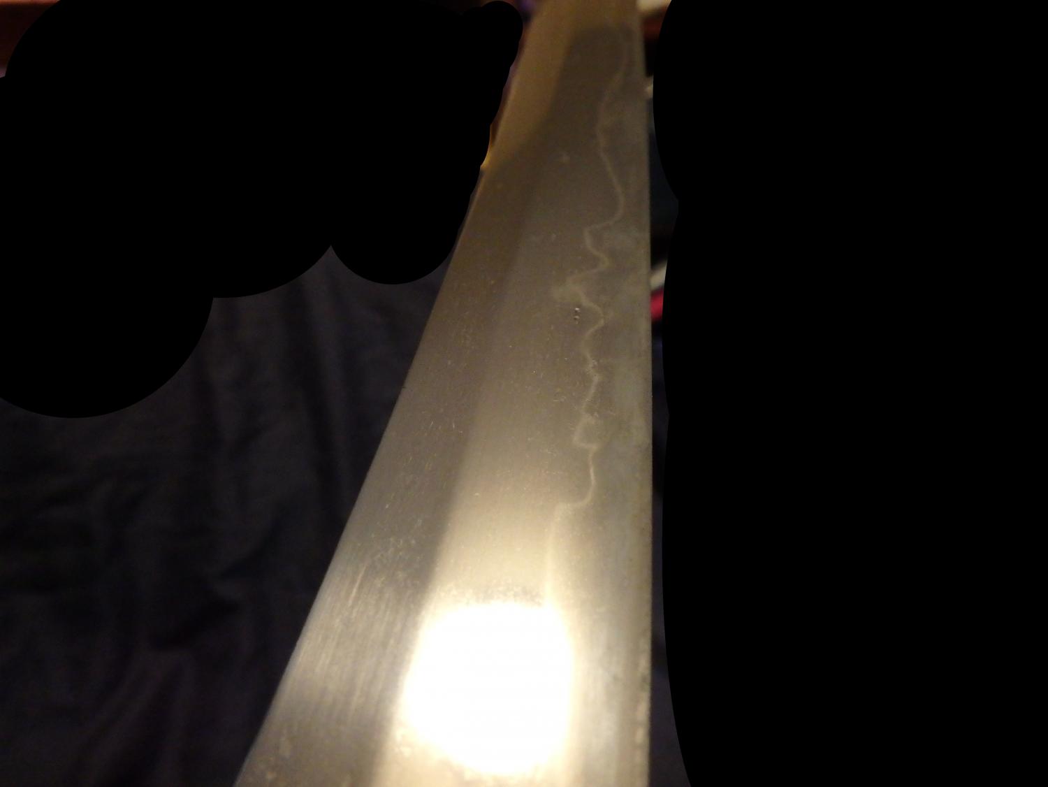

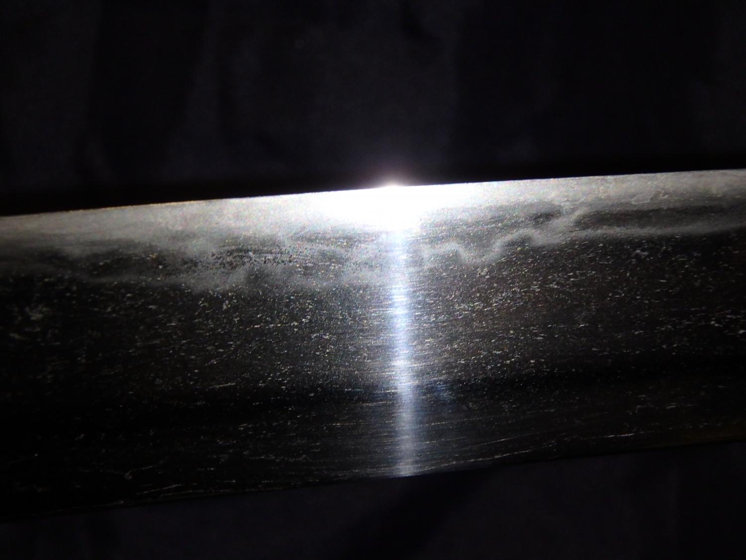

Brando Posted July 29, 2017 Author Report Posted July 29, 2017 Lots of rust damage but I think its looking pretty good... Quote
