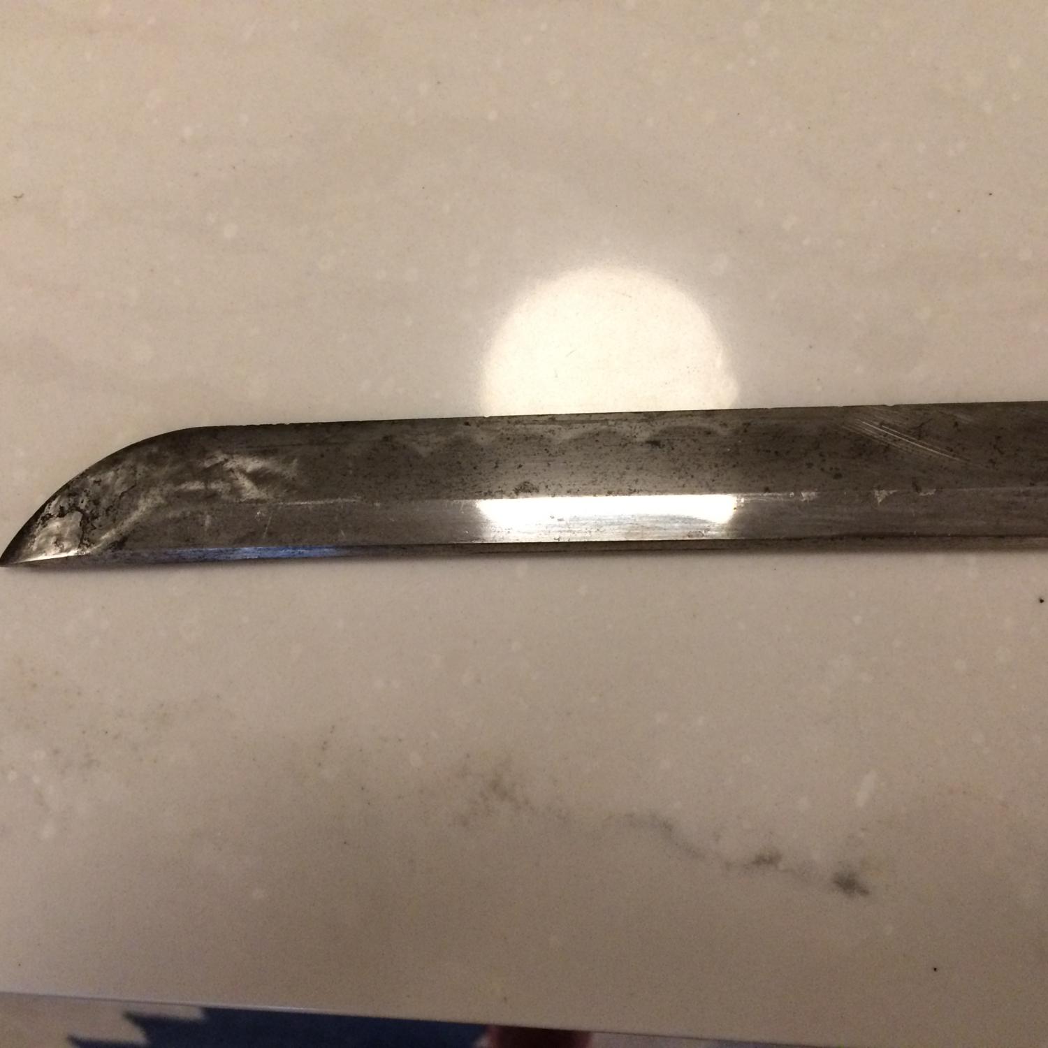

Gentleman, for your viewing pleasure. So, this sword was found in 2009 or so. The owner said her husband bought it at an estate auction, where it was found wrapped in a blanket in the rafters of the barn. The owners of the estate had moved there in the late 40's and had never known of its existence.
Looks in pretty good shape all things considered. Of course, the blade is somewhat rusty and the saya is missing its koguchi. It is signed and has an illegible stamp. All of the koshirae has matching numbers (51 C - and a star stamp, even the tsuba and saya.)

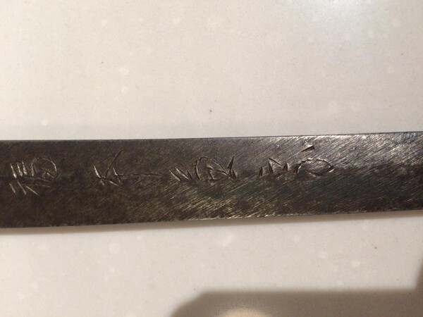

My questions are: The mei? Looks to be of the "chippy" variety. I can't read it. Also, the stamp? I really can't make it out either. Look familiar to anyone? Also, the matching numbers koshirae. Does that denote anything in particular.
I would lean toward "machine made", but I don't know much. I'm sure the photos are not the greatest and will turn sideways (I don't know how to prevent that). Thanks for looking everyone.

I was wondering, is the first (wider) kanji Fukumoto Kanemune, a space, and then the long combination of kanji a date?
