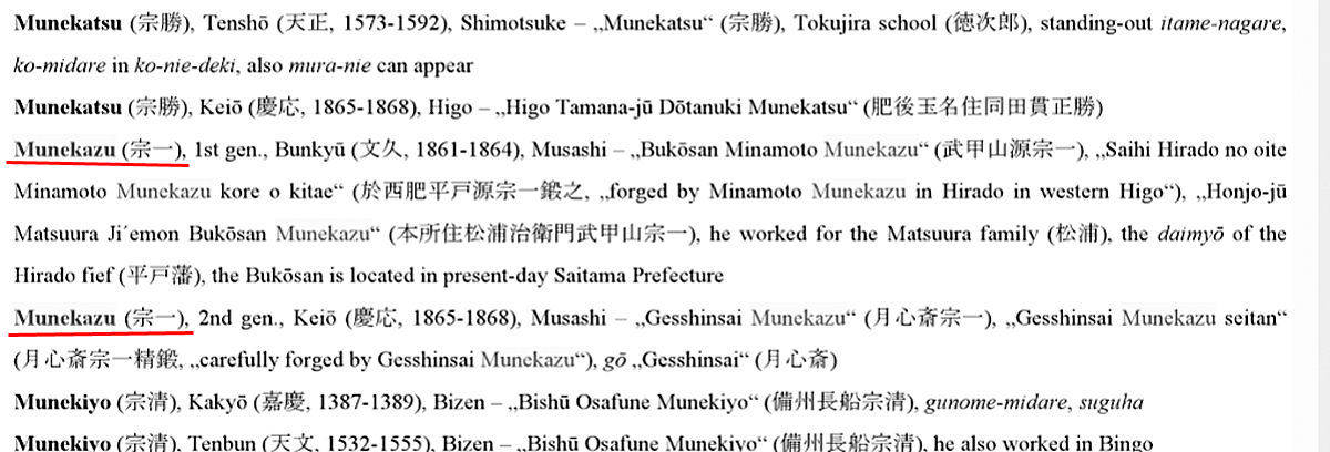

Hi BaZZa,
I found it stated that Munekazu was a member of the Matsuura family, as well as a sword smith. I am not sure if being a member of the family is a blood relation, or an accepted member in a clan.
Thanks for the link. I don't know of the connection between DOI SHINRYO school and Munekazu.
I'll read the information on the link... Thanks!
