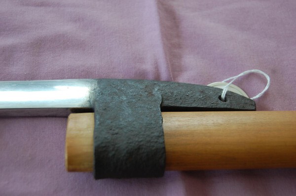

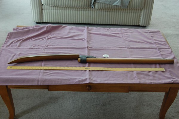

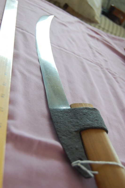

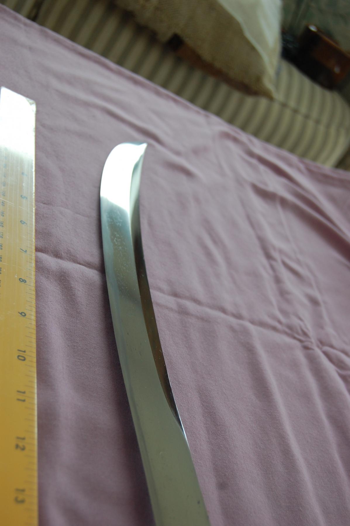

Surfson Posted July 22, 2017 Report Posted July 22, 2017 During the course of buying a collection from the heirs of an old time collector who passed away, I have run across some very interesting items that I thought I would share. I will let the NMB members voice their thoughts about these pieces. They are not the usual samurai artifacts that I typically run across. This item appears to be a naginata that is reminiscent of a battle axe. It has old NBTHK papers to Chikushi (Kyushu) I really hope that some of you can tell us more about it. Quote
DirkO Posted July 22, 2017 Report Posted July 22, 2017 I think it's remeniscent of how earlier naginata developped partly from farming tools. If I remember correctly AOI had a similar one for sale from Saneo , some years ago. Quote
Teimei Posted July 22, 2017 Report Posted July 22, 2017 Here is the version by Saneo: https://www.aoijapan.net/masterpiecesaneo/ Quote
Surfson Posted July 22, 2017 Author Report Posted July 22, 2017 Thanks for the link Florian! Both are referred to as Chikushi Naginata, which is interesting to me. I wonder if they were only made in Kyushu? The Saneo one went for big bucks, but it is signed by Saneo, who was a student together with Kiyomaro. 2 Quote
Teimei Posted July 23, 2017 Report Posted July 23, 2017 Saneo was the elder brother of Kiyomaro and quite famous himself. He was the more conservative and reliable version of Kiyomaro . Quote
SwordGuyJoe Posted July 23, 2017 Report Posted July 23, 2017 I remember that Saneo. I thought it was cool then and still do. Nice pickup! Quote
