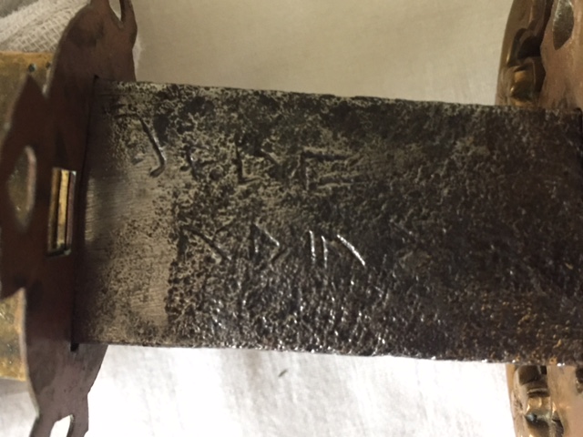

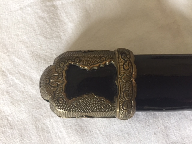

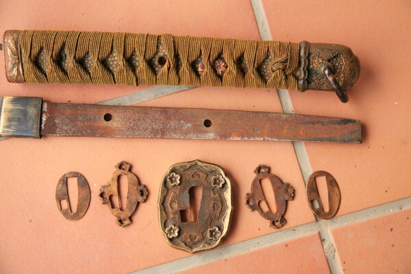

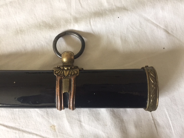

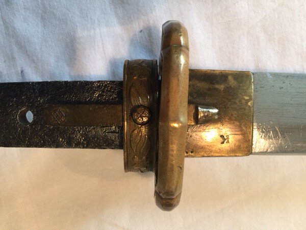

Erwin Posted July 20, 2017 Report Posted July 20, 2017 Dear All, Today I was able to review a Shin Gunto in person to verify its authenticity. There are markings on the Nagako which I posted in the translation help section but also added attached. The blade seems machine made, has some small nicks and damages but nothing major There is also a small marking on the Habaki and the same on the Fuchi. What is your impression on this looking at the attached pictures. I truly appreciate your help in this and thank you upfront for any info you may have With best regards Erwin Quote
PNSSHOGUN Posted July 20, 2017 Report Posted July 20, 2017 Doesn't look authentic to me. The fittings are not correct, cannot tell much about the blade from those photos but nakago are not signed with Katakana. I would run away. Quote
Erwin Posted July 20, 2017 Author Report Posted July 20, 2017 Thank you John, I was sort disappointed with the design and execution of the Ashi, just not symetric or well ballanced. Not sure, thanks at least for your reply and advise Best regards Erwin Quote

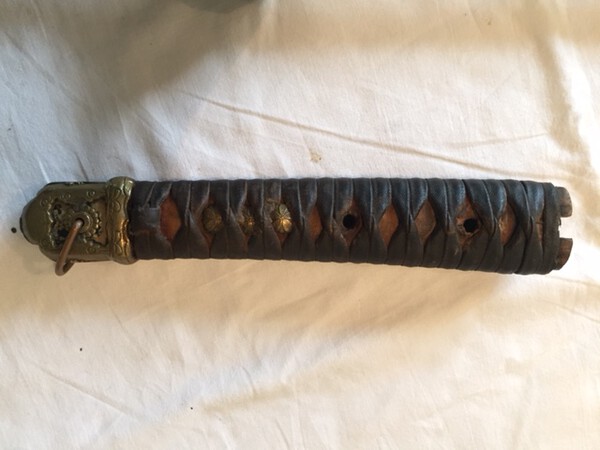

Ed Harbulak Posted July 20, 2017 Report Posted July 20, 2017 Pay particular attention to the handle wrapping which is typical of Chinese reproductions. The cross overs on the ito all go the same way while on genuine Japanese swords they alternate. That's a sure sign it's not Japanese, or at least an indication the nakago was not wrapped by someone with knowledge about the correct Japanese style. 1 Quote
IJASWORDS Posted July 21, 2017 Report Posted July 21, 2017 Definitely FAKE. Again I agree with the other experts, BUY DAWSONS BOOK! Will save you a lot of time (and money) chasing questionable swords...Neil. 2 Quote
BenVK Posted July 21, 2017 Report Posted July 21, 2017 Larger pics would help but I don't see anything Chinese or fake about this. Looks like a genuine old Japanese blade mounted in Navy mounts with an Army Tsuba or are they all Army type 98? I'm not great on fittings. They seem genuine enough though. Tsuka has 2 holes which seem to closely match the mekugi ana in the nakago. Ito wasn't always wrapped in an alternating fashion so I wouldn't dismiss it for that reason. Obviously the blade is the most important part and although it's been poorly "polished", scratched to hell is a more accurate description!, it looks healthy enough and I see no major damage that couldn't be corrected. Quote

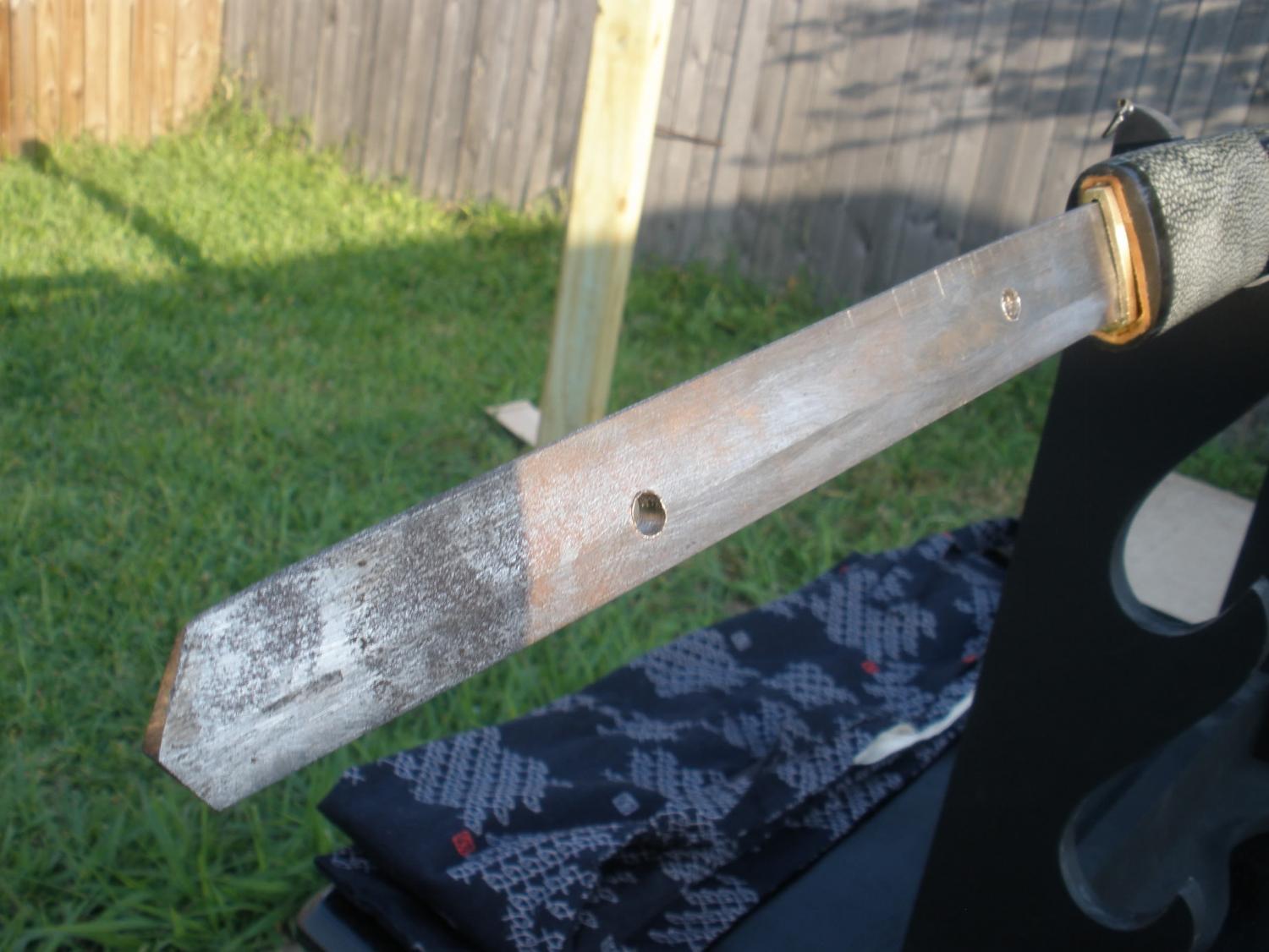

BenVK Posted July 21, 2017 Report Posted July 21, 2017 Happy to admit if I've got this totally wrong which I probably have.. As I said, I'm not great on fittings so will defer to you guys. But it's the nakago that's puzzling me. How does a blade made yesterday, last year or 20 years ago exhibit such deep corrosion/pitting? I own a couple of modern Chinese made blades and they don't look anything like this. I would hate to see a genuine Nihonto thrown out with the bath water before we've had a proper look at it. Quote
PNSSHOGUN Posted July 21, 2017 Report Posted July 21, 2017 Nakago generally aren't signed or marked with katakana. Quote
paul griff Posted July 21, 2017 Report Posted July 21, 2017 Hello Ben, It's not corrosion as such but a deliberately unfinished surface from the manufacturing process..It doesn't have the same characteristic look of age corroded metal...it's too smooth and shiny,no real depth and dare I say it...patina..! With the two "drilled "holes that look the same diameter in the nakago it looks like a deliberate attempt to deceive someone into thinking that it's a remounted blade....? I don't think they will ever get it 100% right and it's good to see them sometimes to keep you "on your toes"....! Have a look at recently "commercially polished" swords on that big auction site and you will see nakago that have been cleaned up during this hasty process....even they retain some patina...! Regards, Paul.... Quote

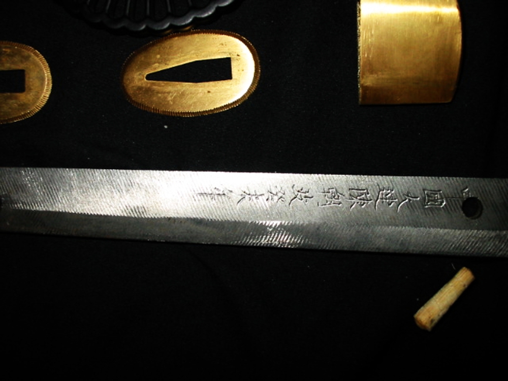

BenVK Posted July 21, 2017 Report Posted July 21, 2017 Interesting, thanks Paul, deliberately unfinished nakago is not something I've heard of or encountered before. In an attempt to show that I'm not bonkers.....yet, I searched online for photos of tangs that are typical of Chinese manufacture, old and new, to compare. Here's a really poor quality example that must be quite an early attempt. Not sure when they started making these, way before my time most probably. Even though it's really poor, the tang has been finished to a certain degree and signed. Quote

paul griff Posted July 21, 2017 Report Posted July 21, 2017 Hello Ben, The only reason I have seen them on reproduction swords is because of the "obsession" that people have to see the "signature"....! The local antique shop buys, and it seems has no problem selling all the "Japanese " swords they can get their paws on ! The only ones they don't attack are the nco's ones,again copies 99% of the time...If you want to see a genuine pitted nakago put Shin gunto by Emura in the search engine,look at images and you will see the one I bought off a board member....It's the one with the bullet damage....Cannot access photo's at the moment or I'd attach some for you and ....if you want a comparison...type in : Japanese sword nakago with fire damage,scroll down images for old swords with pitted nakago....Images are good but you cannot beat the look and feel you get hands on...I was lucky not long after I started collecting there used to be some very helpful dealers / sellers at the Birmingham arms fair ...had some tough lessons before that..! Regards, Paul. Quote
BenVK Posted July 21, 2017 Report Posted July 21, 2017 I own an Emura along with half a dozen other genuine Japanese swords plus a few modern, high end Chinese forged blades. I respect your opinion Paul, I really do and appreciate your input, diolch yn fawr! but I don't get why I'm being ridiculed here. Fact is, the blade in question maybe fake and that's fair enough but I've not seen a fake Chinese blade with a nakago like that before. Show me another that's the same and then I'll get my coat.. Quote
BenVK Posted July 21, 2017 Report Posted July 21, 2017 Searched for"Japanese sword nakago with fire damage" just as you suggested and found nothing. Quote
paul griff Posted July 21, 2017 Report Posted July 21, 2017 Hello Ben, Certainly no ridicule intended or implied..just describing where I have seen the pitted nakago in the past ,and , if you haven't ,where you can see a pitted example to compare against the one in question....Maybe I'm getting too cynical these days ? Another good topic to get get me thinking again though..... Gorau o ran , Paul.. Quote
paul griff Posted July 21, 2017 Report Posted July 21, 2017 Hello Ben, It's on the Google engine same title , 31 image columns down...Markus Sesko has a nice example. Quote
Stephen Posted July 21, 2017 Report Posted July 21, 2017 back to org nakago, one can force corrode a nakago, its done all the time. 1 Quote
BenVK Posted July 21, 2017 Report Posted July 21, 2017 Hello Ben, It's on the Google engine same title , 31 image columns down...Markus Sesko has a nice example. Just give me the link, it's not that difficult! Quote
