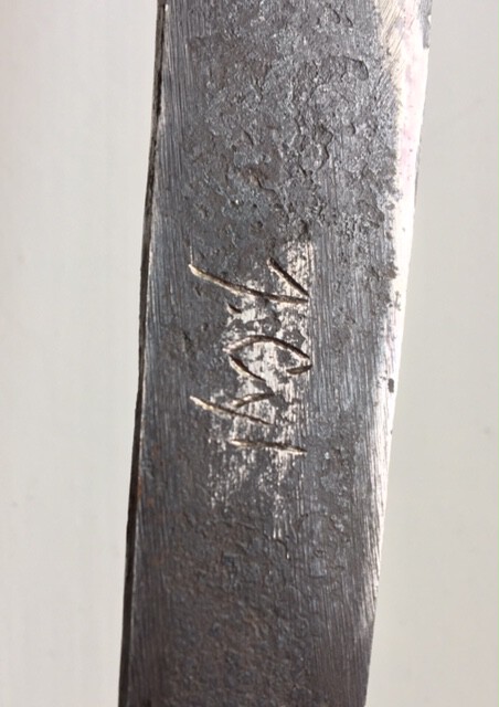

My first post on this forum and hugely impressed with all the knowledge and insights reading through the posts. I am a proud owner of several katana's mainly from the WO2 time area. I have now come across a katana which I find difficult to place. Unfortunately the tang has most likely been modifieid to fit a Tsuba, Fuchi en Kashira from another area but not sure on this nor from which time these come. The mei in the tang is hard to identify, I believe it states "1911" but am really not sure. I do not have more pictures at this stage but the katana is up for sale and keeps fascinating me. Is there anybody out there who can say somthing meaningful on this? your help is much appreciated.

Better pictures would help us to offer thoughts. Is your second picture the nakago?

Indeed, the second picture is from the nakago and unfortunately I do not have better images at this stage.

This nakago screams Chinese fake at 95%. But 2 lousy pictures don't help much. Waiting other photos to add the remaining 5%.
I really doubt a Japanese smith would leave forging scale on the nakago....perhaps we could say it is "definitely forged" :-o
Erwin, welcome to the forum. What is being said, based on just two photos, is that the nakago is definitely not typically Japanese. The yasurime are very odd, the shape is irregular, & there is strong evidence that the forging was done incorrectly. Nakago are NEVER modified to fit a tsuba! The first estimation is that the blade is a Chinese "knock-off" of a Japanese blade; i.e., a forgery.
