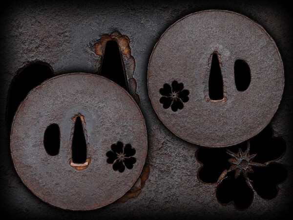

parfaitelumiere Posted September 25, 2017 Report Posted September 25, 2017 Here is my first old iron diameter is about 8,3cm, thickness, 3,5mm on the rim, then quickly thinner and increasing thickness when we go to center. Quote
parfaitelumiere Posted September 25, 2017 Report Posted September 25, 2017 Thanks a lot,I tried to be as accurate as possible, especially the colors are ok, kind of dark reddish brown, with some almost black areas on seppa dai.I wanted to get full view on both sides and close up, but on same picture.My standart size is 1920x1080, but I had to make a bit higher size for this one, to keep quite large full view of each side.I took a shot of all my tsuba today, and I will do same for other, and also a view of all together (same scale).Shame, I have a heianjo, and 2 plain iron tsuba, not yet home, one is mokume pattern, but probably some new patina to do on it.I have another old iron to put on this thread, even I think it's much younger than the one I just pictured.Just simplicity, one round, 3 holes, for 3 blades. Quote

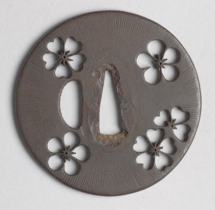

parfaitelumiere Posted October 2, 2017 Report Posted October 2, 2017 I have question about a specific tsuba design refered as "ko katsushi"I found this picture, described as momoyama period, size 8,4x8,4x0,4cm from jggilbert website. amida yasuri, and some remnant nunome zogan file marks here and there. I later found this picture, smaller,7,7cm, but far better condition, with original hitsu ana shape. No information about thicknessIt is described as kamiyoshi school, 17-18th I finally found this one, 8x8x0,3cm, no hitsu ana no amida yasuri, no numome.Some thick rust here and there: We can clearly see it's same maker or at least same school using same technic and pattern, but different finish, from most elaborated on top to simpliest on bottom (no amida yasuri or nunome zogan)But is it possible to fix a period, it seems the ume flower patter is very popular at least from mid muromachi.I have 2 other ume flower pattern the one I pictured in this thread is obviously muromachi period for me. my other is obviously later, thicker plate, more simple steel too, and far better condition. But this one with 5 flowers, how to determinate a period, can we consider no hitsu ana, thinner plate and quite larger size to put it older, or can we consider the same design could survive for more than 200 years with no or only a few modifications? Quote
sabi Posted October 3, 2017 Report Posted October 3, 2017 Patrice, The short answer to your question is the latter. You'll find some sukashi patterns that are almost entirely exclusive to a specific school, but this isn't one of them. That busy sakura/ume motif is seen on old tsuba like the one from Jim's site, then mid-Edo Umetada and Yamakichibei among many others, and finally on late mass produced, cookie cutter guards which is what I suspect the third one to be (although its horrendous condition makes it harder to properly assess). Quote
