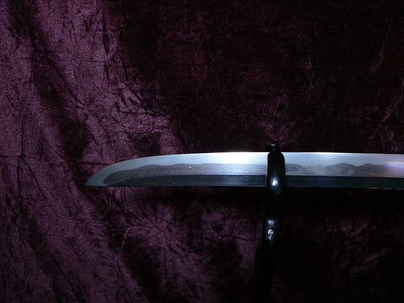

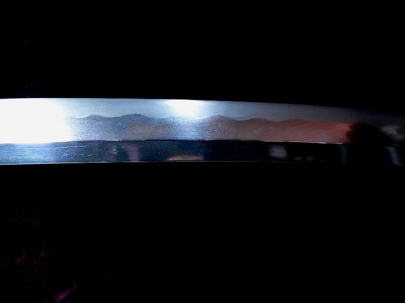

James Posted August 14, 2008 Author Report Posted August 14, 2008 Well the agent contacted me today with photos of my newly polish wakizashi. I'm crushed at the fact that after all that was said to him, the sword received a cosmetic hamon. I cannot believe this, and I don't know what to do really. Any suggestions? Below is a photo of the eyesore I refer to as a hamon. Compare that with Jacques example and that'll leave no doubt in one's mind. Please, advise or suggestions are needed.
