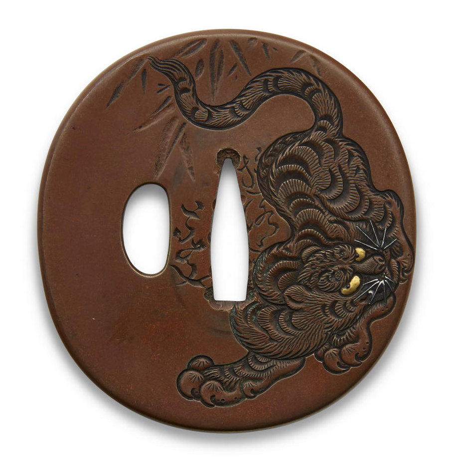

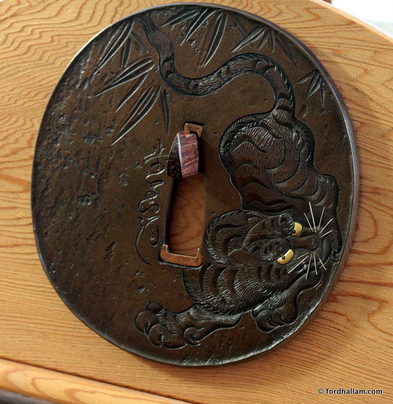

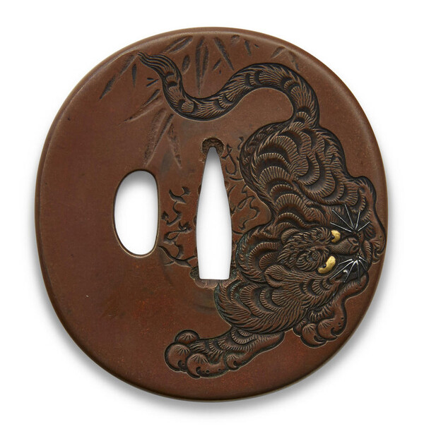

Ford Hallam Posted June 14, 2017 Report Posted June 14, 2017 This is a link to the Ironbrush forum where I've posted a 75 image photo essay that details the stages in making a Sekibun inspired tiger tsuba. We don't know for sure how pieces like this were actually made in the past but perhaps these images will at least provide some idea of quite how labourious and exacting creating even an seemingly simplistic tsuba really is. This is the original in copper. and the version I created in old wrought iron. 8 Quote
John A Stuart Posted June 14, 2017 Report Posted June 14, 2017 I love copper, but, that iron version is even better. The carving slightly more detailed and crisp. Very nice carving. John Quote
TETSUGENDO Posted June 14, 2017 Report Posted June 14, 2017 Great photo essay,I felt as if I was peeking over your shoulder as you worked! You have lifted your tiger off a sheet of paper, animated him (his hair seems to bristle in the wind) and framed him in a real environment. Each is different,both wonderful. -StevenK Quote
Ford Hallam Posted June 14, 2017 Author Report Posted June 14, 2017 Thanks Gents, glad to hear you enjoyed 'the journey' and like the results. Quote
Gakusee Posted June 14, 2017 Report Posted June 14, 2017 Both are beautiful. The iron gives it that extra drama and nuancing. Quote
