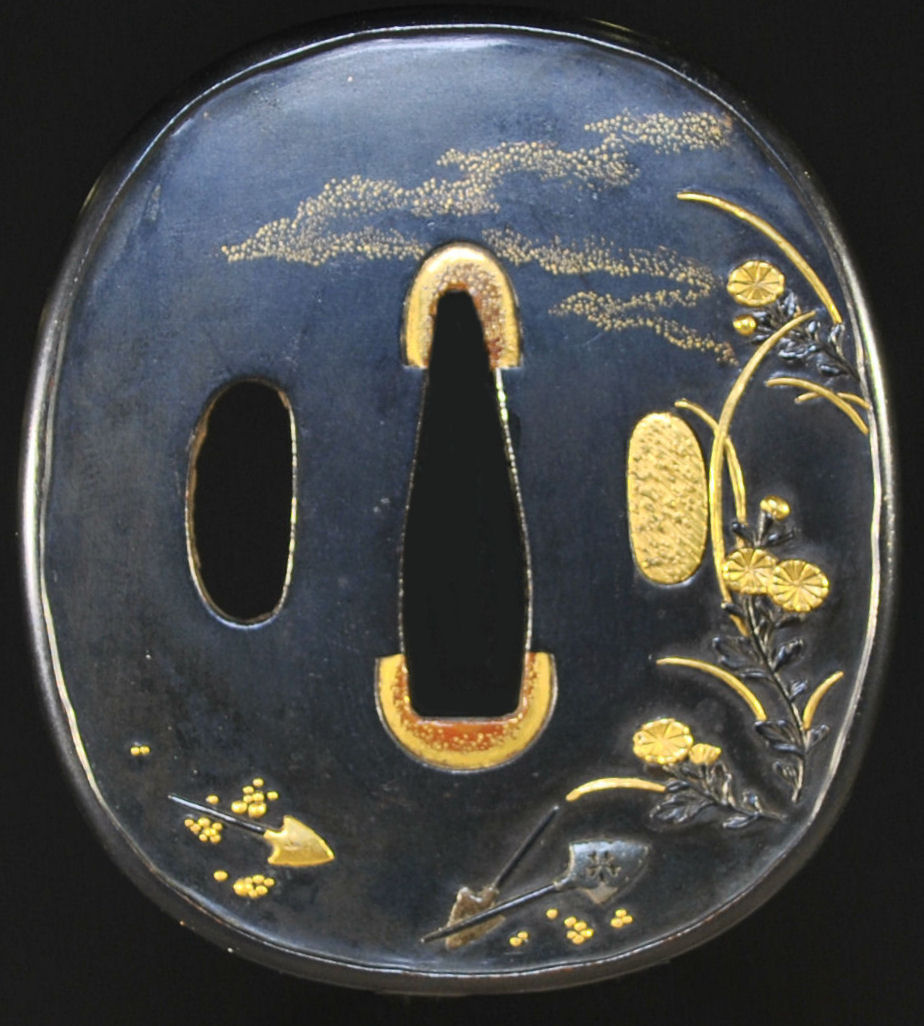

kissakai Posted May 27, 2017 Author Report Posted May 27, 2017 Thanks for the relies It looks that there could be too many pitfalls unless from a known dealer I will have a look for Toryusai as well It looks like the prices will be to high for me especially if they are 'flavour of the month' There are four in the Birmingham museum Three are the normal brown patina and then there is the one attached The other favourite in the Inaba school and they have three of these Grev 1 Quote
