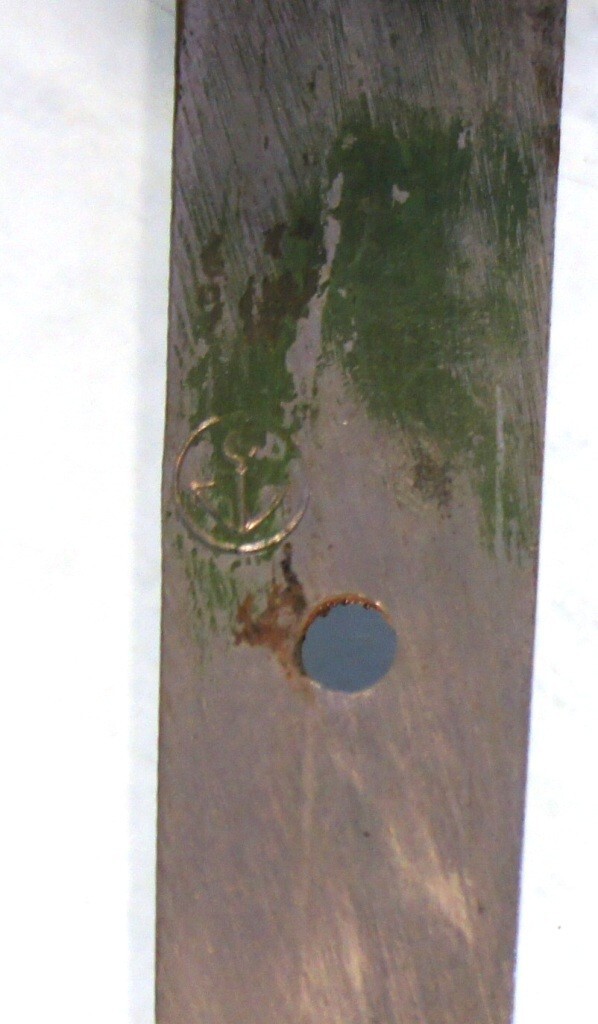

Jcstroud Posted May 28, 2023 Report Posted May 28, 2023 I think one aspect up until now has been largely ignored is the presence of green paint in the area of anchor stamp and its significance.since almost all have it as well Quote
John C Posted May 28, 2023 Report Posted May 28, 2023 The mei on my Kanehide gendaito has the green assembly number paint inside as well. So clearly applied after the sword was finished. But when, where, by whom, and for what exact reason are the questions I am trying to answer through a study of assembly numbers. Nothing interesting to report so far. The only patterns I have identified to this point are that 1) some smiths (or shops; or factories) used the same paint color consistently and 2) the number of digits seems to be consistent (usually 2,3, or4 with some having a katakana or western letter prefix). John C. Quote

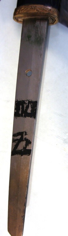

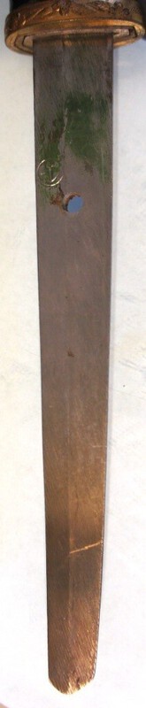

Bruce Pennington Posted June 4, 2023 Author Report Posted June 4, 2023 Update on the Souvenir Chart, with a mumei, large anchor, blade, shaped nakago jiri. Fittings are all navy except for army menugi & haikan. Plus navy kabutogane has no floral designs, just plain edges. OH - and duplicate # 45, Quote

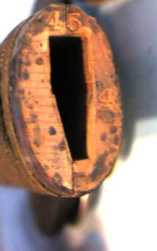

Jcstroud Posted June 4, 2023 Report Posted June 4, 2023 Does it have any stamped nunbers or modified roman numerals? would like to see them to compare.likely they were working in lots of 100 maybe. Quote
Bruce Pennington Posted June 4, 2023 Author Report Posted June 4, 2023 On 6/4/2023 at 4:15 PM, Jcstroud said: stamped nunbers Expand Fitting numbers match the painted number: Quote
Jcstroud Posted June 4, 2023 Report Posted June 4, 2023 Appears to be the same stamp what do you think? Quote
Bruce Pennington Posted June 4, 2023 Author Report Posted June 4, 2023 Maybe I'm being picky, but the top, horizontal stroke of the first 5 seems to curve upward, while the bottom one is completely flat. Also the bottom 4 has a horizontal stroke at the bottom, but I don't see that on the top one. Is the top one from our Toyosuke 45? Quote
