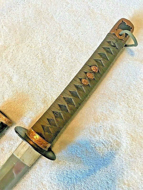

Bruce Pennington Posted March 26, 2023 Author Report Posted March 26, 2023 13 hours ago, Jcstroud said: One more John, An interesting example. Everything about it fits the souvenir configuration. Quite unusual though, is the seeming wear on the tsuka. The ito shows darkening of hand oils, and the same' under the kabutogane shows wear. Don't know what to think about that. Quote
Jcstroud Posted March 26, 2023 Report Posted March 26, 2023 One other thing I noticed is the kabutogane does not have the cherry blossoms like others these areas appear to have been filed and wirebrushed ages ago, the same appears to be deteriorating from age .and perhaps a few hard knocks. Thank you for your patience its seems I have left no stones unturned. Thank you all.who knows maybe we will figure out who was Toyosuke.? Oh well keep the faith. 1 Quote

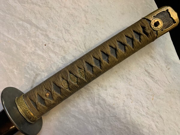

John C Posted March 26, 2023 Report Posted March 26, 2023 1 hour ago, Jcstroud said: kabutogane does not have the cherry blossoms JC: Not to worry about the kabutogane. It is one of the hallmarks of the souvenir sword. The pic is of mine for reference. John C. 1 Quote
Bruce Pennington Posted March 26, 2023 Author Report Posted March 26, 2023 Ok John & John! Now you got me going into something new. I'm out of time and will update when I get back, but going through the first quarter of my files, looks like the souvenirs with the Toyokawa stamp on the nakago, all (so far) have the smooth kabutogane. Nakago without anchor stamp seem to be in fittings with textured kabutogane, some with sakura & leaves, some without, but still textured. Very speculative here - but what if the textured kabutogane, missing Toyokawa stamps, were made by the Japanese Sword Co.? Quote
John C Posted March 26, 2023 Report Posted March 26, 2023 5 hours ago, Bruce Pennington said: Nakago without anchor stamp seem to be in fittings with textured kabutogane, I might be misunderstanding this, however I am not sure we can tell anything by the textured kabutogane. I did some quick research and found a few (4 or 5) that were stamped and had textured kabutogane (including mine). I did notice, however, that none of the kabutogane of the 11 I found had sakura leaves. Then again, I only found ones that were stamped. FYI: I had searched for "Toyokawa stamp" and just "kai gunto" and looked at every sword that was a souvenir. Found 10 of them; all being marketed as ww2 navy kai gunto. On a separate though related issue, I think a lot of the confusion over these is perpetuated by what Fuller and Gregory had written (see pic). Would it be possible to contact them (or the publisher) about a book revision? John C. Quote

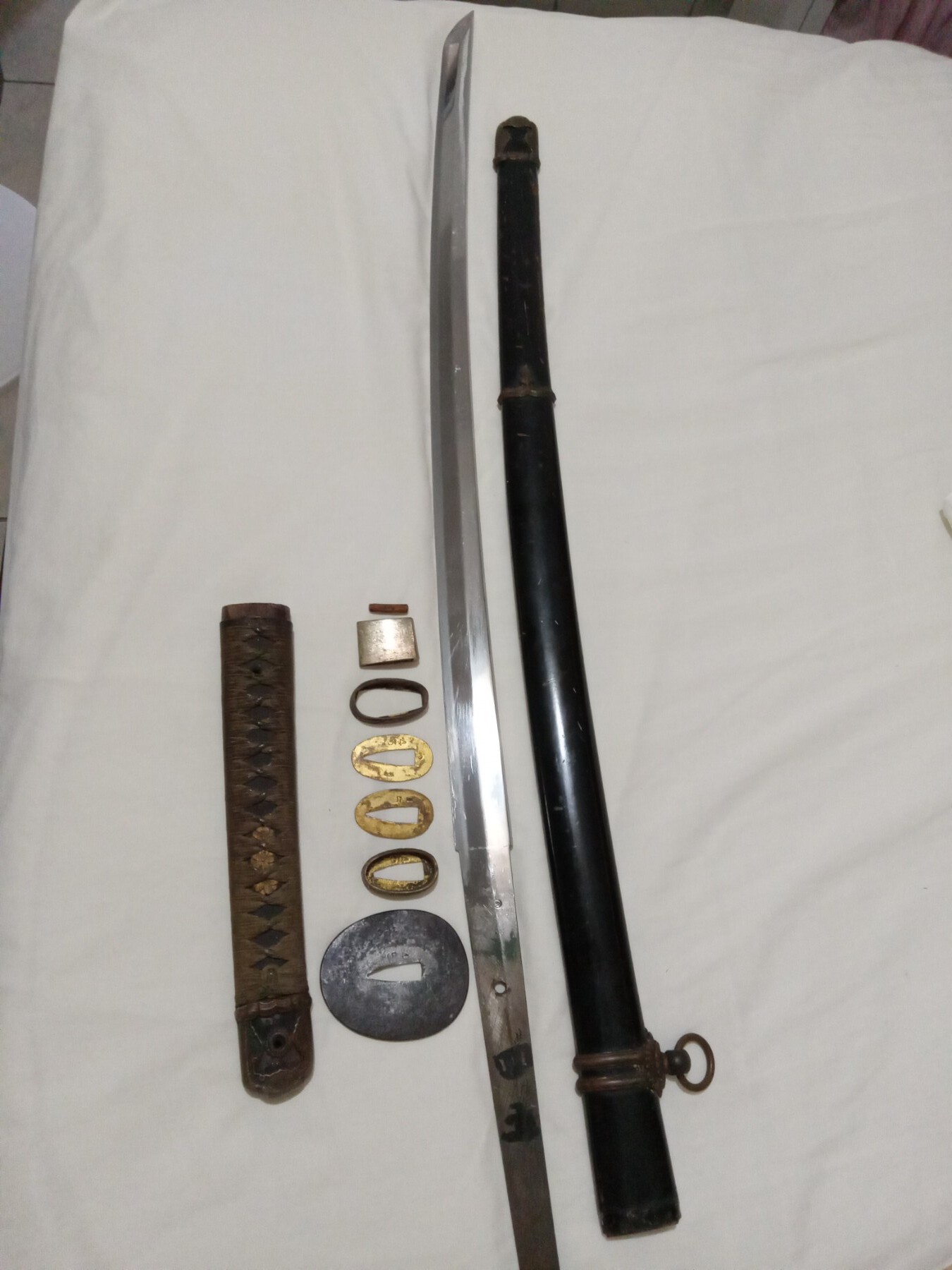

jeep44 Posted March 28, 2023 Report Posted March 28, 2023 I didn't realize you were keeping a register of these swords-here's mine: Quote
John C Posted March 28, 2023 Report Posted March 28, 2023 10 minutes ago, jeep44 said: last photo Douglas: That's interesting. That is only the second one I have seen with Navy kabutogane and menuki. @Bruce Pennington FYI. John C. 1 Quote
