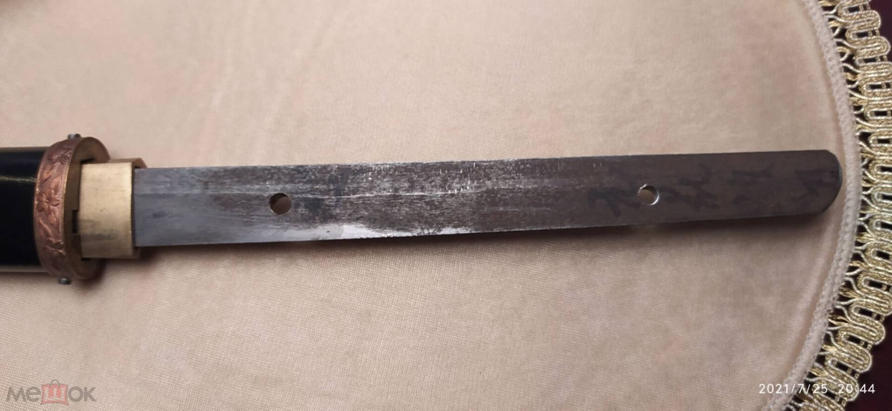

Bruce Pennington Posted October 26, 2021 Author Report Posted October 26, 2021 Wanted to post this one, found on THIS GUNS.RU THREAD. It has an undated blade with mei: Takayama To Masahiro made this; with small Toyokawa anchor. From the shadowing of the kasaki, it appears to have the fat tip of the Takayama styled blade. So the question is - did Masahiro continue to work for the Tenzoshan factory making blades for the souvenir operation, or was this a surplus blade? It is the first Takayama-to I've found in one of these. The growing variety of smiths and blades I'm finding in them seems to support the idea that at least some of the over 8,000 souvenirs they sold had surplus blades. 1 Quote

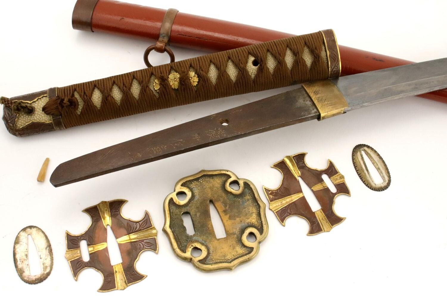

Bruce Pennington Posted January 19, 2022 Author Report Posted January 19, 2022 I want to post these two from a discussion on the Translation Forum, to consolidate the items to this topic. One is a souvenir for sale on fleabay (mislabeled as a Navy kaigunto - seller notified) and the other posted by @MacTheWhopper HERE. They are interesting because both blades were made by Toyosuke, a Toyokawa Navy blade in Type 98 fittings, and the other in souvenir fittings. Toyosuke in Type 98 fittings: Toyosuke in Souvenir: So, either this smith was actively making swords both before and after the war, or as a minimum, there were surplus blades of his to use by Tenshozan after the war. Still doesn't prove either case, but I found it fascinating to see blades of the same smith in both wartime and post-war fittings. 2 Quote

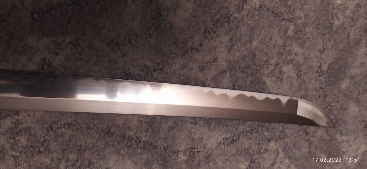

Bruce Pennington Posted February 21, 2022 Author Report Posted February 21, 2022 Here's an odd-ball for even the souvenir sword. Found on this Guns.ru thread. Over there, they immediately labeled it as a Chinese fake. I immediately labeled it as a post-war souvenir. But I am bothered by a few things. 1. The nakago is poor. No yasurime. Painted numbers, except for the first one, look like jibberish. Ana at end looks recently drilled. 2. There is actual same' and ito isn't the normal icky pale green found on souvenirs. 3. The army metal fittings aren't gilded. 4. Too many seppa for a souvenir, and the fuchi isn't the 1-piece fuchi/seppa. 5. The hamon looks fake. Could the Chinese fakers actually be faking the post-war souvenir??? Or, is it just a Chinese blade put into souvenir fittings? Or is it just an odd-ball? I have seen slight variations in them, albeit rare. Quote
PNSSHOGUN Posted February 21, 2022 Report Posted February 21, 2022 This looks more like a mix of fake and real parts. The blade is certainly not Japanese. 1 Quote
ROKUJURO Posted February 21, 2022 Report Posted February 21, 2022 6) The new TSUKA-ITO is not bound correctly the Japanese way. 1 Quote
vajo Posted February 21, 2022 Report Posted February 21, 2022 The bind looks in the same direction for me Jean. Typical chinese style. The seppa is not patinated. The fittings look very cheap. I think its fake. Quote
ROKUJURO Posted February 22, 2022 Report Posted February 22, 2022 That is what I meant, Chris. 1 Quote
vajo Posted February 22, 2022 Report Posted February 22, 2022 Ah sorry Jean. In my ignorrance and less english i overread it. Quote

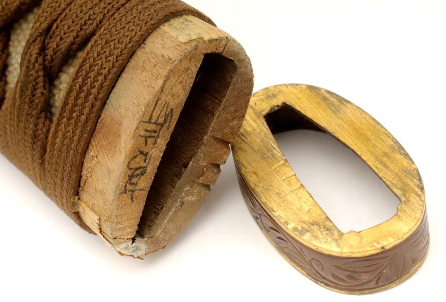

Jcstroud Posted March 14, 2023 Report Posted March 14, 2023 Wanted to repost photos of a toyosuke sword that I posted in2016 titled"mystery marine mount in Puerto rico so as to perhaps dispel the put together from parts theory on some of the toyosuke saku blades in the photos you will see all parts numbered 45 in3 different formats ,ŕoman numeral,modified roman numeral, and in black paint kanji. However I cannot be sure when it was made. Quote
Jcstroud Posted March 14, 2023 Report Posted March 14, 2023 Will ad more photos as the app will allow kudos to Bruce Pennington onhis arsenal stamps pdf a truly excellent reference source for newbys like me. 1 Quote
Jcstroud Posted March 14, 2023 Report Posted March 14, 2023 After having seen 6 different toyosuke saku swords all but one were the same except 1 shingunto. Quote
Jcstroud Posted March 14, 2023 Report Posted March 14, 2023 Found out that this sword was brought back by an korean war vet.fyi.Bruce. Quote
vajo Posted March 14, 2023 Report Posted March 14, 2023 Its upside down. My guess is Toyosuke saku seems to be a showa-to 1 Quote
vajo Posted March 14, 2023 Report Posted March 14, 2023 Found a thread you refer. Sorry didn't read that you know the smith. Is that your sword? The koshirae is a souvenier sword. It was assembled after the war and sold in PX Stores to US Troops as souvenier. Quote
Jcstroud Posted March 14, 2023 Report Posted March 14, 2023 No it has a diferent number in kanji on the nakago but same in other respects. Quote
