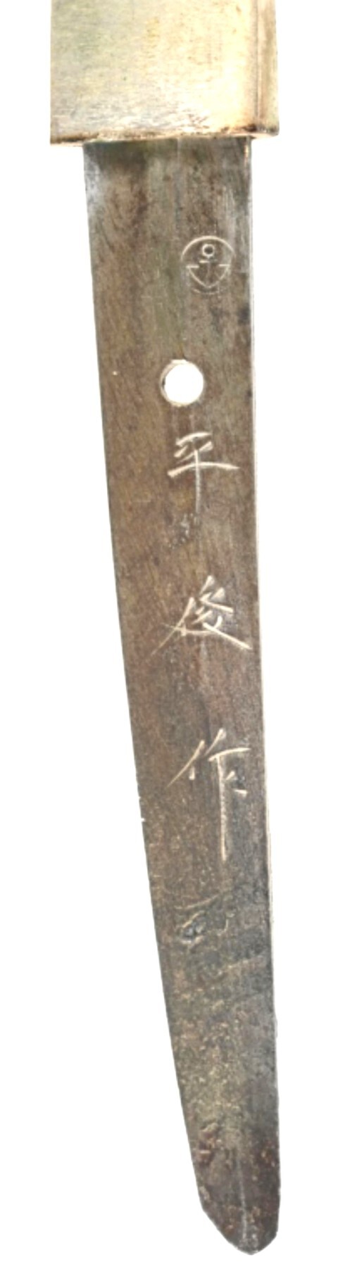

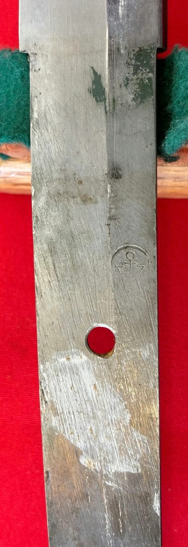

Jcstroud Posted October 31 Report Posted October 31 Is it possible that the different anchor stamps could indicate different sources of production? Such as Takayama,Seki,Tenshozan ? My reasoning is if you notice Masanao,Kanenao,and Toyosuke seem to have the same 8mm stamp in the same location if my memory serves me correctly. PS hey guys been a while hope you are all well. JOHN Quote
Bruce Pennington Posted October 31 Author Report Posted October 31 Nice to see you again, too, John! Your idea is possible. I had the vague theory that the large was from post-war Tenshozan, while the small was from wartime Toyokawa. However, we (and I mean @Kiipu, @BANGBANGSAN, and @mecox) are trying to research the challenging idea that Toyokawa was not involved in making kaigunto at all and the circled anchor was a broad-based Navy stamp used by other/all Naval Arsenals. So, much work to be done on the Navy side of the stamping house. 1 Quote
Jcstroud Posted November 1 Report Posted November 1 Perhaps by grouping swords by stamp size,and also by swordsmiths known locations.In combination with physical traits such as paint color could help pin down location of fabrication.Such as Takayama for example.Well thats my 2 cents worth for now. 1 Quote
Bruce Pennington Posted November 1 Author Report Posted November 1 20 minutes ago, Jcstroud said: Perhaps by grouping swords by stamp size,and also by swordsmiths known locations.In combination with physical traits such as paint color could help pin down location of fabrication.Such as Takayama for example.Well thats my 2 cents worth for now. I'll have a look through my files, John. Been needing a project to chase. I haven't spent much time on the kaigunto. There's just not as many to sample, and they are mostly undated, so data is harder to build. But I'll have a look. 1 1 Quote

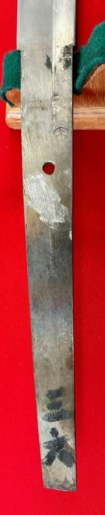

Jcstroud Posted November 8 Report Posted November 8 I am going to go out on a limb on this comment: the souvenir swords with a sheared off flat cut nakago were likely from Takayama forge and were originally longer training swords for Toyama training camp and were made to takayamas specifications then later cut under the direction of Kazuiichi Hattori. 1 Quote
Bruce Pennington Posted November 9 Author Report Posted November 9 Interesting idea, John. Certainly possible! 1 Quote
Jcstroud Posted November 11 Report Posted November 11 Well one thing for sure a hack saw wont do nothing to that metal .that is some tough stuff Quote
