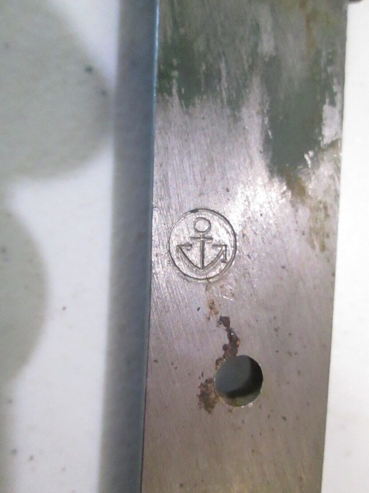

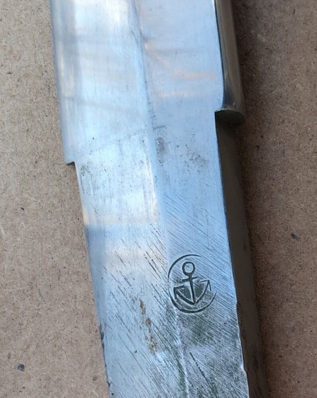

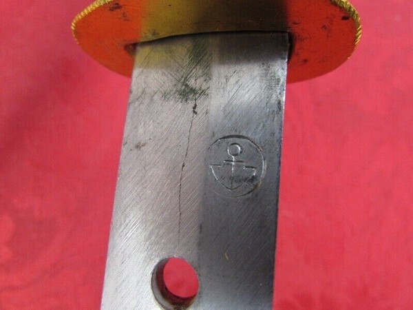

Kiipu Posted December 21, 2023 Report Posted December 21, 2023 Encircled anchor with black painted 95. Nice ww2 late war Japanese Naval sword SOLD Quote

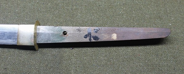

Bruce Pennington Posted December 21, 2023 Author Report Posted December 21, 2023 On 12/21/2023 at 4:07 AM, Kiipu said: painted 95. Expand Interesting to see these making the rounds of dealers. The Crimson mist page was "last modified" 26 October 23, and I have this sword on file from Smallsword at ebay on 19 September 23. Thanks Thomas! From the smallsword sale. Same rust pattern around the ana: From Crimson Mist: 1 Quote

Conway S Posted December 21, 2023 Report Posted December 21, 2023 On 12/21/2023 at 4:07 AM, Kiipu said: Encircled anchor with black painted 95. Nice ww2 late war Japanese Naval sword SOLD Expand The seller wasn't lying when they said they have the smallest of profit margins for this sword! Bought from Smallsword and then sold again in Australia after international shipping and taxes. Conway 1 Quote

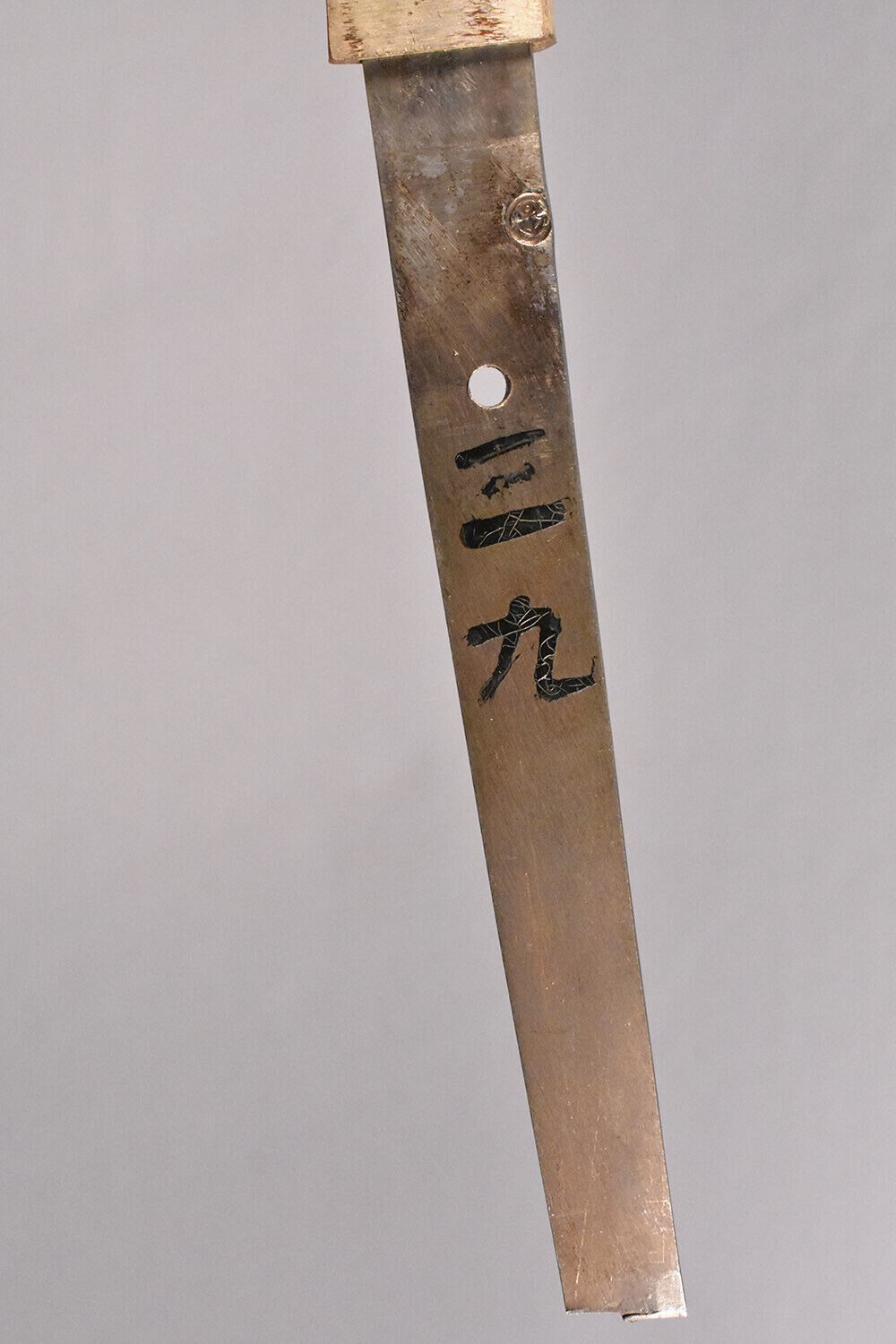

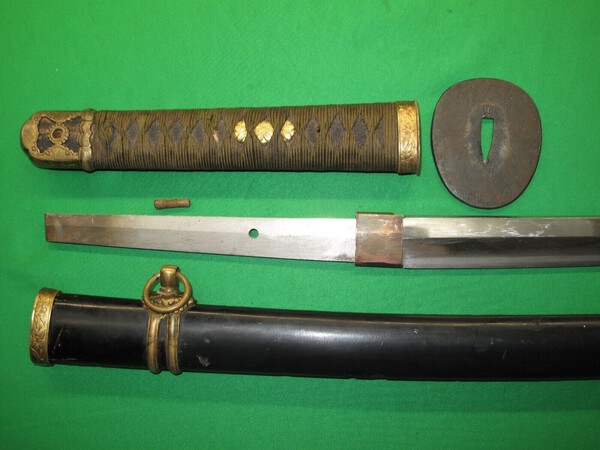

Bruce Pennington Posted December 21, 2023 Author Report Posted December 21, 2023 On 12/21/2023 at 4:06 PM, Kiipu said: FYI, there is another souvenir sword at that website. Expand Thanks Thomas! Painted 43, stamped 353, standard fittings except has a Navy semegane. Here's the link while it lasts: Crimson Mist Military Antiques - SWORDS & POLEARMS Japanese - Nice ww2 Japanese Naval Landing forces sword (s349) (cmmilitaryantiques.com) Quote

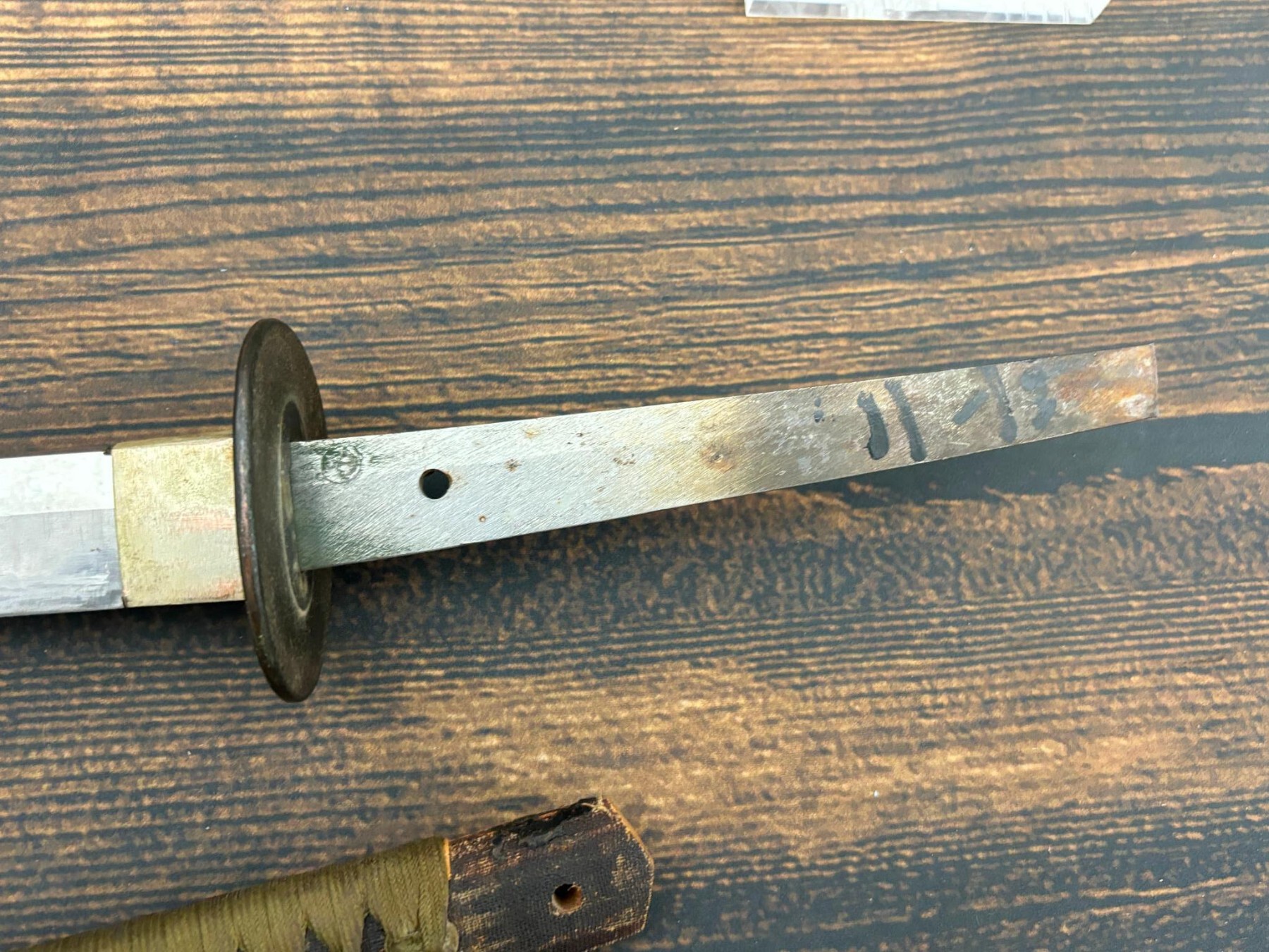

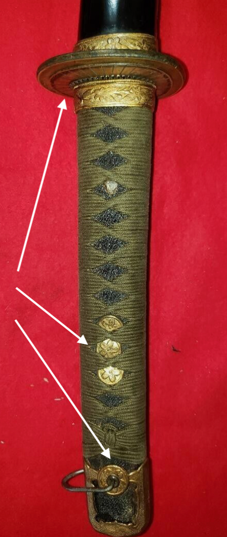

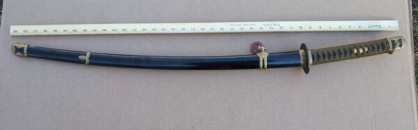

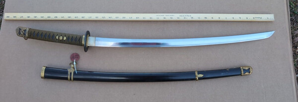

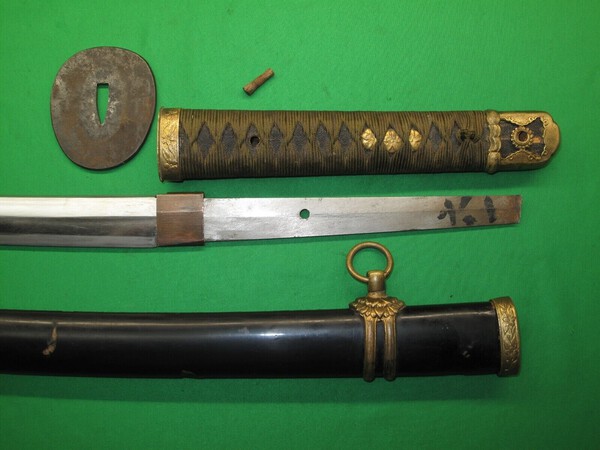

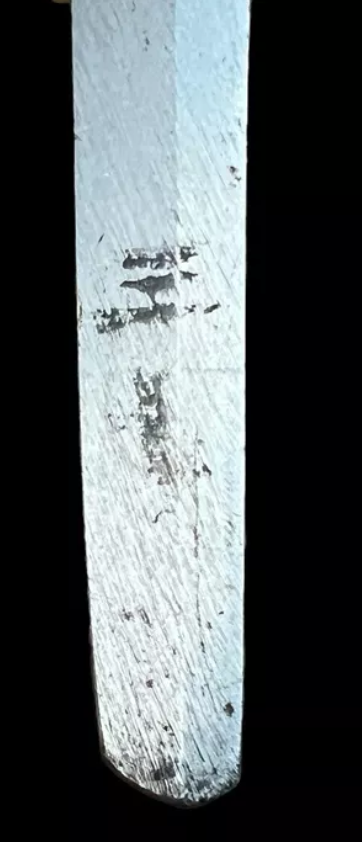

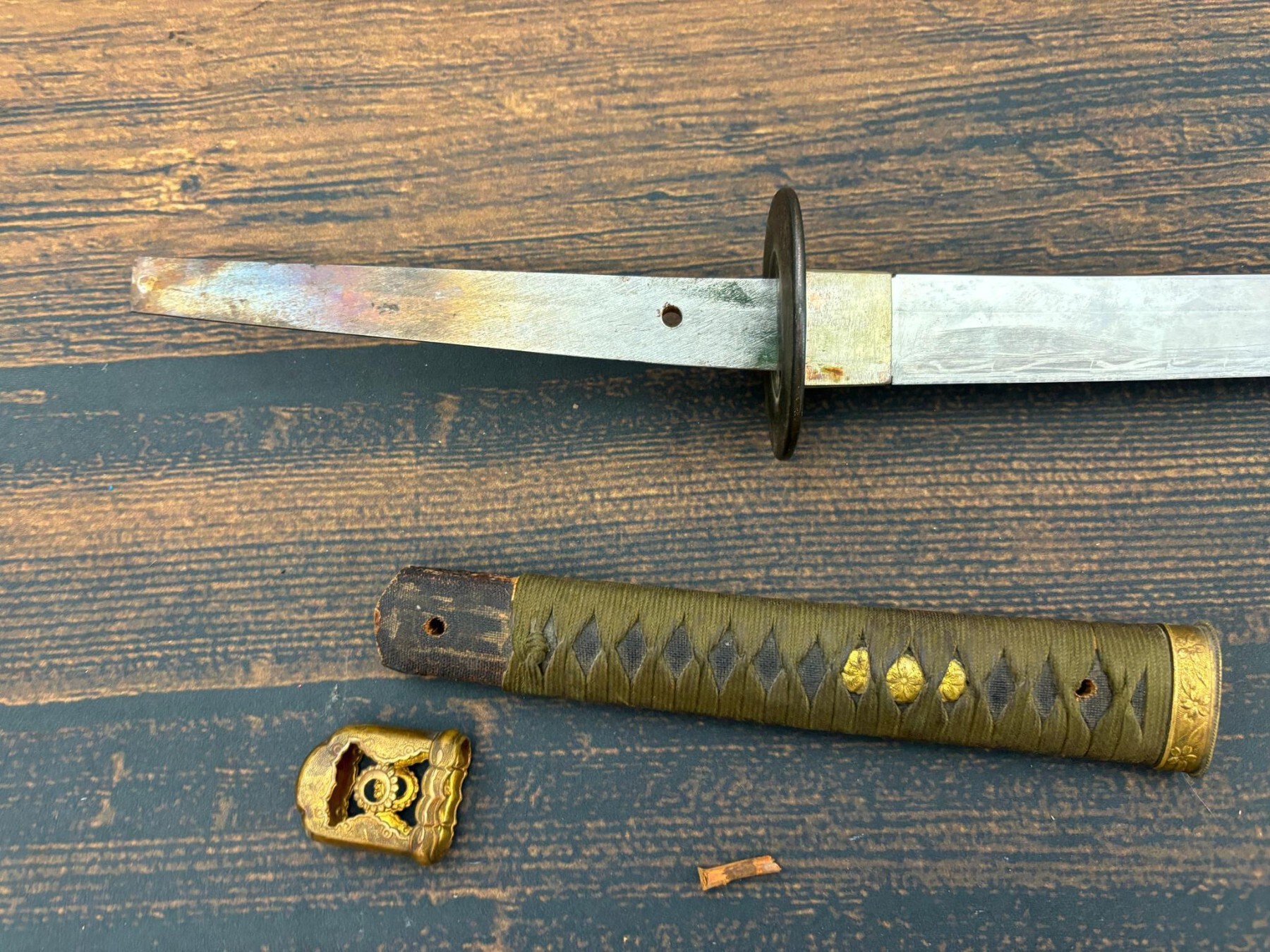

Bruce Pennington Posted January 2, 2024 Author Report Posted January 2, 2024 Here's an odd one. #39, crudely broken off nakago jiri, black "navy" same', in Type 98 fittings, and likely a post war ito wrap. I personally think the whole set of fittings is likey done post war. Matt is selling his HERE. Quote
John C Posted January 2, 2024 Report Posted January 2, 2024 Would the pierced tsuba be type 94 or type 98? From the description: "This is an original Japanese army officer’s sword in Shin Gunto mountings from World War 2." John C. Quote
Bruce Pennington Posted January 3, 2024 Author Report Posted January 3, 2024 Pierced tsuba are found on both models. As to the sellers claim, you just can’t go by that. I’ve seen countless titles for souvenir sales, claiming “immaculate navy kaigunto”, and “World War II army sword with ancestral blade”, when the blade is dated 1943! Quote

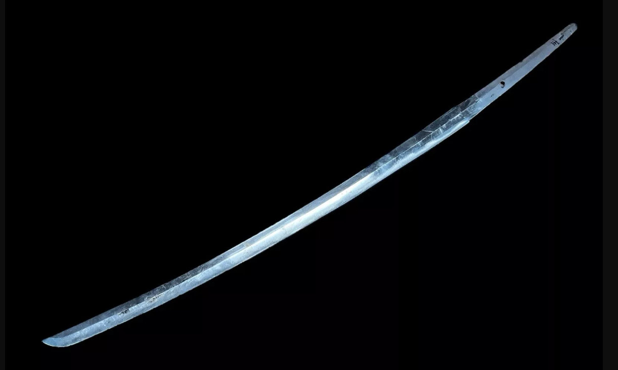

Bruce Pennington Posted July 29, 2024 Author Report Posted July 29, 2024 First "26", found at this Burns Auction. 1 Quote

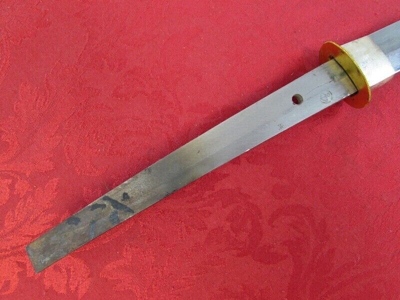

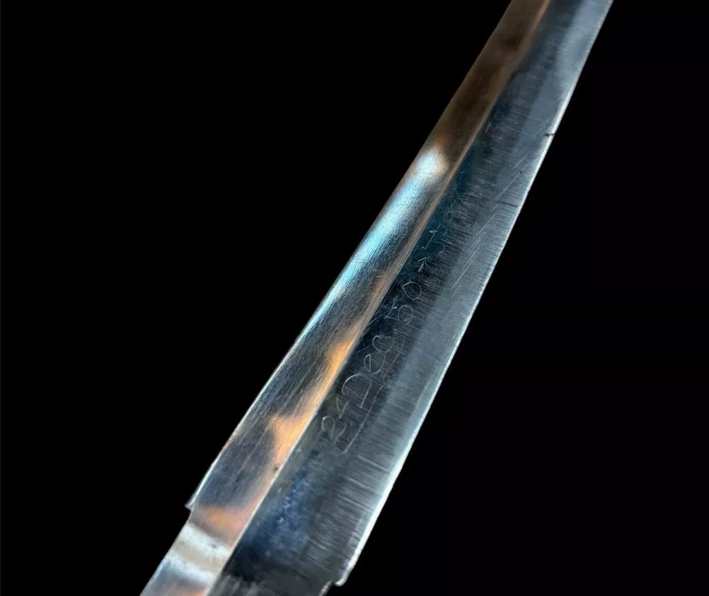

Bruce Pennington Posted September 22, 2024 Author Report Posted September 22, 2024 I'm going to list this one as a souvenir as it has the date scratched on the blade "24 Dec 50", blade only, being sold on this ebay sale. I'm calling the painted number "37" unless someone has a better read on it. 1 Quote
