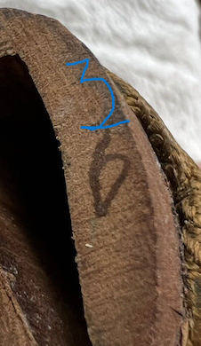

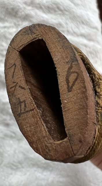

Kiipu Posted December 9, 2023 Report Posted December 9, 2023 On 12/9/2023 at 3:33 AM, Bruce Pennington said: A "6"? Expand It does kinda look like a handwritten six (6) or a really bad zero (0). 1 Quote
Bruce Pennington Posted December 9, 2023 Author Report Posted December 9, 2023 My next dilemma is - a "6" or an upside down "9"!!! The 3 on my tsuka is upside down compared to the kana/number on the other side. Quote

Bruce Pennington Posted December 12, 2023 Author Report Posted December 12, 2023 On 12/9/2023 at 5:36 PM, Kiipu said: It does kinda look like a handwritten six (6) or a really bad zero (0). Expand It could be a "RA" hastily written But after noticing the horizontal line at the very top of the figure, and remembering other Anglo numbers with a horizontal line at the top, I'm thinking more strongly that it is, in fact, a 6. Quote
Kiipu Posted December 12, 2023 Report Posted December 12, 2023 On 12/12/2023 at 11:32 PM, Bruce Pennington said: But after noticing the horizontal line at the very top of the figure, Expand You mean the black staining around the upper right edges? Lets call it a six and call it a day! 1 Quote
Bruce Pennington Posted December 12, 2023 Author Report Posted December 12, 2023 On 12/12/2023 at 11:42 PM, Kiipu said: You mean the black staining around the upper right edges? Lets call it a six and call it a day! Expand Wow, never noticed the rest of that "staining." Now the stain looks like a washed out, or attempted removal, "3" But, Ok, I'll stop now...... Quote

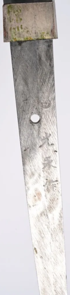

Conway S Posted December 14, 2023 Report Posted December 14, 2023 Found this number 七七 souvenir on eBay. Of note, the tang seems to be painted over covering up what looks like a mei. The first character could be 光. Given the un-cut jiri it could be a Mitsunaga 光永. There have been a few examples posted on this thread. The habaki is also marked with / II / II which is probably shorthand for VII. ORIGINAL WWII WW2 Japanese Navy Officer Gunto Sword - Signed - Nice Conway 1 1 Quote

Kiipu Posted December 15, 2023 Report Posted December 15, 2023 On 12/14/2023 at 11:20 PM, Conway S said: Given the un-cut jiri it could be a Mitsunaga 光永. Expand Can confirm that it is a Mitsunaga as I can see both characters. FYI, this is the first Mitsunaga that has a painted subassembly number on it. Quote
Bruce Pennington Posted December 15, 2023 Author Report Posted December 15, 2023 Well, there is a Mitsunaga with a "25" painted, but it's on the undated other side of the nakago. Do you think I shouldn't list it as such? Quote
Kiipu Posted December 15, 2023 Report Posted December 15, 2023 Normally numbers on that side do not match the other parts. However, never say never. Quote
