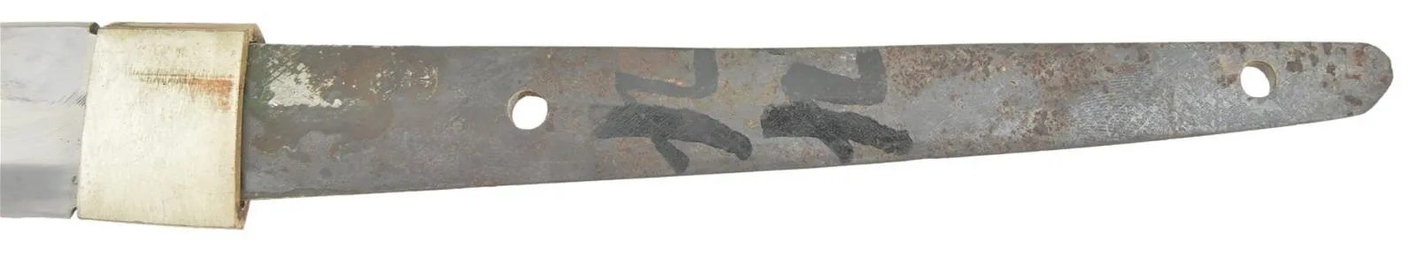

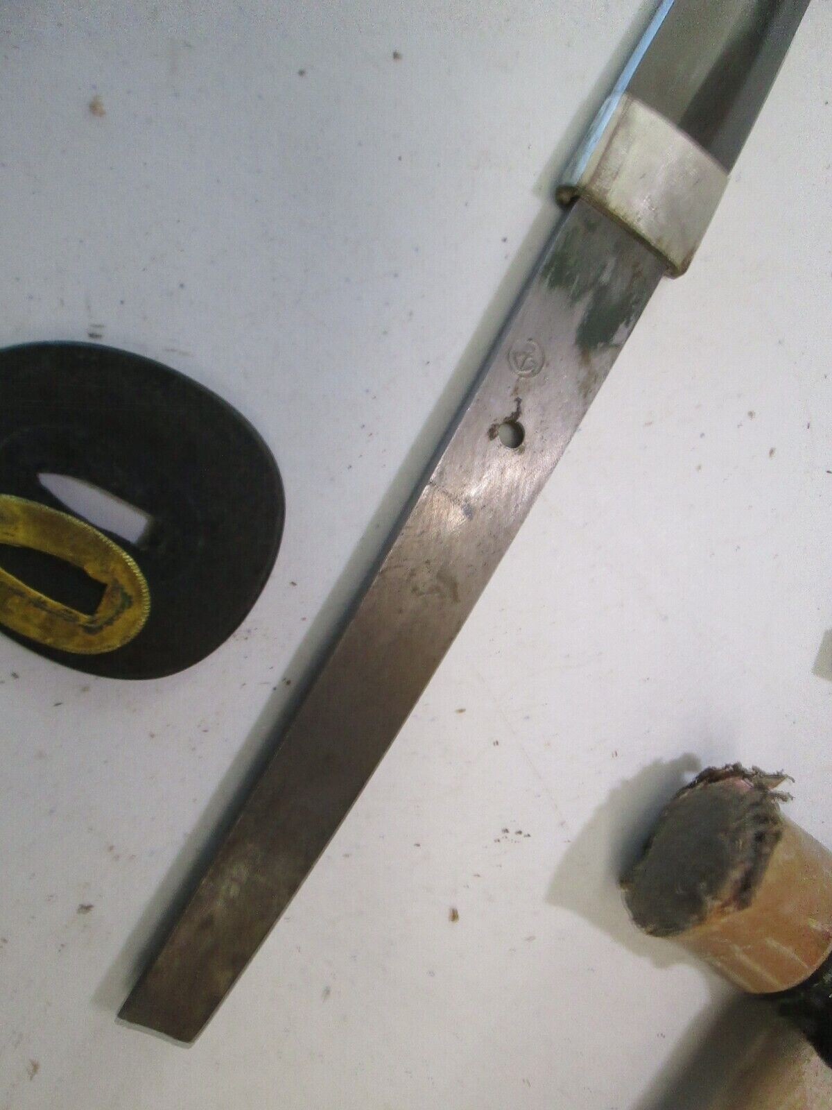

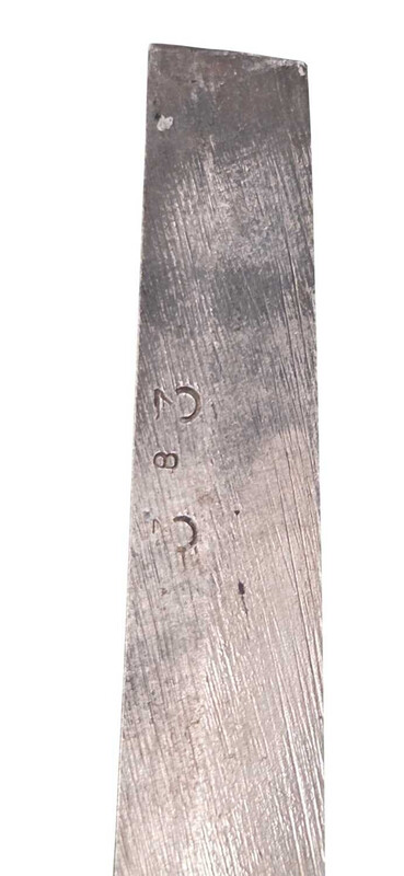

Bruce Pennington Posted September 20, 2023 Author Report Posted September 20, 2023 Opinions please! "75" or "95"? Posted, and mislabeled, by Smallsword on this ebay sale. Quote
Conway S Posted September 20, 2023 Report Posted September 20, 2023 Looks like 95 九五 to me, Bruce. Conway 1 Quote

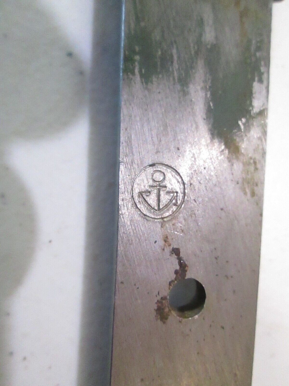

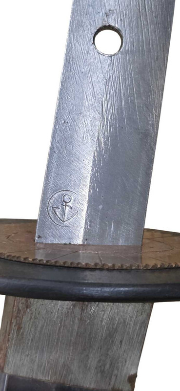

Jcstroud Posted September 20, 2023 Report Posted September 20, 2023 On 9/20/2023 at 1:41 AM, Bruce Pennington said: Opinions please! "75" or "95"? Posted, and mislabeled, by Smallsword on this ebay sale. Expand From what I can see the seppa was quicklly made,the photos blurry,the anchor looks to be a 6mm 90 degree barb ,the stamp location unusual but perfectly applied,mumei,overall condition appears good for what I can see of it,being sold by a coin collector. Not enough there to make me want to buy it. Edit:that stamp measures 8mm !!!!!+- something fishy here..... 1 Quote
Bruce Pennington Posted September 20, 2023 Author Report Posted September 20, 2023 Thanks guys. I'll put it in the chart as "95" then. First numbered blade in the 90s. 1 Quote
Jcstroud Posted September 20, 2023 Report Posted September 20, 2023 On 9/20/2023 at 11:33 AM, Bruce Pennington said: Thanks guys. I'll put it in the chart as "95" then. First numbered blade in the 90s. Expand First time I have seen an 8mm anchor stamp on a maybe souvenir sword!!!!?????looks like I will have to investigate these multiple designs of the circled anchor stamps.....very curious...hmmm Quote

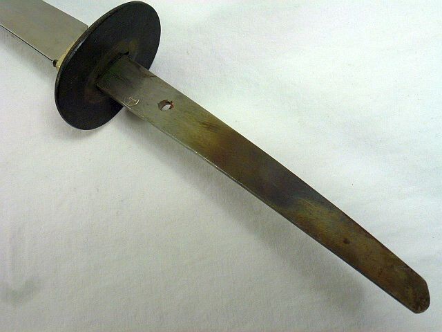

Jcstroud Posted September 20, 2023 Report Posted September 20, 2023 Compare the nakagos of these 2 blades and you can see that the ebay mumei is basically flat not well defined...not to mention the different stamps..... Quote

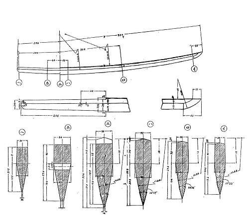

Jcstroud Posted September 20, 2023 Report Posted September 20, 2023 The 1940 Bujin-to ,aka,Rikusin-to "land battle sword specs clearly show specified shapes and dimensions for the Navy "Warrior" swords. Quote
John C Posted September 20, 2023 Report Posted September 20, 2023 On 9/20/2023 at 11:33 AM, Bruce Pennington said: I'll put it in the chart as "95" then Expand Looks a bit like a 6 to me but could easily be a 9. John C. 1 Quote
Jcstroud Posted September 20, 2023 Report Posted September 20, 2023 Looks like we might have add extra large to stamp column in the souvenir chart for #95 first 8mm circled anchor stamp I have seen on a toyokawa blade why so many diferent ones I wonder anyone else? Quote
Bruce Pennington Posted September 21, 2023 Author Report Posted September 21, 2023 On 9/20/2023 at 8:26 PM, Jcstroud said: why so many diferent ones I wonder Expand I was hoping to detect a pattern of use with the different size stamps. My first suspicion was the small step would be found on blades made during the war, and the large stamp on Blades after the war. But it hasn’t worked out that way. I find both sizes on blades before and after the war. I personally suspect there were multiple inspectors and each one might have had his own stamp, that varied in size from each other. Quote
Jcstroud Posted September 21, 2023 Report Posted September 21, 2023 On 9/21/2023 at 3:52 AM, Bruce Pennington said: find both sizes on blades before and after the war. I personally suspect there were multiple inspectors and each one might have had his own stamp, that varied in size from each other. Expand I have read that there were 4,6,8,10 and 12 mm Authorized stamp sizes. Ihave also read that many forges had their own resident inspectors,such as Tenshozan Tanrenjo in Zushi,and Zenhiro Hattori's forge in Mishima city.I believe that Takayama forge had one as wellthe reason being is that Ihave noticed a pattern that Masahiro,Masanao,and Toyosuke have the same 4mm fishhook barbed circled anchor stamp in common with few exceptions....not to mention other commonalities. 1 Quote

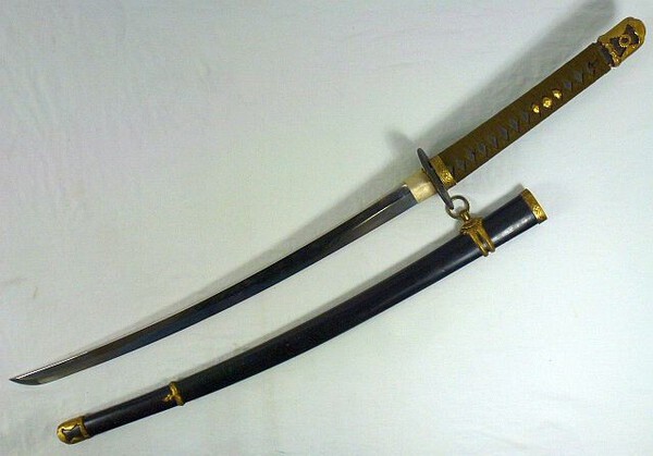

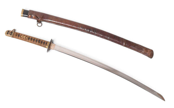

Bruce Pennington Posted September 22, 2023 Author Report Posted September 22, 2023 Duplicate "55" for sale at Horst Auctioneers: Quote

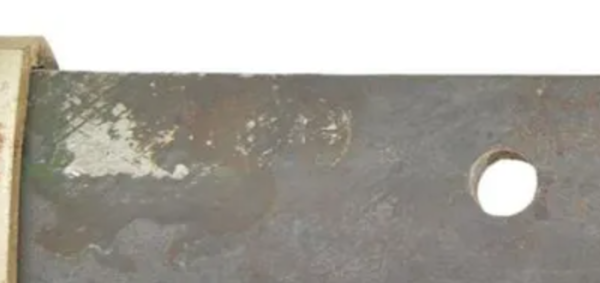

Conway S Posted October 3, 2023 Report Posted October 3, 2023 Found this sword in souvenir fittings #99. Note the two mekugi-ana. It is hard to tell if the anchor stamp is visible in this picture or if it is under the habaki. It may be below the white paint smudge. https://www.liveauct...ese-shin-gunto-sword Conway Quote

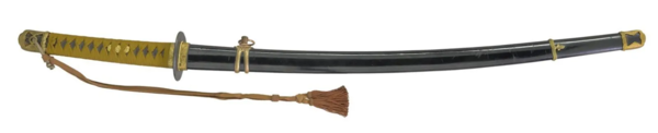

Conway S Posted October 3, 2023 Report Posted October 3, 2023 Here's another #12 or possibly #3 with what is likely a replacement tsuba. I am unable to upload the pictures due to their original formatting. https://www.liveauct...se-ww-ii-naval-sword Conway Quote
Bruce Pennington Posted October 3, 2023 Author Report Posted October 3, 2023 On 10/3/2023 at 12:11 PM, Conway S said: souvenir fittings #99. Expand Great find, Conway! Our first #99! At first, I thought this might also be a regular steel blade, but you can see the stainless with cross-hatching in a couple spots. Seems to be overlaid with some sort of corrosion. It does have the large anchor, between the exposed original survace (not white paint) and the ana. Quote
Jcstroud Posted October 3, 2023 Report Posted October 3, 2023 Looks like each one has been modified in one way or another 99 has angle cut habaki with an offset Munemachi ,#3 the tsuba has been replaced... oh no I am becoming a critic ahhhhhh.!@#$?😁 1 Quote
Jcstroud Posted October 3, 2023 Report Posted October 3, 2023 On 10/3/2023 at 12:35 PM, Bruce Pennington said: Seems to be overlaid with some sort of corrosion. Expand Looks like bondo,Nice tassle Quote
Bruce Pennington Posted October 3, 2023 Author Report Posted October 3, 2023 On 10/3/2023 at 12:19 PM, Conway S said: #12 or possibly #3 Expand Let's go with "3", unless one of our translator experts has a better idea. It's odd that the first stroke is slightly separated from the next 2, but "12" obvious, should be "+=". Wish they had shown the disassembled fittings. Likely would have had stamped numbers. On the tsuba, I'm not bothered by it. We have seen a mix of parts in these souvenirs. Some with all-Navy tuska instead of Army fittings, even. Quote
Bruce Pennington Posted October 3, 2023 Author Report Posted October 3, 2023 Posting pics before the auction goes dead: Quote

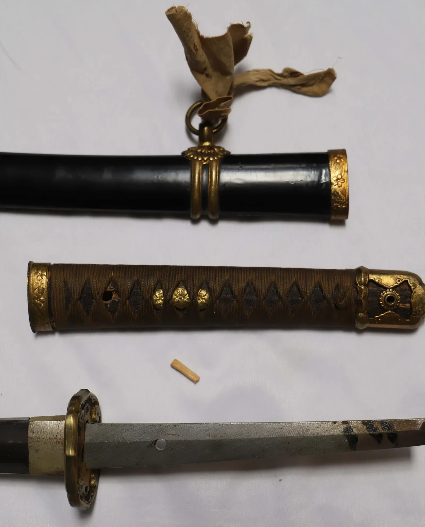

Bruce Pennington Posted October 5, 2023 Author Report Posted October 5, 2023 Here's a late-war kaigunto (1 haikan) with a Takeyasu blades, painted number "430". I think he must have been working Tenshozan late in the war. This 3-digit number aligns with the idea, then he worked for Tenshozan making souvenirs, or at least there were surplus blades from him used for souvenirs. Opinions Deciphering Kanji - Wehrmacht-awards Quote
Jcstroud Posted October 5, 2023 Report Posted October 5, 2023 This one seems to blur the line between latewar and postwar also appears longer at the tsuka having 12 diamond as opposed to11 on others suppose this blade could be from Takayama forge? Of Seki origin?tsuka is curved slightly as well.what you guys think? Quote

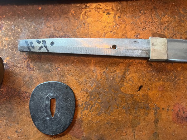

Bruce Pennington Posted October 7, 2023 Author Report Posted October 7, 2023 Came across this one posted by @Tomclutts HERE We had discussed it last year, but haven't logged it into the survey yet. I'm calling it #62 as the tsuba is stamped 62 as well, but it's got a 32 on the other side. Quote

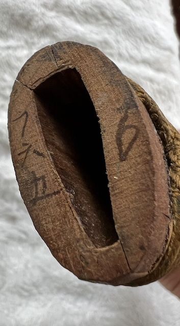

Kiipu Posted October 7, 2023 Report Posted October 7, 2023 On 8/17/2023 at 3:59 PM, Conway S said: Expand This could be the only indicator of the sequence in which the souvenir swords were made. In this particular case, it is the katakana character FU フ. It is just an idea but worthy of comment nonetheless. フ六五 = FU-65. 1 Quote
jeep44 Posted October 7, 2023 Report Posted October 7, 2023 On 8/25/2023 at 4:25 PM, Kiipu said: Douglas, I note that your sword has two subassembly numbers on it. One on each side of the tang. My question is which of the two numbers do the parts match to, 7 or 64? Expand It's put away right now-it might be a week or so before I access my swords again, but I'll check 1 Quote
