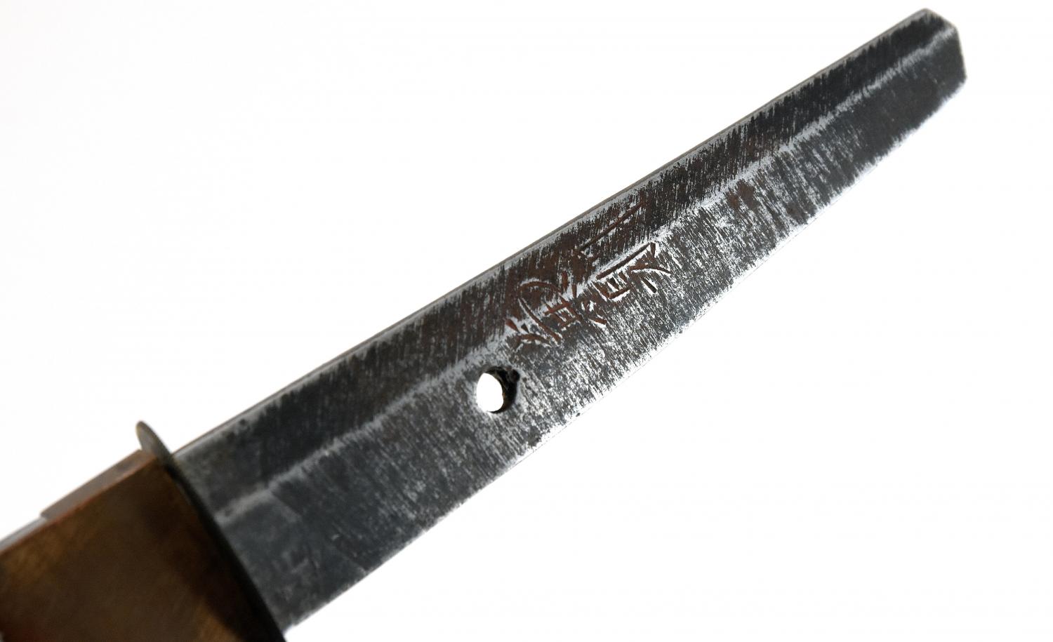

Kung Karl Posted April 27, 2017 Report Posted April 27, 2017 Hi!My name is Stefan Nybergh, from Stockholm Sweden. I´m new to the forum, and to collecting Japanese sword, allthough I´ve had a life long interest in Nihonto and in Japanese martial arts. I would very much appreciate some input about my recently purchased Katana, All I know is that it is supposed be from Koto Shinto period 16-17th century, Can this be correct? The blade is 63 cm (24,8 inches) The blade is signed. Can someone see by which smith from the pic´s attached? (I can tru to make better ones) Any info about anything would be great. Regards to You all! Stefan Quote

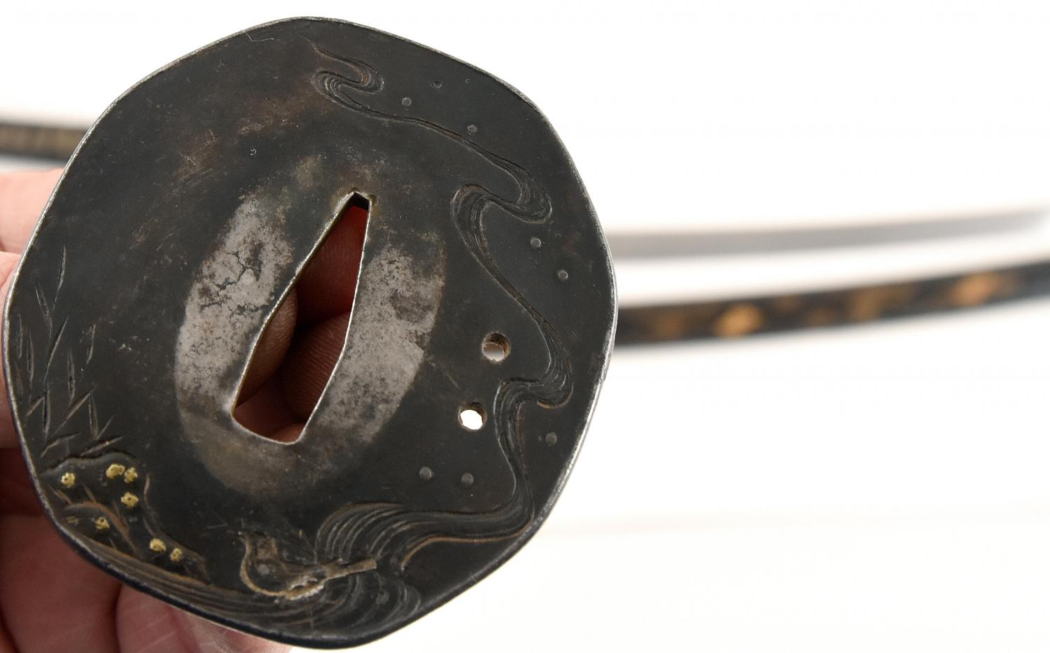

Geraint Posted April 27, 2017 Report Posted April 27, 2017 Dear Stefan. Welcome! We could really do with better pictures if you can. The sword appears to be signed Kanenori, very hard to pin down which one of the many this could be. The tsuka looks to be a bit scruffy and the tsuba is missing one or two elements but could be nice. Koto/Shinto doesn't help much as it covers almost all of sword history, perhaps the seller meant to suggest that it was made around 1600 at the end of the Koto period and beginning of Shinto. Personally I would say Shinto I would look carefully at the kissaki, hard to tell from your photograph but the shape looks odd. Hope that helps. All the best. Quote

raaay Posted April 28, 2017 Report Posted April 28, 2017 Hi Stefan I think Geraint has correctly identified the smith and I would also agree with a Shinto period blade. I think I see hawk feather file marks on the tang ! which would be a good indicator as per the signature for a Mino-Den blade Quote

Bazza Posted April 28, 2017 Report Posted April 28, 2017 On 4/28/2017 at 7:57 AM, raaay said: Hi Stefan I think Geraint has correctly identified the smith and I would also agree with a Shinto period blade. I think I see hawk feather file marks on the tang ! which would be a good indicator as per the signature for a Mino-Den blade I think the filemarks are a variant of taka-no-ha known as shinogi sujikai/hira kiri See: http://meiboku.info/guide/form/yasurime/index.htm BaZZa. Quote
Kung Karl Posted April 28, 2017 Author Report Posted April 28, 2017 Thanks Bazza! What can this tell us about the balde? Quote
Kung Karl Posted May 5, 2017 Author Report Posted May 5, 2017 So, the blade is made by a smith called Kanenori, Mino-Den, early (?) Shinto. Is it possible to say something more? Quote
