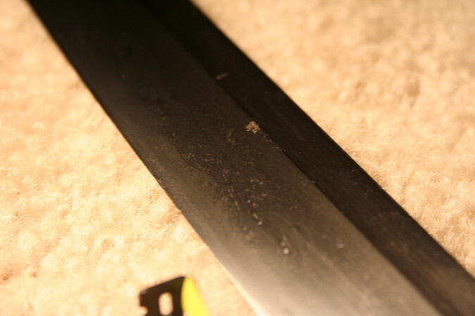

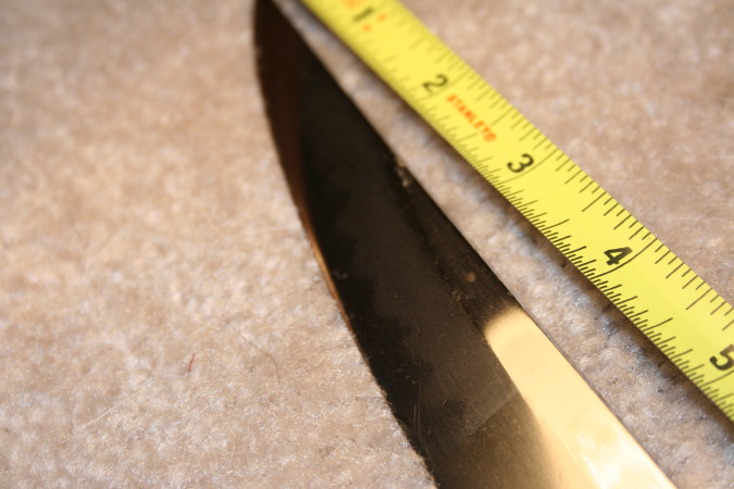

Help identifying school and value...30" nagasa, 4" kissaki!
Bought this one at a gun show from a military antiques dealer...got a good deal, but the question is "how good?"
Any help placing the school and value range would be much appreciated. I don't know much about it, but the dimensions are impressive, and it would be gorgeous in full polish.
Nagasa: 30.0in
Sori: 2.3cm
Motokasane: 8mm
Sakikasane: 5mm
Motohaba: 3.3cm
Sakihaba: 2.8cm
Kissaki: 11.4cm

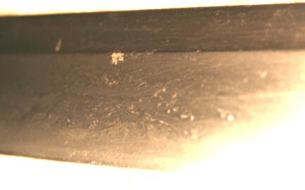

Looks like a really nice sword. I love the O-kissaki, and i can see nie, and what might be kinsuji in your photos. It looks as if this sword would show some nice activity upon close inspection, and if it were mine i would probably put myself on someone's list to get it into full polish.
I have not studied enough hands on to even take a guess at time period on this. Well i could guess, but it would be just that, a guess.

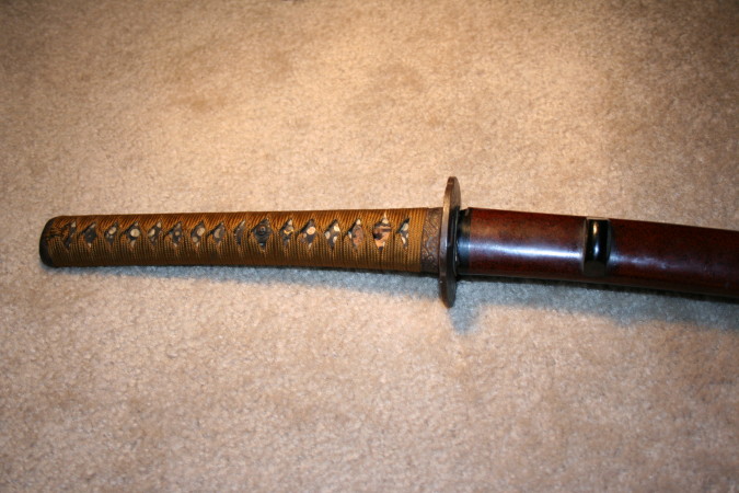

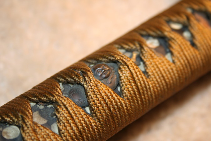

I'm still guessing at what is under the tsuka-ito. It looks to be lacquer with something in it...but I don't know what. All of the little "inserts" are roughly circular, and an off-white. I haven't seen one like this before, but then again I'm not widely traveled. ;)

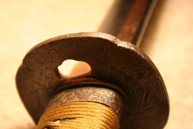

maybe some more pix Tsuba F/K and some of the mystery skin under the wrap, blade construction looks fine to me he's leaning toward shinshinto I'm gendaito looks like that from the hamon pix. Civilian mounts? Very interesting what one does and does not see.
F/K & Tsuba pics. The photo of the menuki I already posted shows pretty much everything there is to see about the material under the ito.
The tsuba doesn't give the impression of being very old, but the F/K and menuki look like they are. Interestingly, the saya has about a 4in "boot" where the toe of a leather combat cover is attached. Don't know why the rest of the cover was removed and this was left, but it's there. Seems to pretty conclusively show that the blade was carried during the war, whichi seems odd considering its size. Must have been a pretty tall guy!

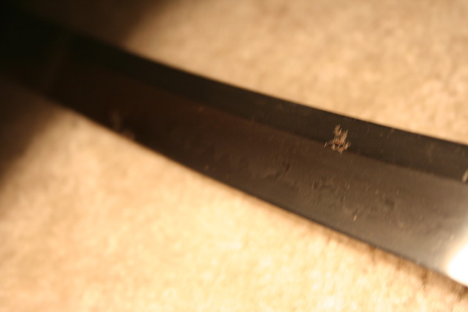

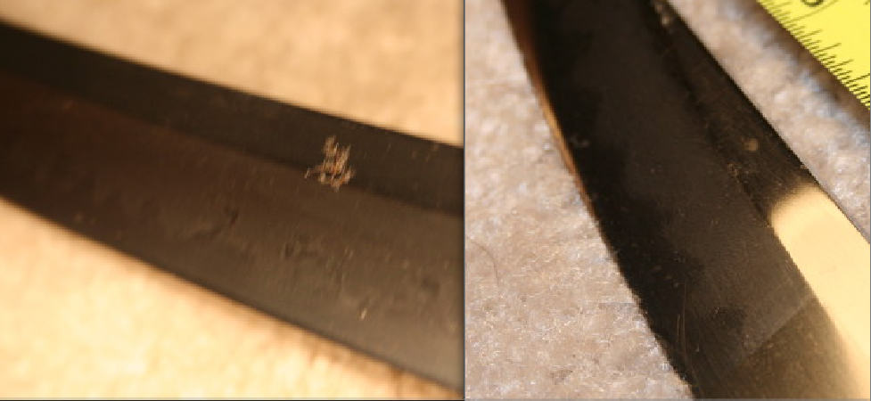

hey, first impression of the steel is that this is not true forged steel, based on jigane. It has that bar steel appearance, smooth but not muji, dark-lifeless. It could be the polish, granted. Second, look at the lines forming the kissaki, something is just not right. A poor polish, again, maybe. Thirdly, the hamon, of what can be seen, is too shadowy, no nioi, nor visible nie, lacks control, too random. Fourth, the nakago simply looks like it is trying to be something its not, rust, file marks, shape, just doesn't look right, natural. The wrap on the tsuka is highly suspect, those menuki simply look fake.
Normally, when you first look at a sword it gives an immediate first impression, this is a "??? tradition sword", from "??? time period", etc., and this sword doesn't seem to do that. Kantei is the critical component when considering any sword.

not sure why you cant see any actvity ...so i cropped and lighted it up...looks like nice work to me. May have to do the same to the fittings pix are dark

The darkness of the steel and hamon is an effect of my photography. Tons of nie and readily apparent hada with the blade in hand. The condition of the polish is not so good...someone used something coarse to remove some areas of "spider rust" on the blade. Lots of uchiko later, the activities are becoming visible, but the sword really needs a fresh polish. The tsuka-ito is old, just clean. As for the nakago, it is well shaped, and the nakago-jiri is carefully finished. There is red rust on top of an older, darker patina. I think the sword was exposed to excessive humidity at one point, which would explain the fresh rust on the nakago and the rusted areas on the blade.
The menuki look fine, but I'm no expert.

the showa era.The smith, it seems to me was not entirely successful . The kissaki
tapers too narrowly out to the point in comparison to classic blades with o-kissaki.

That tsuba is definitely showa. I had one very much like it on a katana marketed by
one of the sword companies of the era. The rest of the fittings probably are, too.
It looks like the tsuka has a same substitute. That might imply a late-war vintage
when shortages made real same rather scarce.

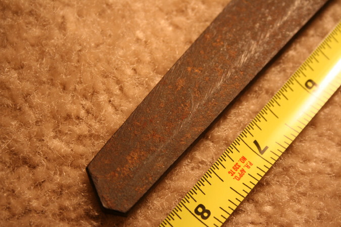

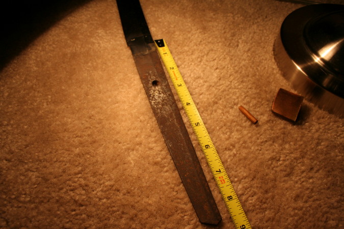

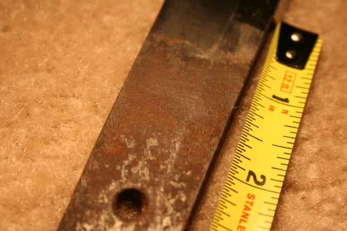

One mekugi-ana (in the right place for an ubu-nakago,BTW), Iri-yama-gata jiri, hardly any patina on the "former" shinogi-line on the nakago, flaky rust falling off in pieces. A stiff, awkward and uninspired gunome pattern. What other hints do you need? Even poor for a ShinShinTo or a GendaiTo this could be accepted with a flawless and signed nakago but instead it is just a pretender.

I don't see a boring uninspired gunome there, I see quite a wild hamon with maybe even some tobiyaki, and a polish that is not showing off anything that is there. I also see indications of plenty of hataraki and hada. To me, shinshin-to and would be very nice in polish. But as I said, there are not enough pics and the polish isn't good enough to make out any of this for sure.
With a 30" nagasa and that kissaki, I would be surprised if it turned out to be simply a gendai-to made for the war effort. Not impossible of course, but wouldn't be typical. Nakago patina is never certain..as removal of a tight tsuka can wear the high points..and climate can advance surface rust. So can artificial methods. If it was bought at a gunshow and not a sword show, I would expect it to have been with the guy for many years as a WW2 bring-back, with less chance of faking. But you never know nowdays.

Telling from the shape of the blade it is not older than ShinShinTo. This can be told, among many other features, by the very narrow shinogi-ji and the flat niku. The nakago does not look like o-suriage but ubu (in the meaning of not being shortened; it was altered nevertheless). In fact, it has many features of swords made during the very end of the Bakumatsu or slightly later. Any smith working during the last 150 years or so would have signed his work. It just doesn't make sense to forge a sword and then leave it unsigned; and naturally grown patina does not fall off like that, revealing clean steel.
As for the hataraki: They do not proove quality by their sheer existence. Their quality and the control over them CAN make hataraki a quality-feature, but western eyes are easily detracted from real quality by spectacular effects visible at first sight. This goes for many other features of Nihon-To.

Even considering the poor state of polish, the gunome-outline IS stiff and awkward (despite of hataraki) and points towards a later date of manufacture. Unfortunately the nakago pretends to be something else.

Also, as I've already stated, (more than once, I believe) the red rust in the pictures is on top of a darker, smoother patina. It doesn't "flake off to reveal clean steel." Again, wouldn't one expect to see "fresh" rust on the nakago of a sword exposed to a humid environment (attic, maybe...) for some period over the last 60 years? The blade, after all, has minor damage from rust as well.

"Again, wouldn't one expect to see "fresh" rust on the nakago of a sword exposed to a humid environment (attic, maybe...)"
No. I've seen swords lying neglected for a longer time and their nakago look better and more authentic than this one.

What makes you believe the nakago was altered at all? I can't see any evidence of re-shaping or a signature being removed. With one mekugi-ana, I don't think it has been shortened, as that would put the original length of the nakago at over 8.5" ...
