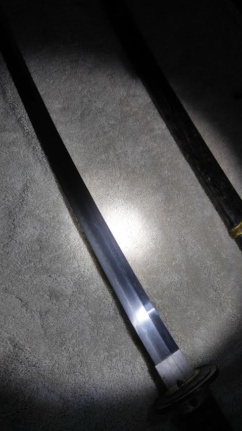

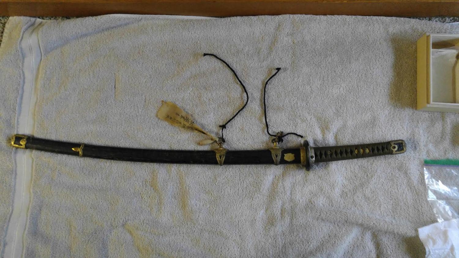

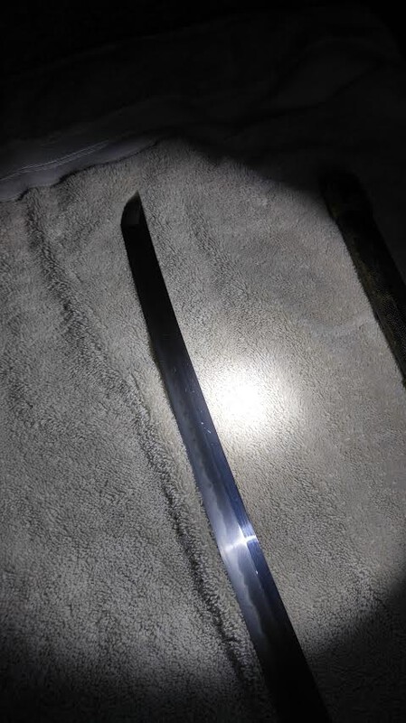

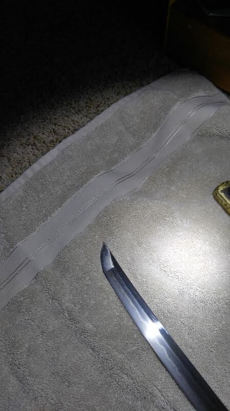

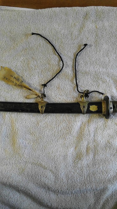

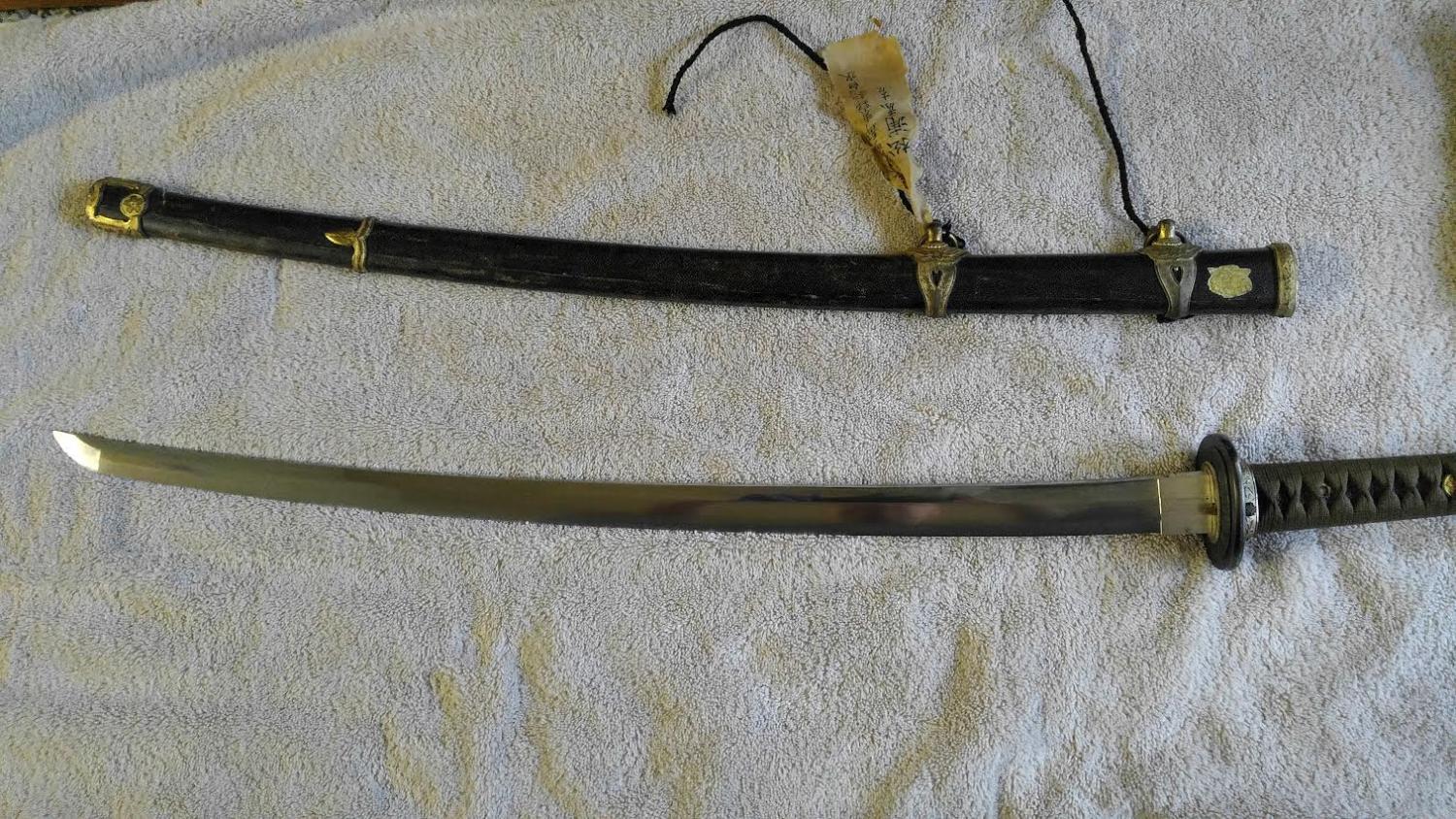

Hello all.  I will be posting the capture tag on this sword in the translation section of the board soon.  But I wanted to share my sword I purchased at a estate sale which got me into learning everything I can about Japanese swords and the makers behind them.   :glee:
I do have one question for everyone . . . Is it possible that this sword is older than WWII era because I cannot find any detail on the smiths sir name for this sword?  OR . . . Is it more likely this smith is just lost because many swords that were from this era were destroyed?  I do have to admit that I have not really looked up "Kawamura" (smith maker) history through the years if there is any.

His name is Tadatsuna. Kawamura Tadatsuna, but the latter is his name. I'm pretty sure this is a wartime sword..not older.
It helps if you post all the pics in one thread, so that people don't have to go hunting through other threads to be able to answer a question. In this case, people can't answer your question without checking if your posted translation is correct, and that means searching for other threads. That's all that Stephen was pointing out.
Yes, wartime smith, probably Showato and there are still quite a few undocumented smiths from the war.
Even though it is wartime it's still of interest. Alot of Kai Gunto are regarded as Showato due to them being made with various stainless steel elements for increased resistance against corrosion.
I didn't see any arsenal stamps on the tang so you may have gotten lucky with a Gendaito, but I wouldn't keep all my fingers and toes crossed.

Great find!  Both the blade and the fittings are gorgeous.  I couldn't find any references to this swordsmith either, but like stated above, there were hundreds of smiths working during the war.

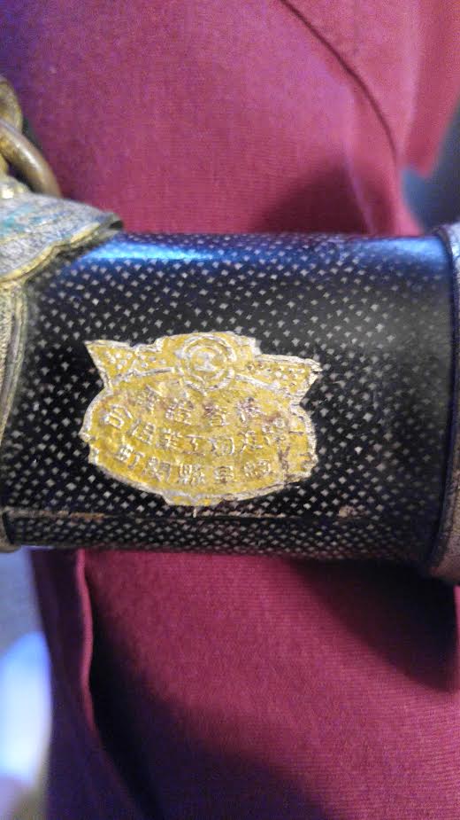

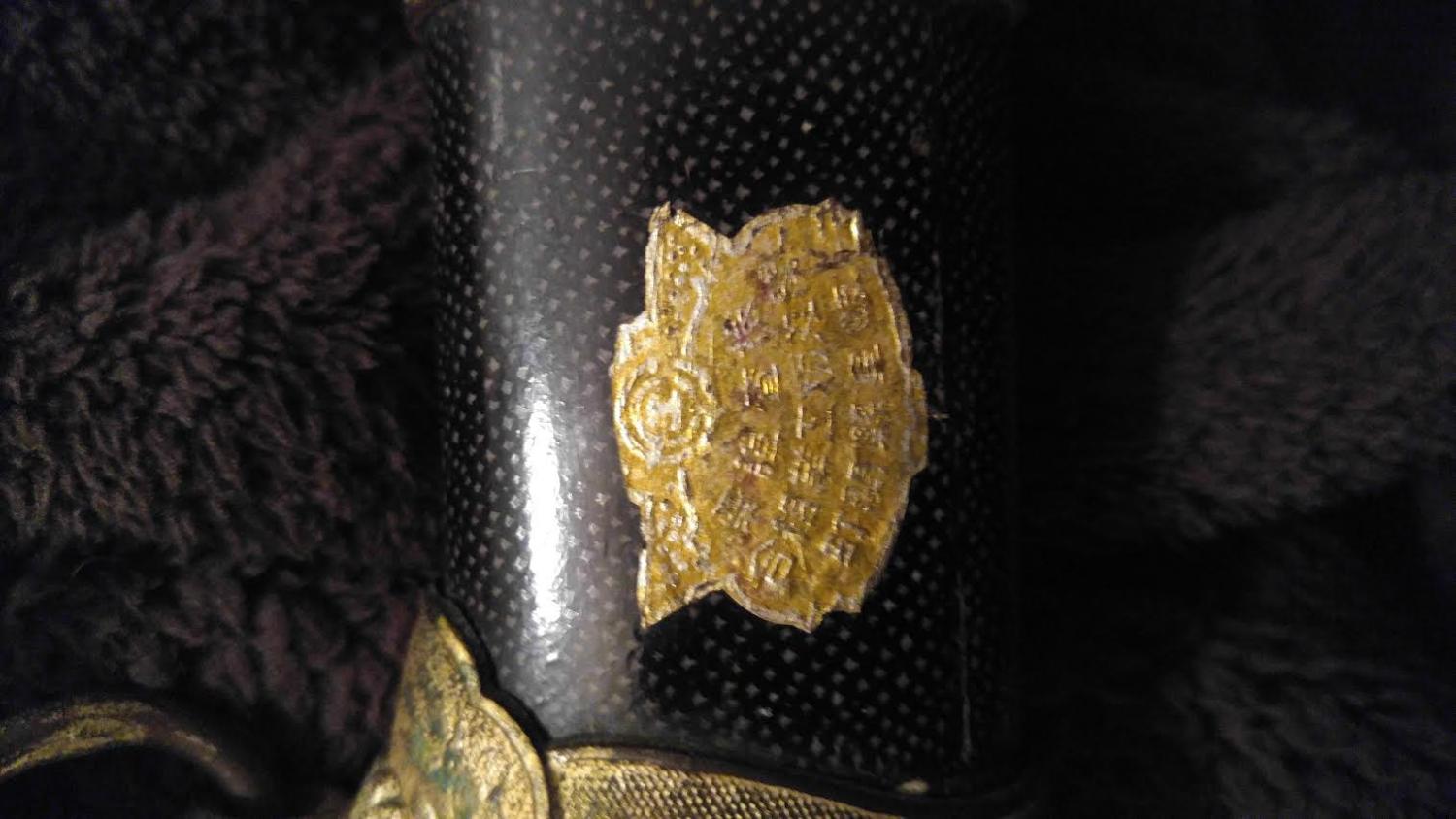

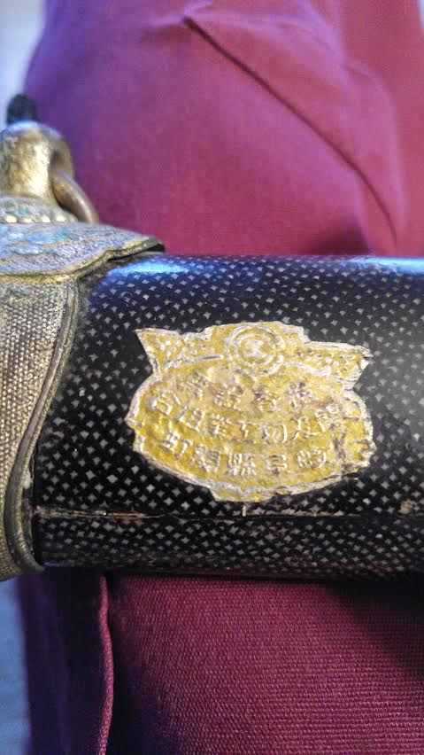

I would also like to see a close-up of that gold label sticker.  I've seen a forum discussion of scabbards with stickers like this and they were all from the Seki area.

Malcolm and Bruce - WOW, this sticker will show where it was purchased??  Or at lease where the Koshirae was purchased?  I am amazed that his sticker has stayed on all this time.  I will post close up pics of this.  After looking into all the material given for me to check out . . . It looks like Seki area.

Yup - Seki emblem at the top.  Interesting that the rest of the sticker is in Japanese.  I think the ones on the earlier thread were in English???  I'll check.  It only means that is where the fittings were made.  The gunto could have been bought at an officers' club somewhere else, though.

doesnt ither F/G or Dawson have a page or paragraph on the two know stickers one round other like one shown badge like?

Sharp as a tack!!!  Yes, F&G, called it "rare".
Bruce  -  You are right.  To bad we cannot all get together a talk swords in person.  Would be fun.  But at least we got the internet.   ;-)   I was wondering if there is a way to compare these stickers to get a date on when they were used?  Also, have you seen this sticker on a Kai Gunto before?  Just curious? Thanks for you time.
Neil  -  Great Find man!  Until this post I had no clue what this sticker was about.  Amazing what one can learn on this board.

Check out the circular logo for Seki Hyaku Tan Sha Token Sei Saku Jo on the link I posted, it looks like you have a kind of circular logo at the top of your label.
Can't make out from your pictures if it has the kanji in the center of the circle.
If it's like an H on its side, it might be a later War all Japanese Kanji version of this:
http://www.militaria.co.za/nmb/topic/6016-paper-label/
Which Puts it to Seki Cutlery Manufacturers' Association Gifu Ken as Bruce said earlier
