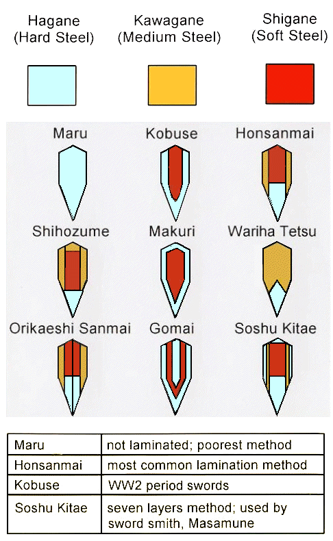

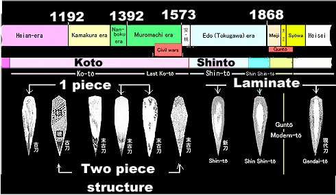

 At late as this point , I can only say "No" that is not true.
Far as  I do remember, many of the Heian Blades are Maru...
Kobuse only on WWII blades....
Not according to my studies,.
This author's opinion on the state-of-the-art of Japanese smithing in Jokoto are far to be supported by academic studies and plainly wrong (Ohmura strikes again...)
