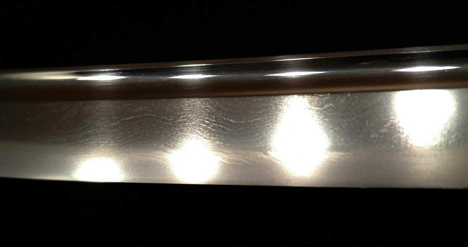

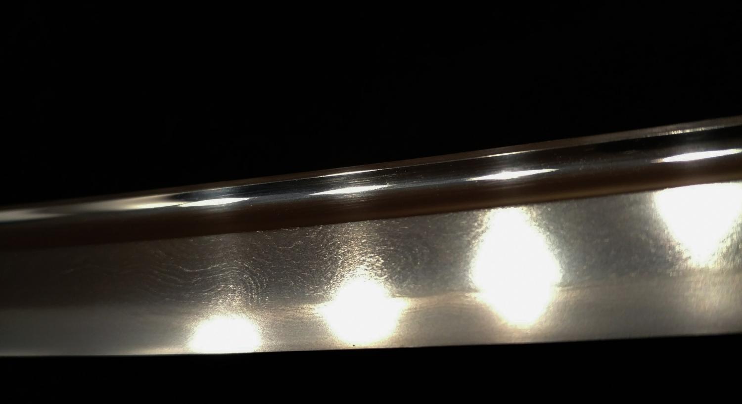

I thought this sword would be of interest and would enjoy hearing others thoughts on it. The sword is one I found in essentially zero polish at the 2014 Tampa show. At the time, the majority of the blade was covered in black rust, except for a clear area under and just above the habaki (maybe 3cm total). From what I could, see there was a feeling of ayasugi, not a very regular one that would point to Gassan, and I made a guess of Ko-Naminohira. I was at the show with a friend and asked him if he wanted the first shot, which he jumped on. After polish, there was a feeling like Norishige in places, not a textbook matsukawa-hada but a workstyle that showed some relationship. My guess at that point was something between Tametsugu and a very high quality Ko-Uda. The sword received a kanteisho at the 2016 Tampa shinsa to Nambokucho jidai - Uda Kunifusa, who is considered to be a student of Norishige and falls into the Etchu middle period along with Tametsugu. That said, the sword has not gone to the NBTHK yet or been in Tanobe-sensei's hands, so I wanted to open up for the groups thoughts. I will take better photos if possible this week, but I think the attached gives a good idea of the work in this sword.

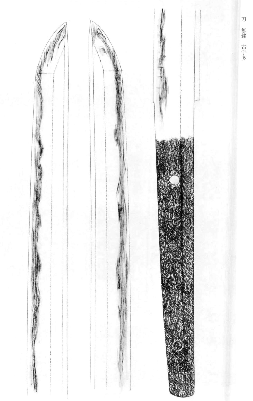

Here is an oshigata from the Zufu which has similarity to this sword and gives an idea of how the hamon appears.

The hada has tons of character, but I don't see any chikei to speak of in the photos. Of course that could be due to the photos or my inexperience. The nioi-guchi also looks quite clear to me, which pulls this further away from Norishige. This is super interesting though, and I'd love to know the results of shinsa when the time comes. Either way it seems your courage will be rewarded!

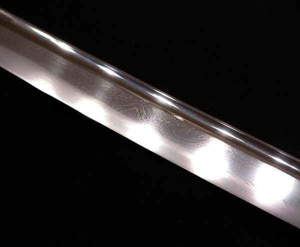

That's more due to my very poor, mobile phone photography. The habuchi is very bright (not at all shimiru), but is also distinct and does not have the vague transition zone seen in Norishige's Ko-Hoki style work. Here is shot which shows the bands of chikei flowing through the ji.

I would say that Ko-Uda can also meet that description. The work of shodai Uda Kunifusa has a hamon like this, in a generally suguha tone. I will share some reference examples. I would also say that this type of hamon (only the hamon) reminds me somewhat of Yamato Shizu.
Similar to the oshigata attached, the hamon has deep nie, but not depth to the ha like you would expect to see in Norishige.
