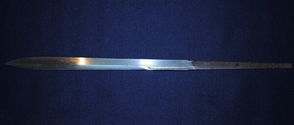

Diamyou54eb has one on eBay, but with odd papers and claim is marumachi but it has the Shinto masame in the shinogi ji, some hada ware, and therefore seems overpriced to me but I guess maybe they are rare???
I have no dogs in this fight, but if a guy was looking for a kikuchi yari, Daimyo-sama's little tanto seems like something worth a second look. It carries an old "white paper" that I assume means that somebody in 1967  thought it was intact and legit, and not retempered.. . The fullness of the hamon seems more - ahhh - suspicious than the remnant straight grain above the shinogi. Muromachi? If it is a kikuchi-yari it could be older than that. And who was making them after 1603?
Peter
If I could just like a post a million times! A good polisher could probably fix the ware, or stabilize and hide it (just guessing). The tip looks to be ~8mm thick too! You would think that would be specified?
Finally looked at the eBay kikuchi yari listing and thought it looked rather interesting. Lots of strong and distinct nioi showing all along the hamon. It would be interesting to buy reasonable and spend a few bucks to repolish it with new habaki, etc. Those appear to be the old "White" papers from the NBTHK that was the first level of papers issued. I think they were phased out around 1970, thereabout. Although the nakago doesn't appear cut off, it probably was a yari with a long nakago, made into a tanto. Might be a fun project for a younger collector. I myself have a similar kikuchi yari shortened into a tanto. Had it for many years and still enjoy looking at it.
Ron STL
Thanks for the link Ray and when I click through from that link to sellers items I get 30 items that don't appear when I do a normal search from where I follow the seller!
This seems to be happening a lot with ebay - i don't know why.
As for the Yari - it looks like a polish might show some interesting sunagashi in many areas.
Whether that leaves any meat on the bone as an investment I am not so sure - but overall I think it is a decent blade just a slightly high auction starting price.
