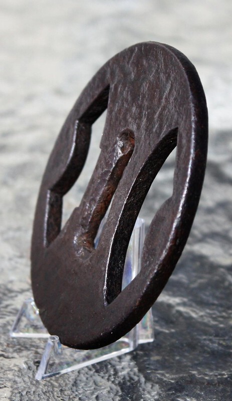

johnnyi Posted March 9, 2017 Report Posted March 9, 2017 I'm torn between even posting this or not because I've been told it is "ugly" but here goes anyway... I'm curious if it is some newer piece , revival maybe, or actual Edo period, or something else. Its large (81.3 x 82.2 x 5 mm)and heavy, iron rings like a bell, and though the pictures might be deceptive, it is not at all rust covered, but is molten with a dark brown patina. I cannot see definite folding, but possible. Is this style of a particular school or period? Thank you in advance for your help. regards, johnnyi 4 Quote
Stephen Posted March 9, 2017 Report Posted March 9, 2017 Beauty is in the eye of the beholder, i find it quite nice, like the two fans. 3 Quote
Rich S Posted March 9, 2017 Report Posted March 9, 2017 Don't know the school; maybe Ko-Katchushi or Tosho? I really like the design and patina. Nice tsuba. Rich 1 Quote
ROKUJURO Posted March 9, 2017 Report Posted March 9, 2017 Johnny,the TSUBA is probably not so old; I don't think KO-TOSHO or KO-KACHUSHI, as these are usually very thin. Did your really measure 9,8 mm thickness? That would be quite extreme! The surface reminds me of several classic TSUBA schools but I think this might be a (well made) revival piece. 1 Quote
Kurikata Posted March 9, 2017 Report Posted March 9, 2017 Johnny, your tsuba is quite nice from my perspective and I agree not as old as Ko Tosho or Ko Kachushi. But I am tempted by a Myochin or saotome influence. I have a similar one ....(http://www.militaria.co.za/nmb/topic/19313-i-know-nothing-the-school-the-design-the-age/) 1 Quote
johnnyi Posted March 9, 2017 Author Report Posted March 9, 2017 Actually in the evening light (bed lamp) there is clear evidence of folding on the corner interior of one of the fans, but it is not the kind of single or double fold you're more used to. . It is a series of layers (seem to be eight in all) similar to what I think Evan described on another tsuba as "spool of thread". Does 8 layers of metal mean folded 3 times?? Quote

rkg Posted March 9, 2017 Report Posted March 9, 2017 Johnny, This is kind of a popular theme - could be saotome, though Thierry's comment about it being Myochin would probably be the best guess - Saotome work often had those ridges around the sukashi that were a byproduct of how they cut the sukashi. Here's a similar piece I have that was attributed to early saotome work by Torigoye that shows this:https://www.facebook.com/pg/Kod%C3%B4gu-no-Sekai-%E5%B0%8F%E9%81%93%E5%85%B7%E3%81%AE%E4%B8%96%E7%95%8C-266005023454853/photos/?tab=album&album_id=1065621873493160spinny_pics, er, uh, 360 degree view - Note that this was before I spent 5 minutes rubbing it with a cloth - that gunk is gone now (it looked like somebody had recently mounted it/used it for iai or something): http://www.rkgphotos.com/facebook_stuff/torigoye_saotome/fan_saotome_torigoye_front/fan_saotome_torigoye.html http://www.rkgphotos.com/facebook_stuff/torigoye_saotome/fan_saotome_torigoye_back/fan_saotome_torigoye_back.html Best, rkg 1 Quote
johnnyi Posted March 9, 2017 Author Report Posted March 9, 2017 rkg, Thank you, and that is interesting about the marks made by sawing (?) the sukashi. Unfortunately I can't get a clean shot under tonight's light, but I saw the same 8 ridges on the the sukashi wall of a probably mid-to late Edo Yamakichibe "knock off". After Thierry's clue as to Myochin, I found by googling a very similar one which seems to share the same exact same arc of the fans, and appears to have the same thickness. regards, John Quote
MauroP Posted March 9, 2017 Report Posted March 9, 2017 Johnny, I'm quite doubtful about your measures of tsuba thickness. If diameter is reported correctly the thickness (estimated from pics) should be just 5 mm or so. Mauro 1 Quote
johnnyi Posted March 9, 2017 Author Report Posted March 9, 2017 Mauro, I'm mortiffied. Yes, my calipers were not set on zero. You are absolutely right, 5 mm on the button. A simple tsuba for a simple mind Thank you! John Quote
Toryu2020 Posted March 9, 2017 Report Posted March 9, 2017 Johnny Very nice tsuba - not Myochin imo - but Yamakichibei google up the work of Naruki Issei... -t 2 Quote
johnnyi Posted March 10, 2017 Author Report Posted March 10, 2017 Thomas, this is enlightening information, regardless of who might have made this particular tsuba. I assume that your reference to Naruki issei was kind of a "...for example" rather than a possibility? To learn a little about such an artist now, one so completely dedicated, and who lived a spartan and solitary life adds such depth to "new" and I can imagine why they are so sought after. I've read they are deeply signed, so as not to be sold as genuine? Thank you, John Quote
Toryu2020 Posted March 10, 2017 Report Posted March 10, 2017 he specialized in this molten finish - many copied it should it turn out to be modern it would be no loss, this to me has the look of a skilled artisan like Naruki... 1 Quote
