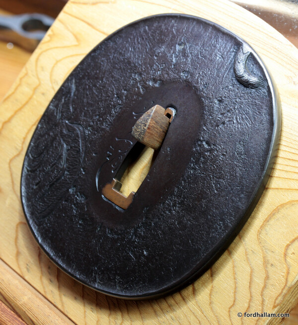

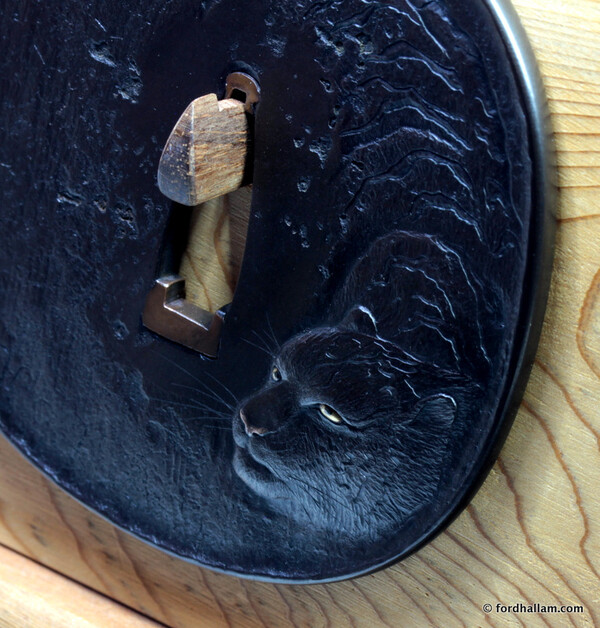

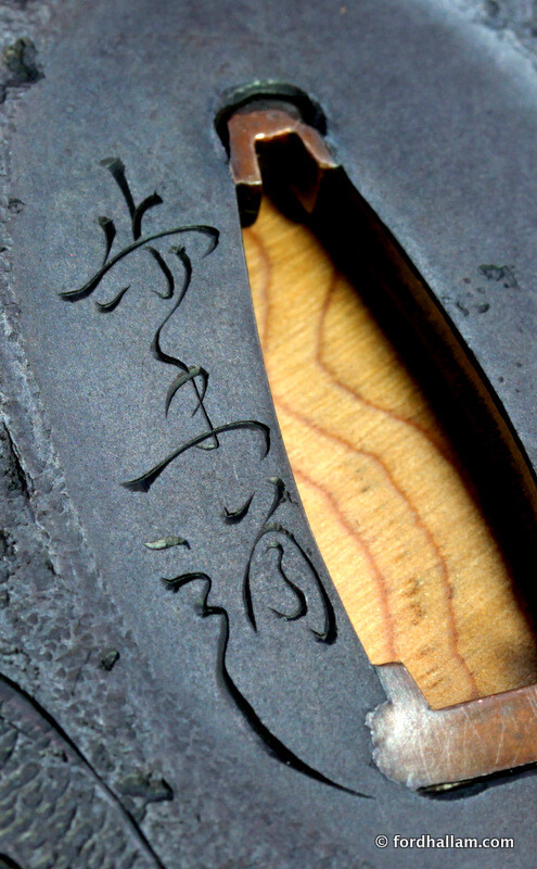

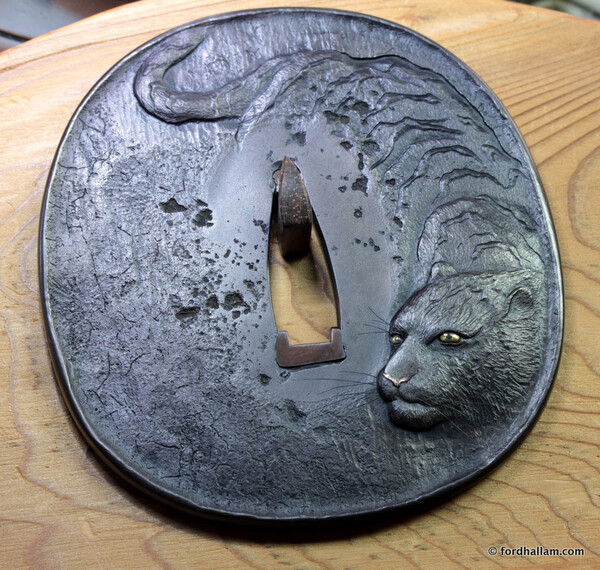

For those of you who don't Instagram or facebook here are a few images of a piece I recently completed. It's a commission thus signed on the reverse.
Not exactly classical Edo period in style the composition is loosely based on a contemporary Chinese ink painting.
It's made of 120 year old finely wrought iron, the eyes are yellow gold and shakudo and the nose is pink gold. Pink gold only entered the Japanese metalworking tradition, presumably from Europe, around 1910-1915, so it's not see in tosogu but is often seen in Meiji period export objets d'art.

Wow Ford amazing work indeed! The 4th photo down is so alive and real looking. Such fine work that im sure the owner will never want to part with. Well done and thanks for sharing.
Greg
Ps. Each angle seems to have a slight different expression and all so real.
Hi Ford
I absolutely love it but am finding it hard to explain exactly why. I think the uncontrived and naturally rough appearance of the iron with the tiger appearing to emerge from it as a composition is fantastic and the finish and patina first class. It seems to hit the senses at a basic level and creates an emotional rather than logical response (like most high art does!)

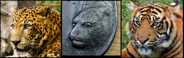

I have to say the same thing as Brian said, those whiskers... :rotfl: I can't wrap my head around how good they look, of course the whole tsuba is very nice but that detail just gets my attention every time I look it.
The Japanese Tiger face "debate" is nothing new.  It has been raised and (I believe) settled long ago with respect to several other Japanese art forms.  For example, netsuke and kakijiku (scroll paintings).  Japan did not have Tigers, so many early Japanese viewed them as mythical like the dragon.  The only encounter that an early Japanese artist would have had with a tiger was on imported Chinese art or in accounts of Tigers or skins coming back from the early campaigns into Korean.  I have seen Japanese paintings where a man is posing, crouched and draped with a tiger skin, while a Japanese artist uses him as the model for his Tiger painting.  Japan did have cats, and many of the artists used them as a model or formed their impressions of what a Tiger would look like from the combination of a tiger skin and the body/face of a house cat.  A cat has more of a Leopard's head than a Tiger's.  The scholars in certain other art forms (e.g., netsuke) have called this a "reptilian" face.  For these reasons, in Japanese art, the Tiger is often depicted with the more "reptilian" face.  In fact, one kantei point for age of a Tiger art item is whether it has a "reptilian" face (older or real) or a more realistic Tiger face (usually meaning Taisho or newer...)  With Ford's skill, I'd guess that he is simply following the Japanese tradition.

It just wouldnt have the old Japanese feel at all if it looked like typical tiger face. Ford has captured what artists of old Japan were going for completely i believe. Brilliantly done Ford.
Greg
