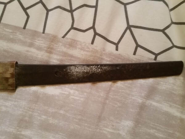

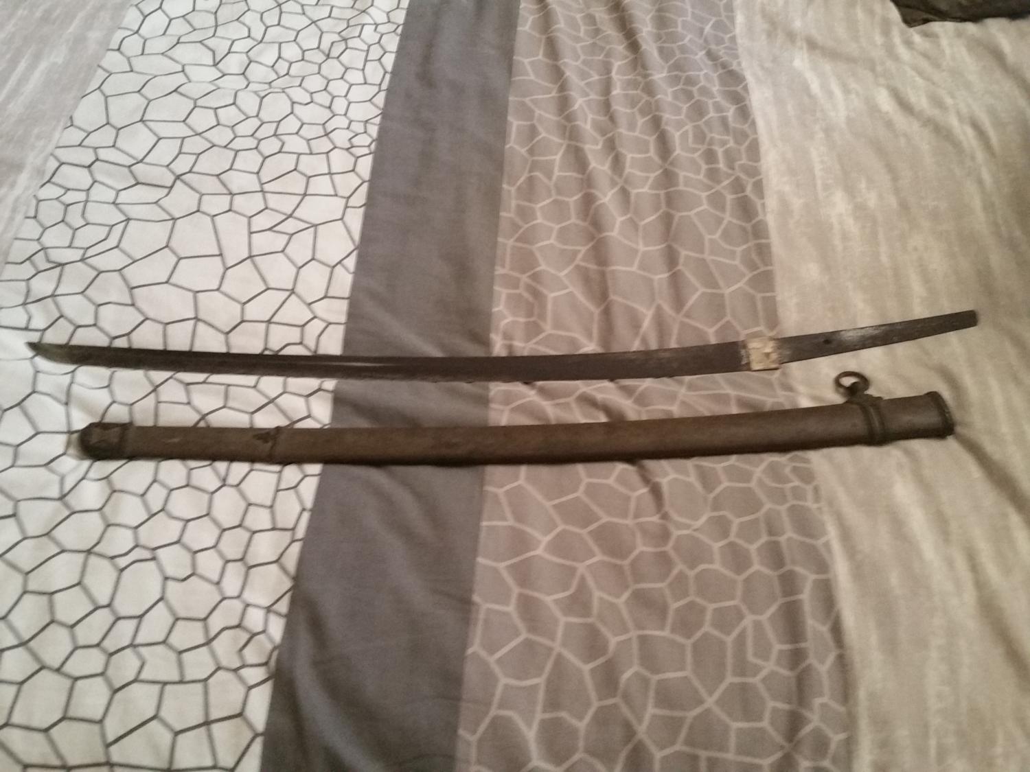

Kirst Posted February 27, 2017 Report Posted February 27, 2017 Hi I really need help!! Was doing some research on an old katana that my grandfather had accepted during the surrender from a Japanese general in paua. Well OMG!! what we have is a niji kunitoshi 2 mai tatchi/katana not sure. What makes it even more interesting is that it has alot of encryption down the blade which is unfortunately in bad shape so hard to read. How amazing!!!! Mind blow aside......where do I go? What do I do? Appraisal, insurance, national treasure listing?? Really confused and not sure who to reach out to and feel I am not taken seriously. Thanks in advance. Quote

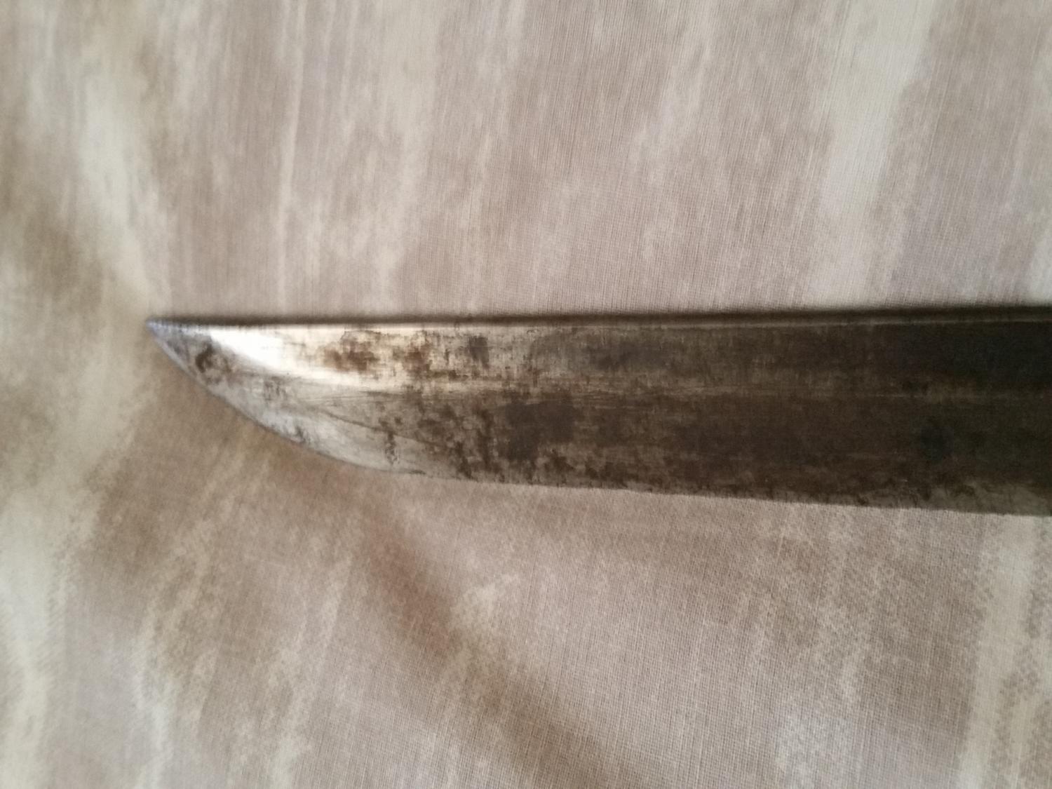

Greg F Posted February 27, 2017 Report Posted February 27, 2017 Gday Kirst and welcome. The first thing would probably be to take pics. Remove the Tsuka (handle) by removing the bamboo pin (mekugi) and take pic of the Nakago with signature. Take apic of full naked blade and of the Kissaki (tip) and any close ups of the blade. If you want any feedback on the Koshirae(fitings) you could post pics of that as well. All the best. Greg Ps. Great to see another Ausie on board. Quote

Ray Singer Posted February 27, 2017 Report Posted February 27, 2017 Copying over my comments from the duplicate post.Hi Krist,First, please don't give to an amateur polisher for restoration. You have Andrew Ickeringill in Australia who may be able to connect you with an agent for the shinsa process to authenticate the sword and confirm whether or not you have an actual Niji Kunitoshi.That said, can you provide us with more details and give background on why you believe it to be a Kunitoshi? Even if authentic, I would not encourage you to have the expectation that the sword will be designated a National Treasure. One of the most popular dealer's sites, aoijapan.com, had a signed (gakumei) Juyo Niji Kunitoshi wakizashi which they sold for around $25,000, based on the JPY / USD exchange at the time.Look forward to seeing photos when you able to share them.Kind regards,Ray Quote
Kirst Posted February 27, 2017 Author Report Posted February 27, 2017 Okay I did post pic on here just before every thing got wiped. And 2 people agreed ot was kunitoshi. I am not concerned if it is genuine or not as I know where it has been the last 60+ years. Just need info or contacts please. I added pic to original post. Sorry it took a bit when I upload here it makes me take the pic not upload from gallery. So it took awhile to get decent pics. Tried to capture markings on blade. Quote

Bazza Posted February 27, 2017 Report Posted February 27, 2017 Hello Kirst, IMHO this is a WW2 arsenal sword. The giveaway is the chippy style of writing. If you live anywhere near Melbourne I can look at it for you. However, Andrew Ickeringill is also in Melbourne and is here: https://touken-togishi.com/ All your answers are there. PM me if you have any questions. Best regards, Barry Thomas aka BaZZa. 4 Quote

Bazza Posted February 27, 2017 Report Posted February 27, 2017 We are about 3 hour out of melbourne. So does andrew do appraisals? It has no arsenal stamps other then the cherry blossom under the mai. The cherry blossom is also a dead giveaway of a WW2 arsenal (i.e., non-traditional) sword. The O-sujikai yasurime is indicative of a Seki manufacture. Andrew does appraisals, but you best contact him about that. Quote
Kirst Posted February 27, 2017 Author Report Posted February 27, 2017 I put the signature in the translation section yesterday asking for mai to be translated and two guys came back with kunitoshi. Quote
Kirst Posted February 27, 2017 Author Report Posted February 27, 2017 Yes i am aware of the cherry blossom but it is not where it should be and also not dated at all and all of the writing down the blade. I will wait till I can take it somewhere. Quote
SwordGuyJoe Posted February 27, 2017 Report Posted February 27, 2017 Yes - it says kunitoshi. But as stated, the cherry blossom is the "sho" stamp, indicating that it was non-traditionally made. Your smith is likely Mori Kunitoshi - a seki smith from WW2. The blade is signed "Nijimei" which means a two character signature. Perhaps that is where the confusion is coming from, since whether it is Mori or another smith that signed Kunitoshi, it is certainly a WW2 blade. Here is a useful site that - as a modern sword collector - I frequent regularly http://www.jp-sword.com/files/seki/gendaito.html 2 Quote

Ray Singer Posted February 27, 2017 Report Posted February 27, 2017 This is very clearly a Showato as others have said. A mass produced blade of 20th century manufacture. The same signatures are often used by a number of smiths from different schools and time periods. This sword has no relationship to the Kamakura period Rai smith. 2 Quote
Jamie Posted February 27, 2017 Report Posted February 27, 2017 I agree it's Showa to. Writing is chippy as others have also said. Quote

raaay Posted February 27, 2017 Report Posted February 27, 2017 this is a Showa sword IMHO , as previously said in other replies . sorry Quote
Kirst Posted February 27, 2017 Author Report Posted February 27, 2017 Thanks heaps for all the help. Just thought pop back and let you know how I went. Andrew got back to me and agreed with you all that it is signed kunitoshi but not the kunitoshi. Andrew couldn't see any arsenal marks ao said there is a chance that it could be genuine but would need to have it in hand or possibly polish a window. I had also contacted a markus sesko who got back to me with this. However, it is not Rai Kunitoshi in his earlyer Nijimei phase but a WWII smith with that name, most likely the work of the Kunitoshi whose real name was Mori Kunimatsu. He was from Gifu and was born in 1914. There were three more smiths active at that time who signed with Kunitoshi - Nigara Hiroshi, Fujimura Matsutaro, and Enju Kunitoshi - but their signature style differs from your blade and therefore I think it we are facing a work of Mori Kunimatsu alias Kunitoshi. Best regards, Markus I have a new found love of Japanese swords now, I had no idea the complexity behind them. I take my hat off to all who study this acient art and now complete understand how addictive it can get. I have 2 other Japanese swords I might look into now, much newer ones. Also like to say thanks to bazza for the info and amazing offer. Kirsty 1 Quote
