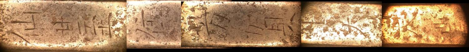

kalamarz Posted March 10, 2017 Author Report Posted March 10, 2017 Thanks Gents! Piers-san, I was able to uncover more characters but the last ones are almost impossibly to bring up. Please see below: Thanks, Paul Quote
Bugyotsuji Posted March 10, 2017 Report Posted March 10, 2017 That's good, and still on track. You are now down to the Toyo 豊. There should be one more below that, however faint. The last character will be the key to pinning down which generation, first second or third. Quote

kalamarz Posted March 11, 2017 Author Report Posted March 11, 2017 Gents, You all are the wealth of knowledge! Piers-san, there are two characters at the end not one... I think the one before the last one has some features of 成, but I'll let you be the judge: Many thanks for all the help, Paul Quote
Bugyotsuji Posted March 11, 2017 Report Posted March 11, 2017 Ah, yes, thank you Paul. Sendai smith, 芳賀十太夫豊成 (Haga Judayu Toyonari). Let's go with this one then, second generation, if no-one has any objections. As to fouling I discovered during one blackpowder matchlock display in my early days that after seven or eight shots the barrel gradually became too hot to hold. Each castle gunner would ideally have had two or three guns at his disposal and a team of loaders and cleaners at his back. On an active battlefield you may not have had time to fire more than two or three shots before fighting became hand-to-hand. 2 Quote
