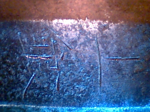

kalamarz Posted March 8, 2017 Author Report Posted March 8, 2017 Piers-san, I found couple more characters interestingly on a side adjacent to the one with main characters, please have a look. Thanks, Paul Quote
Bugyotsuji Posted March 8, 2017 Report Posted March 8, 2017 Small oops moment. Slip of the pen(?) When I originally wrote the smith's Romanized name of 芳賀 as Hōga, it should have been Haga, an alternative, but in this smith's case, probably more correct reading. Difficult for most Japanese to know how to read it, it seems. These two Kanji you have found are pretty well unreadable for me. I suspect there may be more kanji on the facet to the 'right' of the Mei as you hold the muzzle upwards. The only long shot is another gun from this gunsmith which bears the inscription 鉱鉄上々鍛. Could what you have uncovered be 上鍛, I wonder, i.e. Superior forging? Quote
kalamarz Posted March 9, 2017 Author Report Posted March 9, 2017 Piers-san, I was able to "excavate" these some more, not sure if this is more helpful. You also mentioned writing to the right but we already looked at them before. I'll try to get some better images of these characters later. Thanks, Paul Quote
Bugyotsuji Posted March 9, 2017 Report Posted March 9, 2017 Nothing more on all three facets then? OK, forgive me! Now with those fine new shots for which thanks, I think we can just about confirm the 'long shot' above. Agegitae, Jotan, meaning what? In swords basic process (下鍛 = Shitagitae) completed, plus further process (上鍛). Or does it mean superior workmanship or superior forging? See No.3 on this page for the expression Agegitae, where it means continuing to hammer and fold steel to produce skin steel or harder, less malleable outer layer of a Nihonto blade. http://www.touken.or.jp/seisaku/koutei.html Quote

IanB Posted March 9, 2017 Report Posted March 9, 2017 Piers, I read the two character inscription as 'superior forging' . Work-hardening by repeated hammering was also practised in Europe. Felix Werder, a Swiss gunmaker, hit on the idea for producing brass barrels which he claimed were superior to any others - keeping his technique a secret and charging the earth for his guns. In the days of muzzle loading brass barrels were less prone to damage by corrosion and could be kept loaded (hence their frequent use for blunderbuss) and in his case very thin and light weight and hence desirable. What he in fact was doing was casting the tubes and then repeatedly hammering them around a mandrel to break down the crystal structure and harden the metal. The research on a pair of his pistols has been done and published but I'm b*ggered if I am quoting full references on a simple observation As for the use of mon on export goods - of course they were! Some items were covered in them. The jingasa illustrated in the Galeno Collection p.128, looks like a page from a book on mon. This poor old thing has obviously had the treatment to attract a buyer. You should read the book by Mortimer Menpes of his time in Japan where he is befriended by a Japanese antique dealer. He describes all the tricks being perpetrated to produce stuff for the tourists. Ian Bottomley 5 Quote
