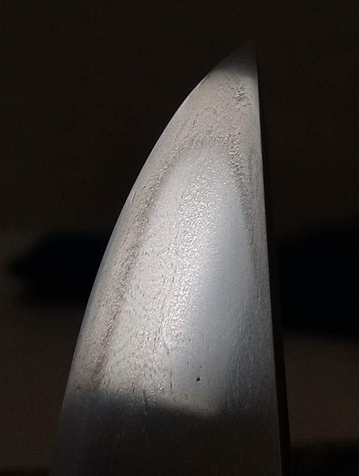

Ray Singer Posted February 16, 2017 Report Posted February 16, 2017 Presently Tokubetsu Hozon (kanteisho attached). I'd like to see that Enju tanto for sure. What's the date of the attribution and what level is the paper now? Quote
Ray Singer Posted June 16, 2018 Report Posted June 16, 2018 Long overdue, but a few photos of the Enju tanto referenced above. 3 Quote
