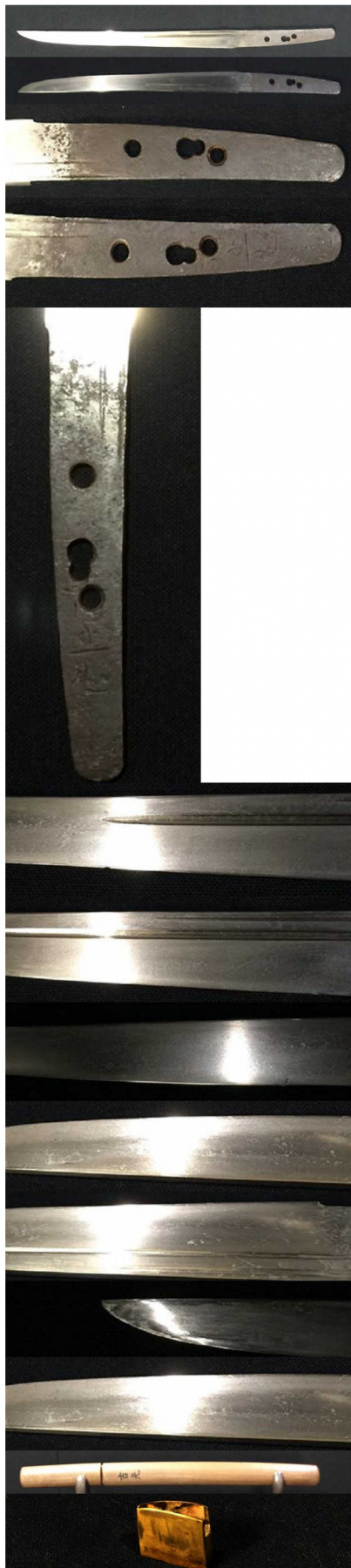

Yesterday, after the expiry... I found this tanto with mei "Yoshimitsu" (Awataguchi): http://page23.auctions.yahoo.co.jp/jp/auction/o173053863
What do you think?

I am sure you have already had a look here, http://www.nihonto.ca/awataguchi-yoshimitsu/ Given the source of this tanto, not to mention the poor photographs, not to mention the sugata I don't think I would lose any sleep over having missed this one.  The chances of such a blade escaping unnoticed from Japan, out of polish yet in a suspiciously new looking shirasaya must be regarded as slim.  Comparing what can be seen to the stunning array of examples on Darcy's site I think you can relax.
Of course there are many other Yoshimitsu and it might be any one of them.
All the best.

I "know" about 60 swords by Awataguchi Yoshimitsu, and starting from the sugata in the tantō, they have uchizori, however this have sori (I don't think only 0.1 cm, as also the kasane with only 0.3 cm).
I don't know the Japanese, but I read that the seller says he may have suffered a fire, (I think) then the sori could be caused by saiha. What do you think?
The sabi and the mei seems very good, remember that its signatures are divided into three time groups.
from left to right: koguchi-mei, intermediate, ōguchi-mei.
This reminds the ōguchi-mei?
