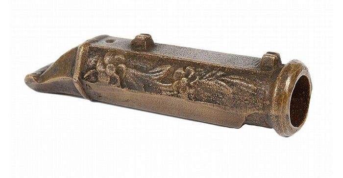

JPGH Posted September 8, 2018 Report Posted September 8, 2018 Hi everyone, My apologies for dredging-up this old thread, but I was hoping for a little help? I've been researching the $500 piece at the upper left being offered for sale in this 1907 catalog for a couple of weeks now and haven't found much of anything. From my research: made in China(?), Dynasty made unknown and 20th century crude cast brass reproductions of the piece are being offered and/or sold as originals. Can someone here please shed more light on this weapon? Thanks in advance for your time and replies. Kind regards, Jo Quote
Bugyotsuji Posted September 8, 2018 Report Posted September 8, 2018 Jo, it is a Japanese Kayaku-dameshi powder tester. 火薬試し Ignore the original description. Most of it is wrong. They are rare but not über rare. I have owned three of them. When a new batch of black powder was made up the gunsmith could test fire in the hand or nailed or strapped to a bench, judging the flash, the smoke and the report whether it looked good. By the same token as you say there are crude modern castings going around of inferior quality, so be aware! I have taken two or three of them in hand. A good one today should not cost more than $500 US in modern dollars unless it is of particularly fine or unusual workmanship. (No idea what a modern brass copy would make, but I would not want to pay even $50 for one.) Quote
JPGH Posted September 8, 2018 Report Posted September 8, 2018 Thanks so much for your reply and info, most interesting! I've seen these 'Kayaku-dameshi' while conducting my research into the 1907 catalog's version, but have still not found any examples of this 1907 cataloged piece other than these reproductions... ...being offered and/or sold as original period pieces. I was lucky in finding this 1981 catalog image (although bleary) of the actual gun company who reproduced these and were selling them at $5 USD each: I've found many different examples of authentic original period 'Kayaku-dameshi' you've mentioned, but no authentic original period examples of the 1907 cataloged piece, why is that? Is the 1907 catalog version in fact Japanese, or is it Chinese? Did the Chinese not make 'Kayaku-dameshi' type pieces to test their black-powder? Quote
Bugyotsuji Posted September 11, 2018 Report Posted September 11, 2018 Jojo, I have not had one of those that you show in the hand so cannot say whether or not the ‘original’ version was Chinese, Japanese or indeed Korean. The short butt and straight barrel are not in my experience typical for Japanese Kayaku-dameshi. There was a similar pocket cannon called a Futokoro-deppo and I find even Japanese authors confuse the two. Yours looks more like a reproduction of a Futokoro-deppo 懐鉄砲, or waist/pocket gun. Such a small gun would be incredibly hard to hold and fire without flash burns, even if you had a handy taper to set it off... Quote
