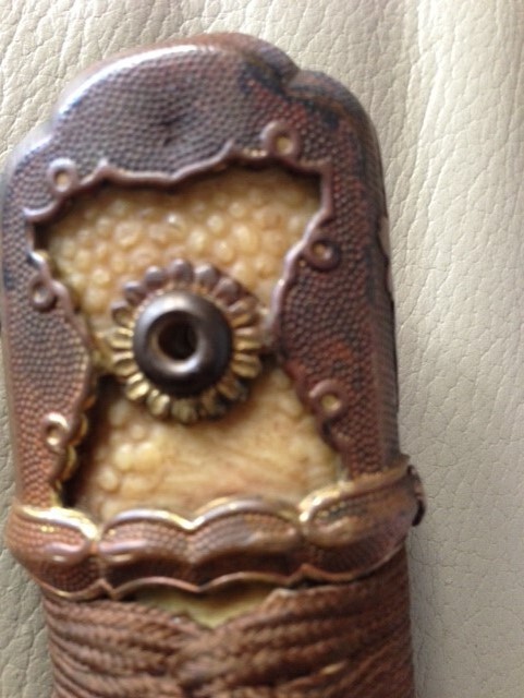

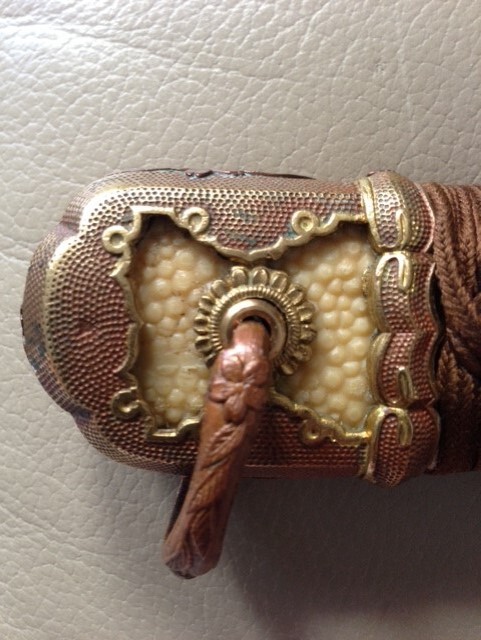

Kwakernaak Posted January 27, 2017 Report Posted January 27, 2017 Hi fellow collectors. I am trying to translate the makers mark on a shin gunto. Strange on this sword is that there is no arsenal mark on the tang. Can anybody help me find the maker of this blade? Your help is appreciated. I managed o find .....MICHI...SAKU, but the other letters I am not able to find clear reference for. Thanks in advance, Peter Jan Kwakernaak Quote

IJASWORDS Posted January 28, 2017 Report Posted January 28, 2017 Hi Bruce, I have a few swords with arsenal stamps on the KABUTOGANE of some GENDAI swords (KANENORI, MASAKIYO), do they count, (not on the blades however). Neil 1 Quote

Bruce Pennington Posted January 28, 2017 Report Posted January 28, 2017 Neil, yes I've seen stamps on koshirae, but even that one is more an inspector stamp rather than the arsenal stamp; but I meant the blade itself. David, Like I said, my experience is QUITE limited as I've only been studying gunto for a little over 2 years. And one of my lessons learned is "never say never!" Would you think it fair to say that it's rare to see arsenal stamps (not inspector stamps) on Army gunto? I'd say it's slightly more common to see inspector stamps, like Na and To on Army gunto, but even that is PROBABLY less than 50%, seems to me. Quote
