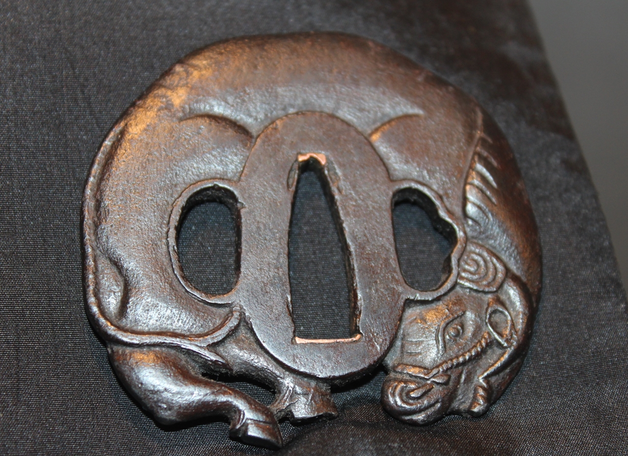

again a very nice and good forged Iron Tsuba to find a new home....
This is most probably a Echizen Kinai school work ? - i am but not shure here...
Wide is 65 mm, Hight is 64 mm, Thickness on Seppa-Dai is 5 mm

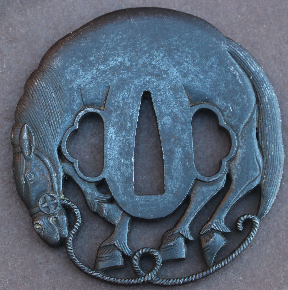

I wondered about buying this tsuba as I bought the one below about a week ago and know nothing about it
As some had mentioned the horse tsuba I have attached mine
The patina is better than shown in the image

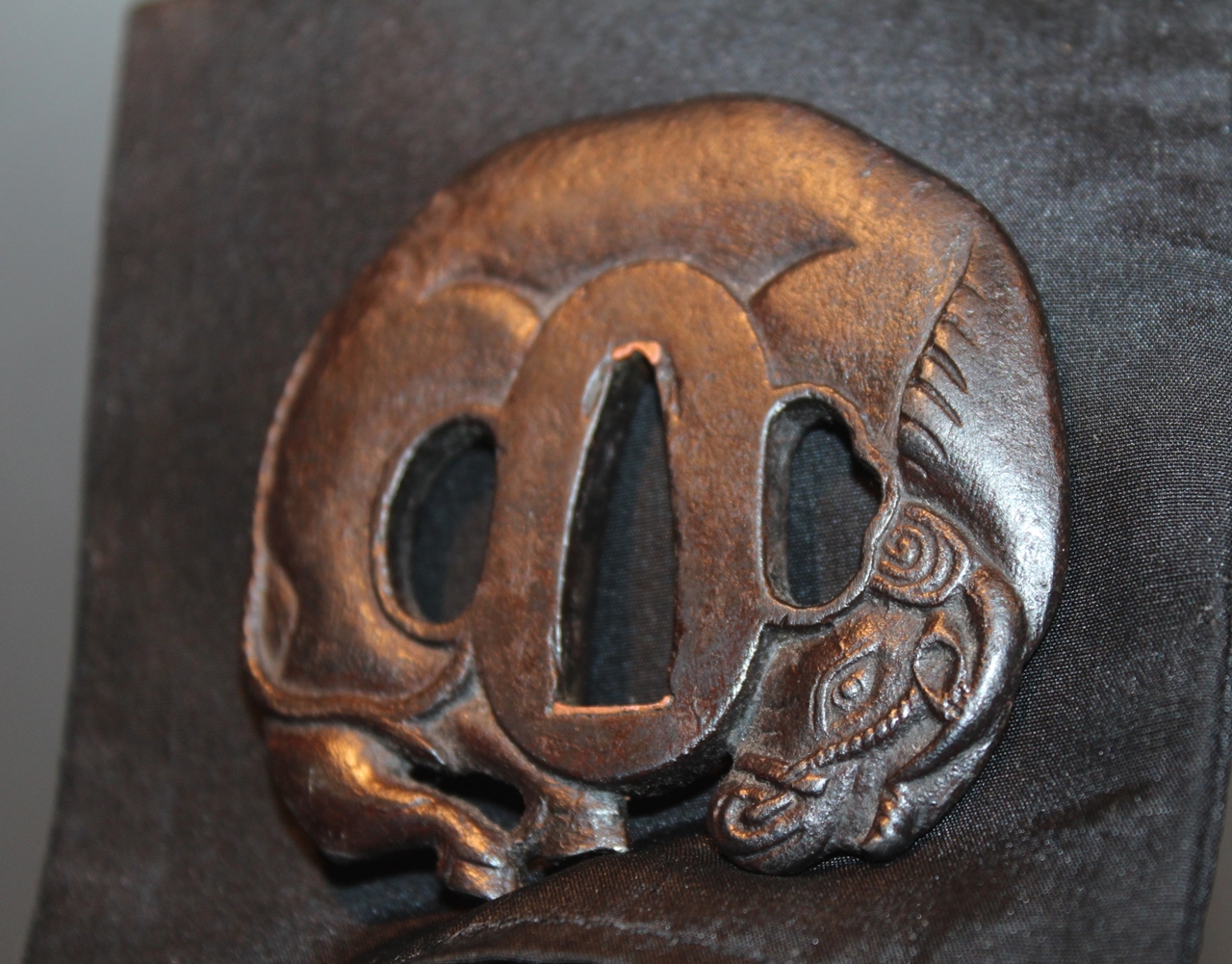

Dear Gentlemen,
you are right of course in inquiering here on this piece! no problem at all! I would do equal!

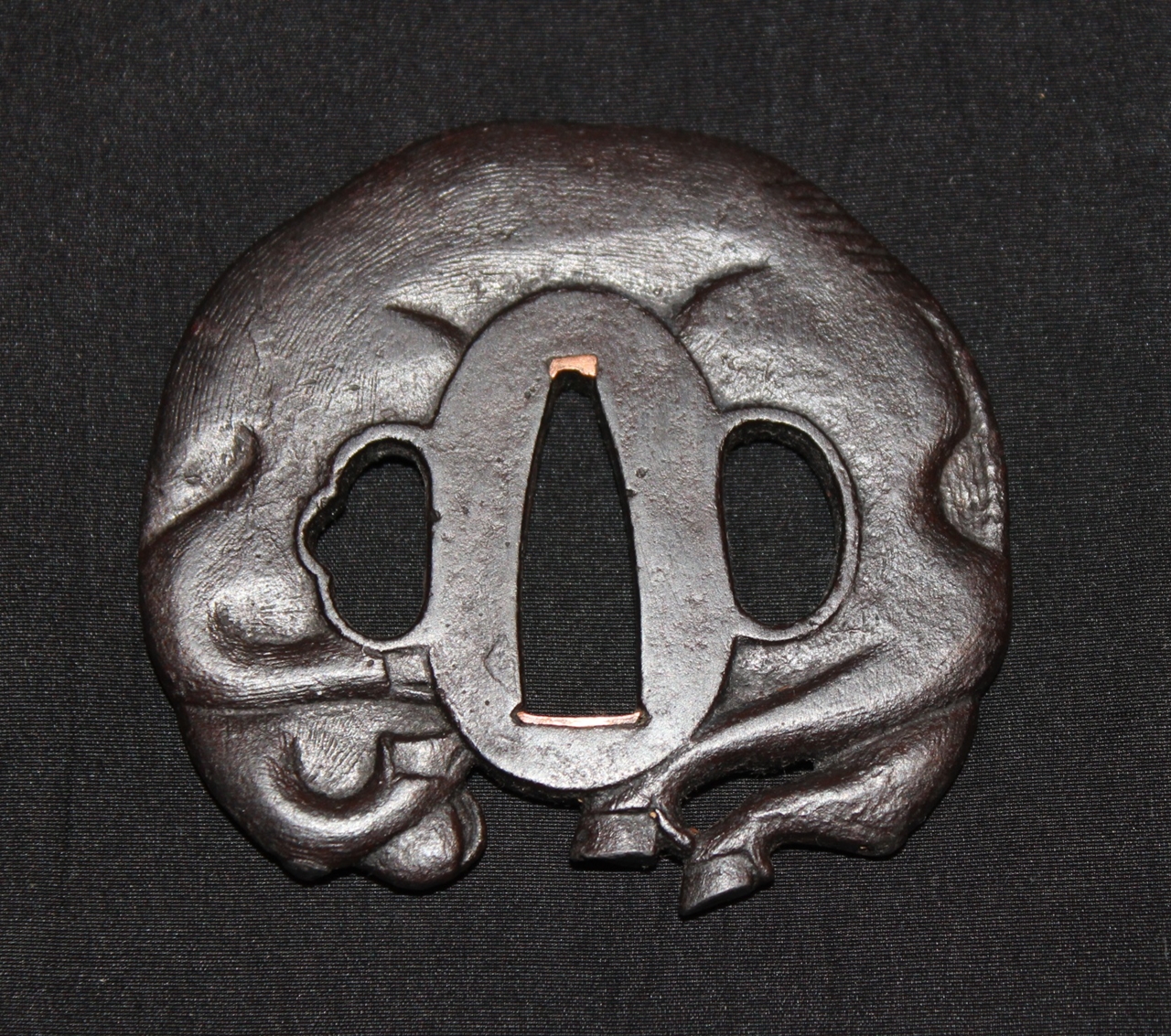

this Tsuba is definitely forged! there are several lamination folds to ben seen in the mimi and in the inside of the Ana....
equally this Tsuba has got a very high ring sound if tapping it.....
if this would be a cast one - i very certainly would not have offered it for sale! (as, there is still my name standing behind a sale!)
the patina is equally authentic- these coulor-divergences from grey to blackish tones to ben visible on mine pictures i took...most probably do result from the light situation and the camera flash....
there is equally no sign that this Tsuba had a missing object like a rope...there is no evidence such had ben there once....
no, no worry at all! this is a authentic antique Tsuba in very nice condition!
i do repeat me- i had not offered it if i had any doupts myself! and i think i do know of what i am speaking...collecting me Tsuba since many years....
Christian

Alan i cant see why you would think its cast. Could you please explain? Im quite sure Christian wouldnt sell it here if it was cast and if so he would say so imho.
Greg
Greg et al,

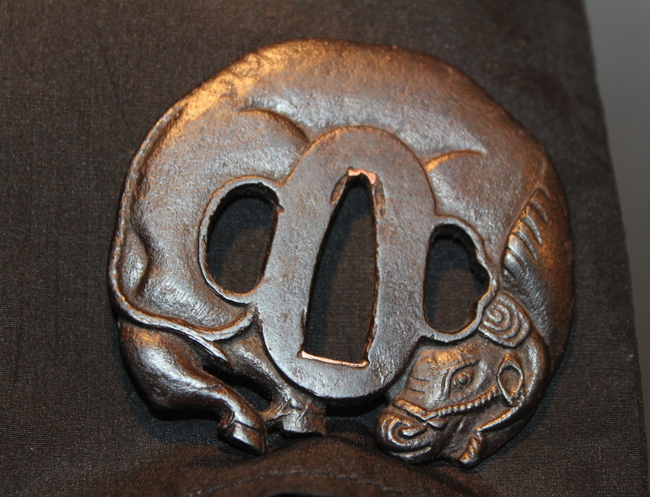

It is just a feeling really, a lack of definition of the surface, I didn't like what appears to extra metal on hoof 2 in image #1, though this could be rust, likewise a triangular raised patch on the lower left seppa-dai on image #3 (firescale?) (Paranoia?).
Of course I am probably completely wrong and the tsuba is OK, that's the trouble with not handling a piece and just looking at an image.
 think I am also Influenced by the tsuba like this that I have seen over the decades (the single horse/ox/fish/snake in the round), over half of which were castings for the tourist trade. I hope this clears up any doubts that I may have raised.
