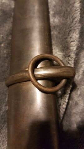

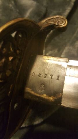

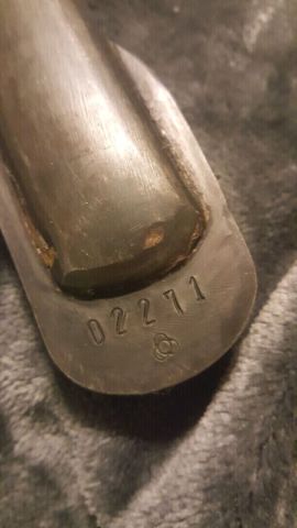

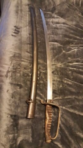

Hello Everyone,
Someone would like to sell me this sword.
Since this is not at all my area of expertise....any help would be appreciated.
Question: Does the sword look authentic...and if so any idea of potential value?
Several photos attached.
Thank you for any help.
Greg

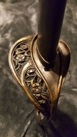

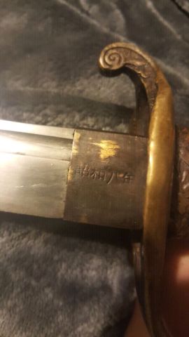

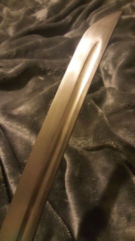

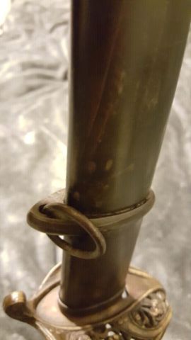

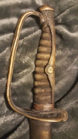

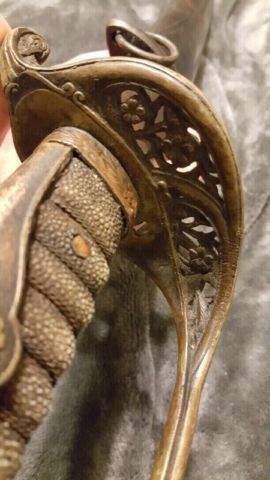

Guys, I don't follow this style so I have very little to go by, is there anything beyond the serial number that bothers you. Asking for the education, not to argue. The pics are poor quality, but the sabre seems to look good. These type of gunto did come with scabbard drags (pic below from Ohmura's site)
Greg, do you have some better pics, like a view of the handguard basket, and closeups of the handle backstrap?
Everything is wrong with this. Run away please. The details should tell anyone what they need to know (that the habaki told you already).
Backstrap- wrong
Basket - wrong
Habaki - wrong
Bohi - wrong
The flourish on the "knob" of the basket - wrong

You should grab a few books Greg, so you can do some preliminary investigation into what you find. For military swords, the old classic is Swords of Imperial Japan by Jim Dawson. While it's a fairly limited work (but it'd take a library for a full catalog) it provides the basic patterns of most kinds of military sword. A quick look through showed me that while there were parts of this sword that matched with known patterns, there were none close enough. Primarily the serial numbers and Kokura stamp do not seem to appear on any pattern bar NCOs, nor do any but Manchurian swords have such a steep curve to the knuckle guard.
