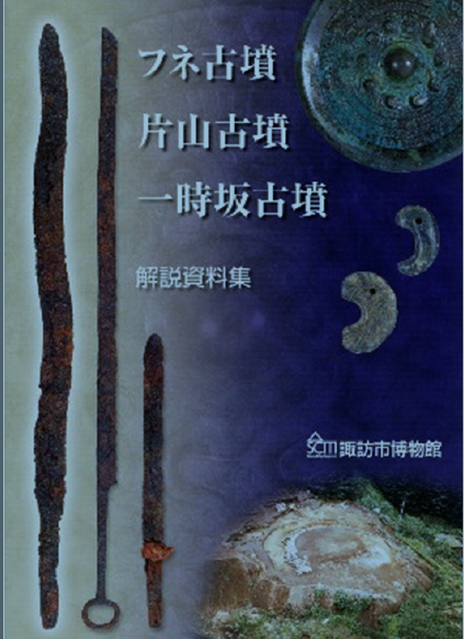

Short and straight doble edged  swords never had a fighting use in (Yamato ruled and after unification) Japan. In early periods (300-500 C.E.) the ceremonial swords were, generally, either straight and double edged, much like the well known Ken that resembled the ones of the Late Chou Dynasty, or indigenous, snake-like “Meandering Swords” (Dakô-ken) soon replaced by Ken. For ceremonial we could consider also "status symbols" for High rank officials. Longer (partially) double edged blades seems randomly used in the pre-Wanto period.
BTW, Wikipedia is not a reliable source, and very far to be academic. Good for quik references that have to be confirmed by more academic means.
Hereunder : Ceremonial (religious) Dako Ken, long combat chokuto and ceremonial (social status and religious) proto-Ken
