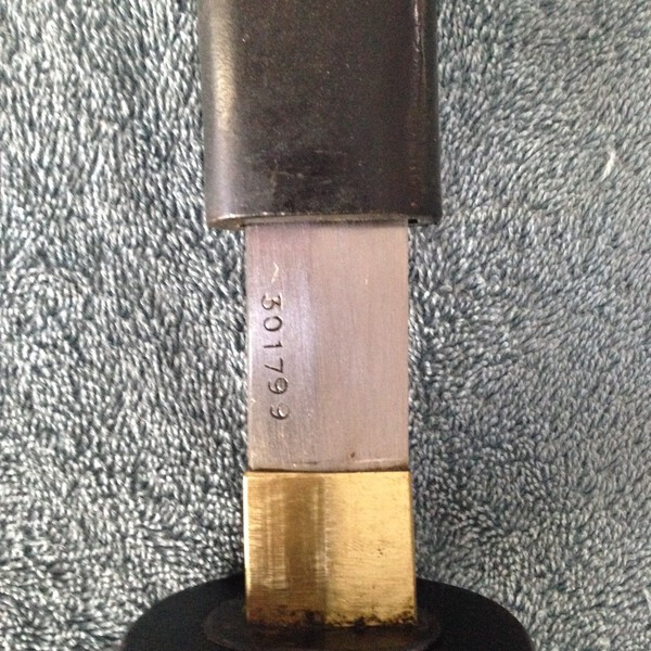

mauser99 Posted January 11, 2017 Report Posted January 11, 2017 Here is one of the better fakes I have seen. Stu W. posted it over on WAF. The overall construction is better than most. The grip is painted very well. Saya color is all wrong but when you get to the # stamps that's when it all goes away. Quote

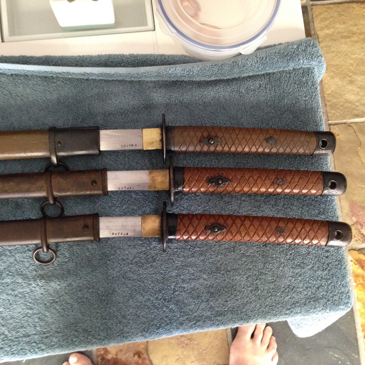

Shamsy Posted January 11, 2017 Report Posted January 11, 2017 I think that the stamping also depends on whether or not the numbers were applied via roller or hand. The deep serials are rolled on via machine and are therefore uniformly applied and even. The most shallow numbers look to be struck by hand and consequently are often not aligned, sometimes overstruck and missing part of the number from a poorly angled strike. I will post some pictures tonight if I can since my pattern 4 falls into the very lightly stamped by hand variety. It's also got that distinctly light brown paint and light fuchi stamps. Luckily Wayne that fake just screams Chinese to me, but I'm sure one day it will be near impossible to tell. Cheers guys, enjoying this thread! 1 Quote

Shamsy Posted January 12, 2017 Report Posted January 12, 2017 As promised here are a couple of pictures showing the very shallow stamping that appears to be hand struck and the fuchi with the Seki and Nagoya stamps. Quote
mauser99 Posted January 12, 2017 Report Posted January 12, 2017 very exciting... That one is very close to the one I just purchased. Being 201861 . The wood grip variants seem to start in the 203xxx serial range. I haven't seen one any lower. As anyone else ? Quote

Bazza Posted February 16, 2017 Report Posted February 16, 2017 On 1/11/2017 at 2:35 PM, mauser99 said: Here is one of the better fakes I have seen. Stu W. posted it over on WAF. The overall construction is better than most. The grip is painted very well. Saya color is all wrong but when you get to the # stamps that's when it all goes away. Here is a Traditionalist chipping in!!! Wayne, your 53827 number to me looks most unlike a stamp. The minute irregularities within the numbers themselves suggest to me a Dremel-type tool rather then a stamp. Being a (Chinese??) fake could it even have been Laser etched??? BaZZa. Quote
Shamsy Posted February 17, 2017 Report Posted February 17, 2017 Hi Bazza, These models are far too rare. The Chinese have never attempted to make a copy. Across the many thousands of NCOs made you'll find a whole variety of serial number stamps. Some are incredibly deep, others shallow. Some are wonky, some dead straight. Some evenly applied, some only half struck. Some overstrikes, some that appear to be struck with two different numbers. The standard NCOs have no real standards! It regularly makes people question good swords based on the misconception that any variation on the one or two they have held must mean a fake. Truth is there are barely any fakes that aren't glaringly obvious. 2 Quote
