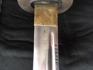

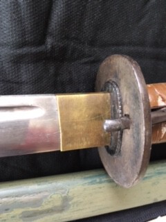

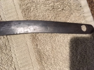

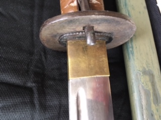

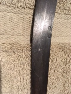

Bruce Pennington Posted January 7, 2017 Report Posted January 7, 2017 Just got my Nagoya Type 95 version 3 today! Matching numbers: 134112, with Nagoya stamp on blade and one seppa. Someone in the past has tried to repaint the saya, but I'll attack that with some acetone. The nakago is really odd and appears to have been bent. There are hammer marks on the nakago mune. At first I thought it might have been damaged and a new end attached, but there is no observable seem, and the rough file marks seem to cover the bend unmolested. The ana have been widened to account for the bend. Peculiar, but then I enjoy the odd-balls! (takes one to know one, eh?!) 4 Quote

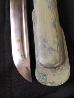

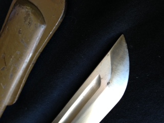

Bruce Pennington Posted January 7, 2017 Author Report Posted January 7, 2017 Neil, Can you post a pic of the kissaki end of the bo-hi on your gunto? I've never handled a Nagoya 95 and this being my first I was a little worried about the shape of mine. It's rounded vs the Kokura/Tokyo Arsenal blades that the end of the bo-hi follows the shape of the kissaki. Quote
IJASWORDS Posted January 7, 2017 Report Posted January 7, 2017 Hi Bruce, my blade is untouched and pretty rough compared to yours. Hope this helps, Neil. 1 Quote

Bruce Pennington Posted January 7, 2017 Author Report Posted January 7, 2017 On 1/7/2017 at 7:11 AM, IJASWORDS said: Hi Bruce, my blade is untouched and pretty rough compared to yours. Hope this helps, Neil. Thanks Neil, it appears the Nagoya style bo-hi ends more rounded unlike the Kokura/Tokyo blades. The full length of it (bo-hi) is not as precisely cut, and the kissaki is more squarish. Good to know when trying to spot fakes and reproductions. Quote

Shamsy Posted January 7, 2017 Report Posted January 7, 2017 The side latch are too rare to have any fakes out there Bruce, so don't have any doubts over any you see that are not quite conforming (unless it is completely off of course!). I've seen them with shallow blade numbers like Neils and the deeply stamped blade numbers like your own. There are a couple of different tones of paint, though the light brown is usual for the handle. ((P.S Colour blind so don't trust my judgement)) 3 Quote
