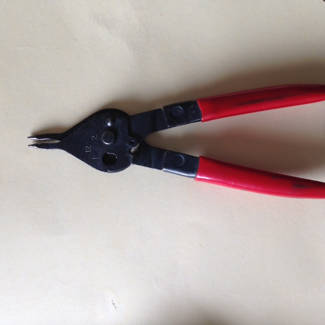

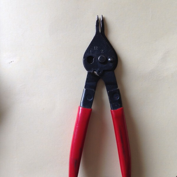

Bruce Pennington Posted January 3, 2017 Report Posted January 3, 2017 Well, seppa won't have a serial number. SOMETIMES they will have assembly numbers stamped in English (rarely in Japanese) that will match with seppa, fuchi, etc). As to removing the handle (tsuka), I like to do it but many guys don't, because once reassembled, there is always a little looseness to the whole thing. But if you are like me, and want to see everything, you'll notice the nut side has a special double pin that takes a special tool to hold while you turn the screw side with a screw driver. If it's rusted you might want to try some rust penetrant first. You'll also have to pry the tassel loop apart to unscrew the nut and bolt at the end of the handle. Here's a pic of the tool I use: Quote
