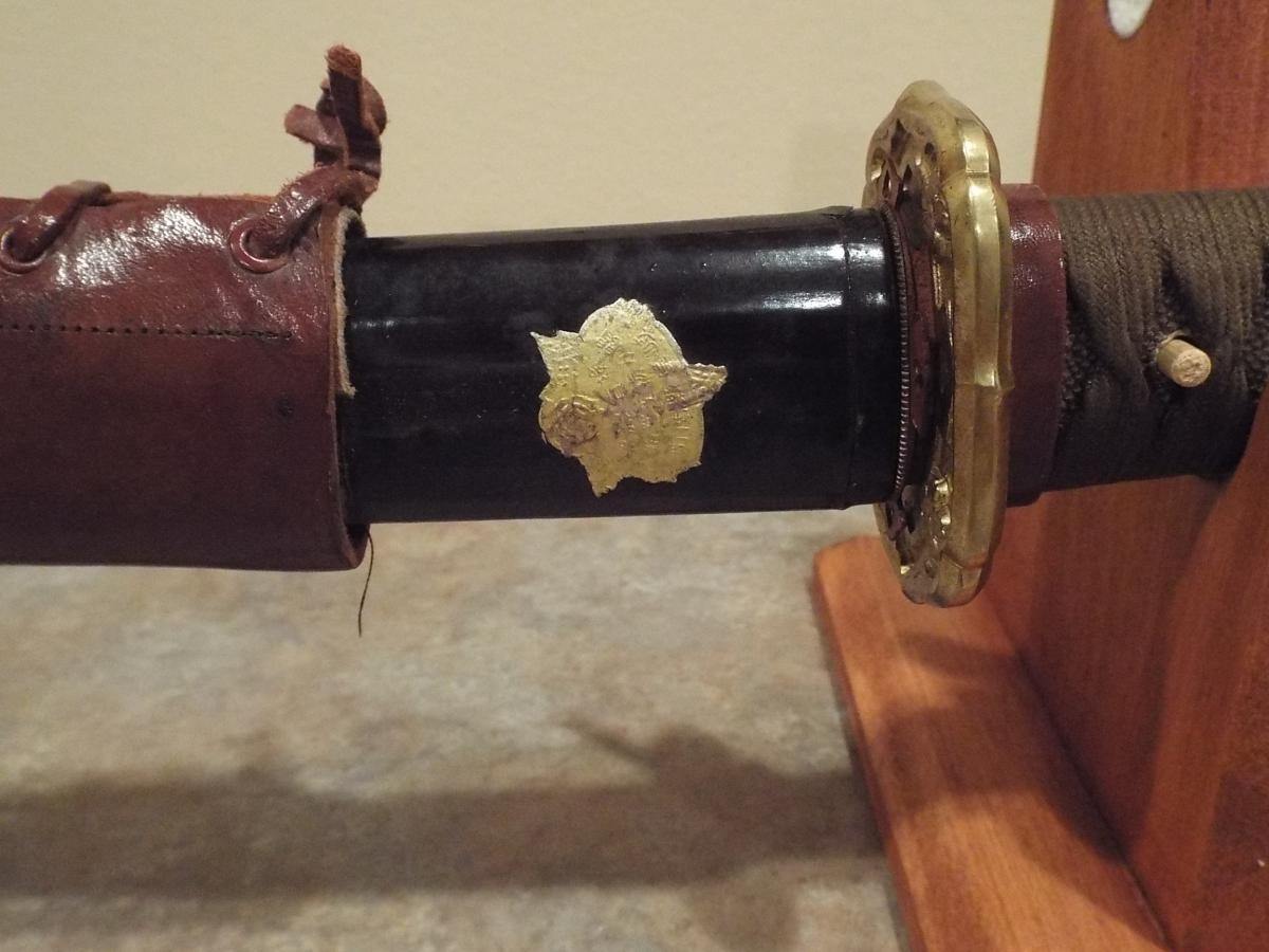

PNSSHOGUN Posted November 30, 2017 Report Posted November 30, 2017 I'll get some photos when it arrives, I saw it and remembered this thread and had a go, sometimes you do get lucky on ebay. 1 Quote

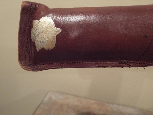

Dave R Posted November 30, 2017 Report Posted November 30, 2017 On the cover is unusual, almost always stuck to the saya under the throat. Maybe they forgot to stick it on until after the leather was applied... Or perhaps it's the cover that was inspected. The saya underneath looks to be an old (Edo) one. Quote
Shamsy Posted November 30, 2017 Report Posted November 30, 2017 Very nice catch John! My combat cover is tatters, but the sticker underneath is pretty minty too. Glad you went back to this thread to keep the info compiled. 1 Quote
Dr Fox Posted November 30, 2017 Report Posted November 30, 2017 The thought I have, is that should one come across a sword as this, with poorly cast fittings, and a poor blade to match. And not having the benefit of the exposure given here. Is that these poor relatives to better examples, could be passed as Chinese, and as a consequence be ignored, as not having any importance what so ever. Quote
Bruce Pennington Posted November 30, 2017 Report Posted November 30, 2017 Or perhaps it's the cover that was inspected. The saya underneath looks to be an old (Edo) one. That's an interesting thought, Dave. If the saya were old, but it was the leather cover being made for the war, then it would be the cover that would need inspecting, as to it's meeting wartime regulations/standards. Quote

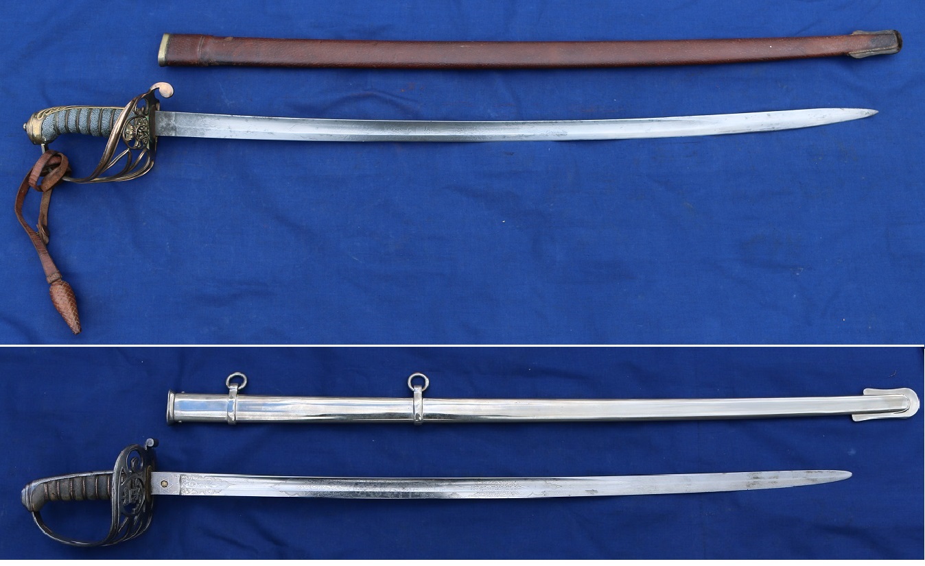

Dave R Posted December 1, 2017 Report Posted December 1, 2017 You get the same thing in British military swords in the 19th C.. There is the formal dress scabbard and the field scabbard. Below are two 1845 pattern officers swords, one in a steel dress scabbard, the other in a wood and leather field scabbard, which would go into the Sam-Brown equipment. The field scabbard is lighter, but also better for keeping the edge sharp. 1 Quote

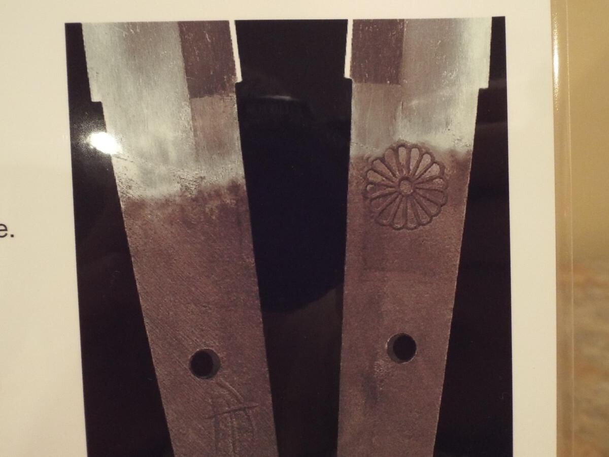

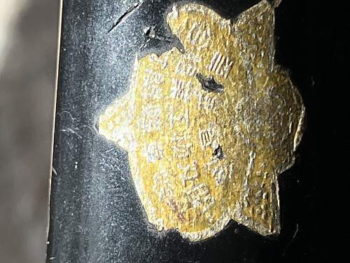

Bruce Pennington Posted March 29, 2021 Report Posted March 29, 2021 On 12/6/2016 at 1:36 PM, IJASWORDS said: Hi Bruce, found this logo under a leather combat cover, in a gold foil finish. Looks like concentric circles with a "H" or "I" in the centre. Any ideas? Neil. Neil, Any chance of finding out if there is a dated blade in this? Or does it have the large Seki stamp on the blade? Quote
IJASWORDS Posted March 29, 2021 Report Posted March 29, 2021 Bruce, this saya housed an old family blade, and is an old saya, as evidenced by the remnants of its original KURIKATA. To me, I suspect that the SEKI company also did re-mounts of old swords and mounts into gunto. This has a leather combat cover, which luckily preserved the foil label. Hope this helps. 1 Quote
Bruce Pennington Posted March 29, 2021 Report Posted March 29, 2021 28 minutes ago, IJASWORDS said: Bruce, this saya housed an old family blade, and is an old saya, as evidenced by the remnants of its original KURIKATA. To me, I suspect that the SEKI company also did re-mounts of old swords and mounts into gunto. This has a leather combat cover, which luckily preserved the foil label. Hope this helps. Yes, thanks Neil. The labels are turning out to be more varied in their use than I first thought. Some are on gunto with Seki-made blades, but some, like yours, have something else entirely in them, and maybe the label is more for "finished gunto product" type of meaning. Some are on 1942 gunto, and some are on late war gunto like @Shamsy posted. So, my original idea that they were used in the last couple of years to replace blade stamping is out the window too. Quote

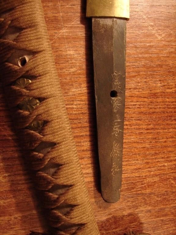

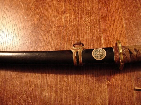

sbf Posted March 30, 2021 Report Posted March 30, 2021 Over the years I have owned swords with both the foil and paper labels on gunto swords. All of them were Seki showato. Perhaps the foil label as on Neil’s older blade was a retailer’s label. Steve 3 Quote

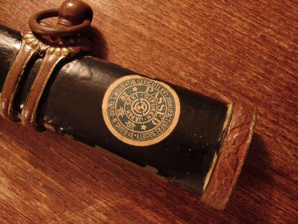

Kiipu Posted March 30, 2021 Report Posted March 30, 2021 On 12/6/2016 at 12:36 PM, IJASWORDS said: Looks like concentric circles with a "H" or "I" in the centre. Any ideas? The concentric circles are the katakana characters セ and キ, one over the other. The セ is at the top and the キ is at the bottom. The kanji character in the middle is 工. This is more than likely the logo of 関刃物工業組合 [The Seki Cutlery Manufacturers' Society]. There is another logo that is similar and one can more clearly see the katakana characters over one another. Arsenal Stamps., Post #100 Edit: Post #4 partially answered the question. 2 Quote

Stephen Posted March 30, 2021 Report Posted March 30, 2021 Pretty sure it was added. Gold labels are always on saya which for the most part black lacquer. The gold stamp is from sword shops. The blue from seki cuttlery co. 1 Quote
Bruce Pennington Posted March 30, 2021 Report Posted March 30, 2021 Added by who though? I would be really surprised if these could be peeled off, postwar, and applied somewhere else. 1 Quote
Kiipu Posted March 30, 2021 Report Posted March 30, 2021 The blue and gold labels both have the same logo and name on them. Both labels have the name spelled from right to left. The labels can show up on either a scabbard or a scabbard cover. Both labels are overwritten or overstamped, either with a person's name or date stamp. 関 = Seki. 刃物 =Hamono = Cutlery. 工業 = Kōgyō = Manufacturers'. 組合 = Kumiai = Society. As far as I know, the association was established in 1931. 岐阜県関市における刃物産業の歴史的な発展過程 2 2 Quote

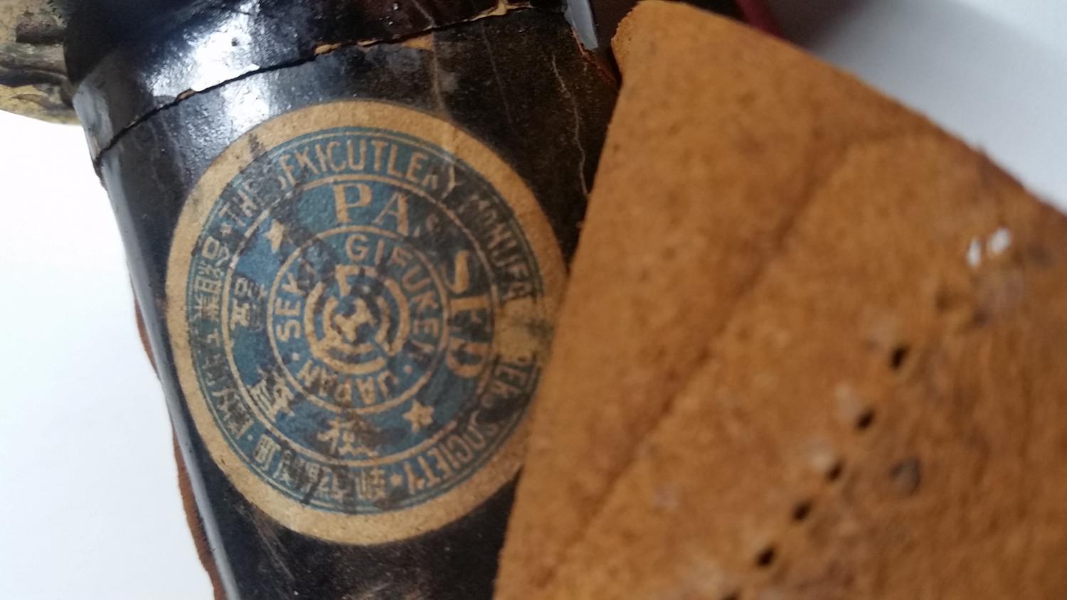

Kiipu Posted April 8, 2021 Report Posted April 8, 2021 With the help of BangBangSan, I have transcribed the kanji characters that appear on the blue label. On the label, the characters are written from right to left. However, below I have reversed the order to left to right. I have used the translations that appear on the blue label. The characters 檢査證 translates as "inspection certificate" while the label uses "Passed." There are minor differences in the appearance of the characters between the various blue labels indicating different printings. Keep in mind that these labels are frequently overstamped or written upon by the various inspectors. 関刃物工業組合 = Seki hamono kōgyō kumiai = The Seki Cutlery Manufacturers’ Society. 岐阜縣関町 = Gifu-ken Seki-chō = Seki, Gifuken, Japan. 檢査證 = kensa-shō = Passed. Old to new character conversions. 縣 = 県. 檢 = 検. 證 = 証. 1 1 Quote

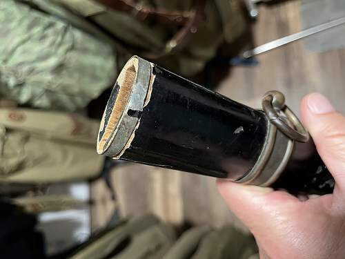

Bruce Pennington Posted October 18, 2021 Report Posted October 18, 2021 Another gold label. Late-war fittings - black painted wood saya, leather covered. On Warrelics Thread. Quote
Bruce Pennington Posted September 10, 2022 Report Posted September 10, 2022 Another one posted by @Eds HERE on a kaigunto: 2 Quote

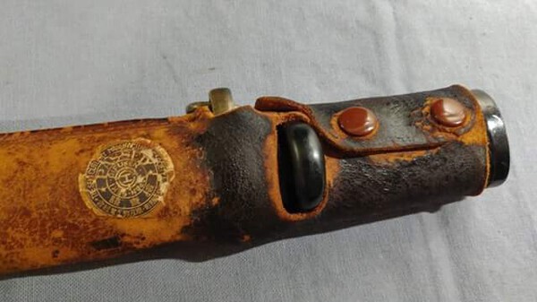

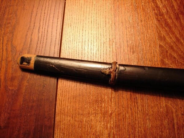

Bruce Pennington Posted June 24, 2023 Report Posted June 24, 2023 I wish we knew more about the Seki Cutlery Manufacturers Association. They had stamps for blades and labels for fittings (or was it for the whole completed rig?). To back up Neil's - @IJASWORDS - point, this rig highlights that the stickers are not relegated to low quality, late-war gunto. Here is an Edo/Kanbun era, Kiku bearing, Kanemichi blade in wooden saya and leather cover. This one has the label on the leather drag!!! and inside on the saya itself. Found on this Wehrmacht-awards Thread, posted by Bob C. Scroll through to the second page to get the rest of the photos and discussion. Quote
