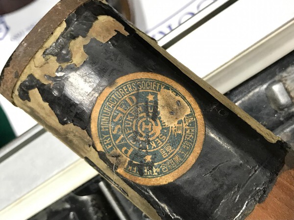

Hi all.  I was at a show over the weekend when an old fellow stopped and was carrying a sword.
Not to drag this on any longer I was able to get it apart.  The blade was un-marked typical war time made blade nothing special. The blade had no Seki stamp on the tang though which I thought was odd since it appears to have been made there and inspected there.  Has anyone seen one of these stickers on a saya ?  This would be of course under the combat leather cover so its not easy to see without taking it off.  Odd thing is its in Japanese and English ??  Odd I thought.
Sword wasn't for sale old guy just wanted some info.
Both these labels have the same circular Seki manufacturer logo. The circle is actually a stylistic "Se" over the top and "Ki" around the bottom, with the factory's logo in the middle. I am on the road and don't have my books so I don't know if this One is known. But the Seki area had quite a number of factories working and each one might have had their own logo. The label appears to be an inspection/approval and is called "rare" in the F&G book.

Interesting. I wasn't looking at swords in 2008 so I never saw that post thanks.  I guess I should have made an offer.  The sticker might be rare but the sword was anything but.  No sense overpaying and I'd would have had to to  pry it out of his hands.
Just wanted to save the image and share it.
I've seen these before but never in this nice readable condition. I always thought they were simply shop stickers. The ones I recall all seemed to be on black wood saya. The English language PASSED sticker is pretty interesting. It would be very interesting to data these things.
Peter
Peter to be honest I always thought it was the logo of the SAYA maker, or sword assembler at the "officers club" as well. It is interesting how one post can lead down a track of discovery!! May be should be logged in section of arsenal marks. Neil.
From the Japaneseswordindex, here is an example I was talking about. There are more like this, each with a different logo inside the Seki circle:

I saw the thread this morning but didn't get to reply until now. Looks like it's mostly been said. Rare sticker as noted in F&G. These are attached to low quality saya, black painted with crudely cast fitting. The sword blade and the quality of the accompanying fittings are of a similar nature. Have a look at the sword in this thread and my own example.

Good observation though, Shamsy! I wonder if the labels were something unique to Seki operations, or something initiated late in the war to try to keep quality from dropping too far?
The two stickers are quite distinct. I've never seen the paper one on anything but the low quality, wooden black painted saya. Maybe they are different because they represent different grades of swords? The sword Wayne saw is most definitely a distinct model and I'm glad to hear that confirmed. I've not seen many of the golden stickers and never had one in hand, so I've not got a lot to add there apart from conjecture.
I'm not sure I completely agree with Daves assessment of pre war. I base that on the fact that the fittings on the saya are distinctly military in nature and low quality. They do not seem to be something made for civilian use, but I suspect that these are more likely part of a group made towards the end of the war when materials were scarce. They are still above the grade of the NCO swords, but very much below typical military gunto standard. They usually lack same to, with paper, cloth or cardboard used. They are not assembly pieces because they are too homogeneous and exhibit too much genuine wear and patina. Remembering that Seki was a collective of individual smiths and craftsmen. It is by no means difficult to imagine this is where these swords come from. Cannot rule anything out of course, but I feel there is enough evidence to suggest a distinct, late war model.
As to value Wayne, hard to say. I usually look at scarcity over condition, though I think you were about right in valuation of the piece you saw. I'd not pay a lot for one in poor condition, nor would I expect to make money selling one later when people prefer a good condition but standard sword over a rare but somewhat worn example. This is one of my favorite swords though so I'm not a good option to provide a valuation.
The Sino-Japanese war began in July 1937, the Pacific War in December December 1941. Japan was already suffering shortages and inflation before Pearl Harbour, so I would have no problem believing there was already severe degradation of their kit before the War with the US and Britain.
 I would have reservations about them using English labelling after that date, not impossible but I would find it odd.

Hi All, here is some photos of the sticker and the sword (leather carefully removed). It is an old MUMEI blade (looks EDO,) looks like old leather/wood TZUKA wrapped GUNTO style, nice old iron TSUBA, SAYA has remnants of a KURI-GATA. Does this add any value to the discussion? Neil

That’s cool! I can actually read this one - “The Seki Cutlery Manufacturers Society “
