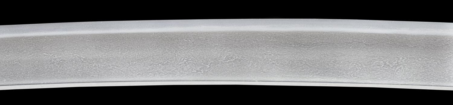

Hello,
at the moment I have a wakizashi at home. Hirazukuri, nagasa 38,8 cm, sakizori. Special feature is: you have two different kind of steel.
The upper part is in itame, the rest in masame.
My question is: do you see that often or is this a a trademark of a school and time?
Thank you for your help!
Uwe G.
3,16 MB download:  http://daten-transport.de/?id=7NPUV3gJXE6D
Photo attached. Itame/mokume in the ji with masame along the edge is, among others, a trait of some Yamato blades (specifically Shikkake). Your sword does not look like a Shikkake though. Can we see a more complete photo?

Thank you all for your help.
Masame in the shinogiji is usually more common and a honsanmai construction in a hirazukuri blade confused me a little bit.
Some words about the blade. It is signed with a single kanji: Sa. I know, that there are several generations and
Oishi Sa, etc. But this one is not Soshu. But still a blade to enjoy.
Uwe G.
