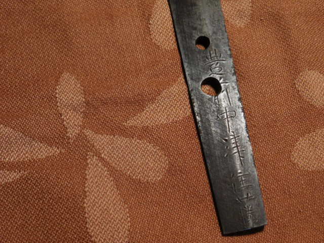

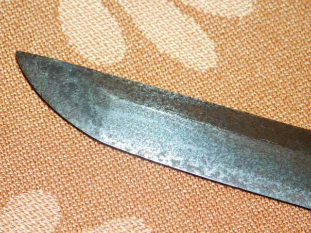

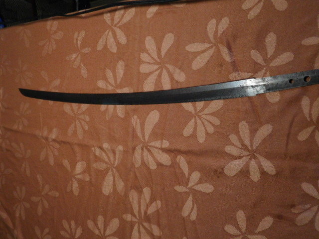

A little while back, new member Jason posted on this sword asking for opinions....initially I thought it might be fake primarily due to some patina issues. I made an offer to evaluate in hand and Jason sent the sword to me. With careful study, some TLC, and in consultation with Bob Benson, I made the call for Momoyama Keicho Shinto period by a smith from the Fujiwara Takada group, probably from a smith named Tomoie, of whom oshigata have not been found yet.. I feel that this sword is worthy of preservation as an example of a little known smith in an under-documented area of Kyushu, Buzen being overshadowed by Bungo, Chikuzen, and Hizen. Examples of Tomoie's work are dated to Enpo, but little is known of his/their life and I feel based on sugata, hamon, and jihada, that it could date to anywhere from 1596 when Nakatsu was established, up to the dates listed in the Nihonto Meikan in Enpo. The hamon is a suguha based togariba, with running masame on the shinogi ji and a compact hada in the ji that almost seems muji; this is typical of the early Fujiwara Takada group. This sword after appropriate conservation is an excellent shinsa candidate; I have no doubt it will receive Hozon. My sincere thanks to Benson Sensei for his assistance.

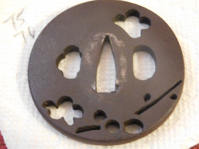

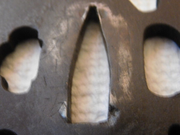

Bonus was the tsuba being inscribed Kofu ju Akao Yoshitsugu... it just needed some TLC and help from the translation pros here on NMB.....thanks guys.

It is unfortunate that the suriage removed so much of the mei,and somewhere in its journey had the patina removed from the nakago.....still, i am appreciative of the trust Jason placed in me and having the opportunity to study this sword in hand. The research necessary to kantei this sword was extensive but worthwhile, and I got to see a lot of work online that I may not have seen otherwise. Rescued from obscurity for $20 at a swap meet table....amazing. Equally amazing is how many swords still languish in an attic or closet somewhere, neglected and rusty, or (even worse) hacked away at with sandpaper or grinders etc by uninformed DIY guys. NMB is a great resource as are the members who are  dedicated to Nihonto preservation. Salute!

I hadn't seen this post or I would have commented earlier.  I am very thankful that Steve offered his evaluation of the sword at no cost.  He had it in hand for several weeks and put a lot of time and effort in both researching the blade and performing a window polish in order to get a better understanding of it's pedigree.  I was very happy with the results.  As was mentioned, it is a worthy sword to preserve and at some point I would like to have a full polish completed and send it to shinsa.  It's my first nihonto and I couldn't be happier with this $20 swap meet find.
