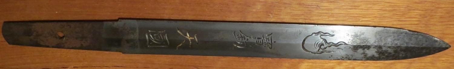

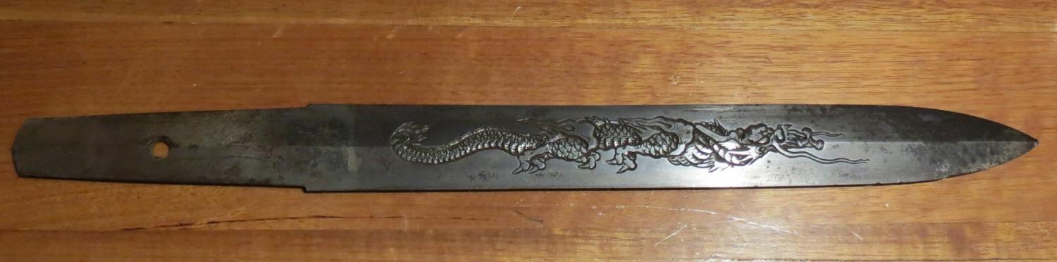

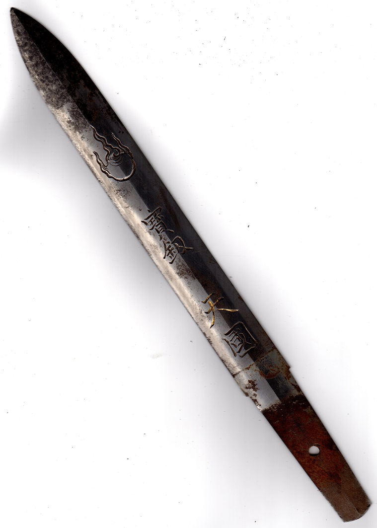

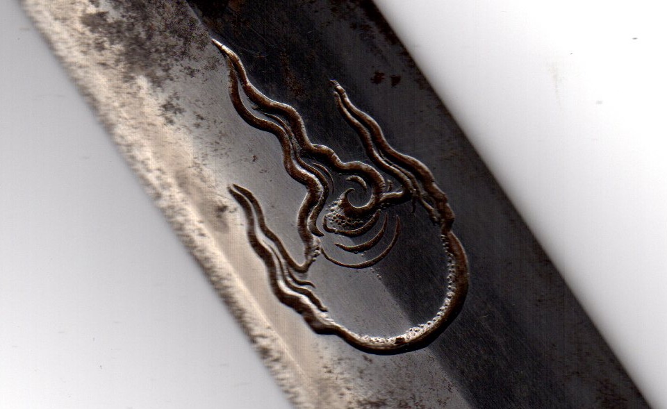

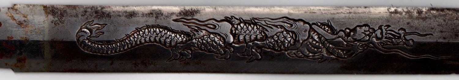

FletchSan Posted November 28, 2016 Report Posted November 28, 2016 Hi all, I received the very interesting tanto / ken that was originally discussed here in respect to the translation of the horimono. http://www.militaria.co.za/nmb/topic/21026-horimono-translation/ The dragon horimono in particular is very impressive in hand. I've taken a few more photos which reveal a little more detail. The nagasa is 31cm and width motohaba is 3.7cm I'm guessing the only way to really identify the smith in this case would be from the horimono (assuming the smith did the engraving). Is anyone aware of any good references of horimono dragons? I'm assuming the blade is probably meiji period based on the nakago patina alone. thanks, Ben Quote
Stephen Posted November 28, 2016 Report Posted November 28, 2016 neat little ken. not knowing the worth id still consider having rust removed Quote
Brian Posted November 28, 2016 Report Posted November 28, 2016 Agree with Stephen. Tidy little horimono, not one of the cheap and nasty ones we often see. Since it is short, I would have it polished. Quote
Ken-Hawaii Posted November 28, 2016 Report Posted November 28, 2016 The only thing that bothers me is that the sides of the blade are parallel, while in every true ken I've seen, they indent slightly at the middle. Looks nicely-made, though. Is it hard to polish horimono? Ken Quote
FletchSan Posted November 28, 2016 Author Report Posted November 28, 2016 I was wondering the same thing and also how much detail you may lose in a polish. Quote

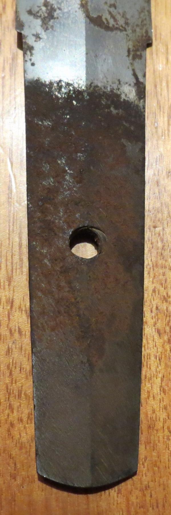

ggil Posted November 29, 2016 Report Posted November 29, 2016 Pitting isn't bad then the polisher needn't cut too deep I don't think. If I was a polisher I wouldn't touch the horimono. They aren't Hallam San after all. Seriously if the dragon isn't red and rusting then they should leave it alone and let the dark contrast to the light and pop, imo. Nakago looks to have lost some patina and is rusting. Quote

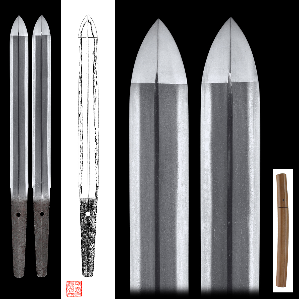

FletchSan Posted December 24, 2016 Author Report Posted December 24, 2016 Saw this today on Aoi Art. It is also a straight Ken. Obviously much older but interesting to see another one with parallel edges vs. a traditional Ken shape.http://www.aoijapan.com/ken-mumei-atttributed-as-kanetaka Quote
Grey Doffin Posted December 24, 2016 Report Posted December 24, 2016 Hi Ben, The best reference I know of for Horimono in general, rather than from a specific smith or school, is Nihonto no Horimono by Dr. Sato. Here's a link to the book on my site: http://www.japaneseswordbooksandtsuba.com/store/books/b570-nihonto-no-horimono-dr-sato Can't tell you if it will help identify your smith, though. Happy holidays, Grey Quote
