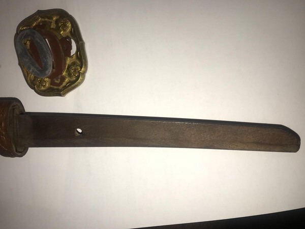

zamzamini Posted January 23, 2018 Report Posted January 23, 2018 Hi Everyone, Thank you so much for all of the replies. I have attached additional pictures. To me it appears that there is no stamp and there is no evidence of removal of a stamp. Sorry I can't figure out why these photos are being rotated 90 degrees. Thanks again! Ken Quote
Stephen Posted January 23, 2018 Report Posted January 23, 2018 I see a obviously removed sho stamp. 3 Quote
