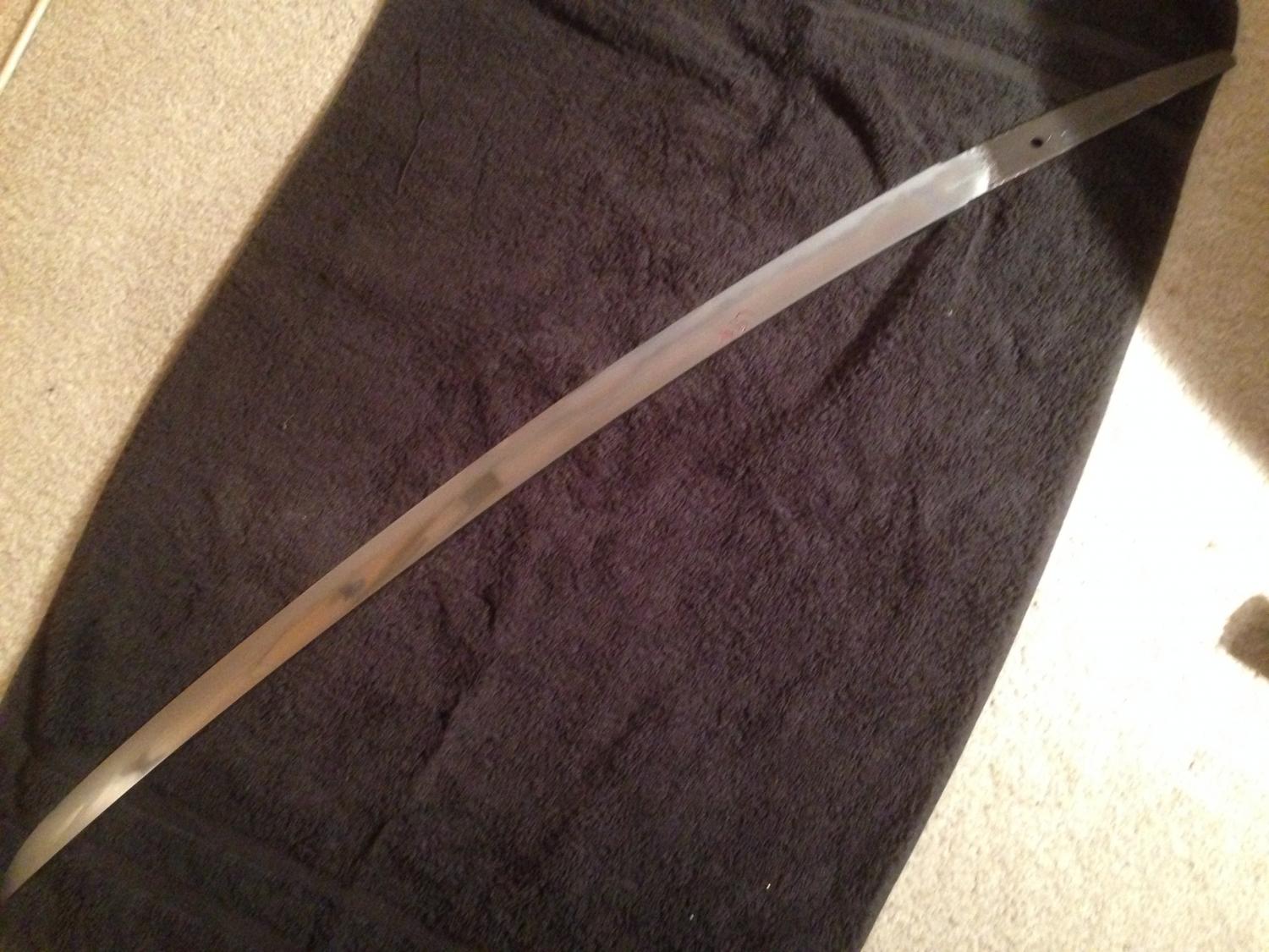

hxv Posted November 24, 2016 Report Posted November 24, 2016 I have a hirazukuri daito with 28in nagasa - a gendaito signed Minamoto Yoshimume. The last hirazukuri daito I saw was for sale on nihontoantiques a few months ago. As Ken says, they are rare. Hoanh Quote

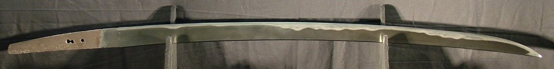

Shugyosha Posted November 24, 2016 Report Posted November 24, 2016 There's a nice example here: http://www.seiyudo.com/ka-090116.htm I remember reading somewhere that longer hira zukuri blades were more prone to cracking during the quenching process but I can't remember where I got that from. Best, John 2 Quote

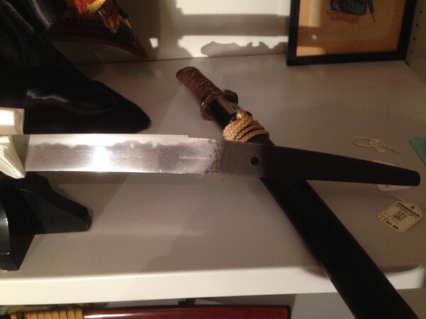

C0D Posted November 24, 2016 Report Posted November 24, 2016 Here's mine, Shimada Sukemune suriage, nagasa: 53.6 cm (guess around 60 cm originally). Late Muromachi 3 Quote

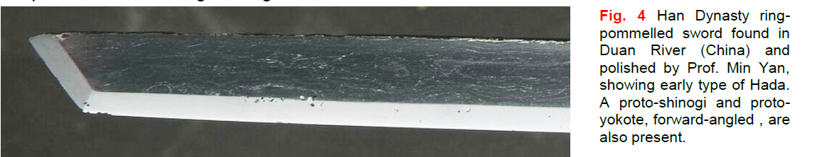

Carlo Giuseppe Tacchini Posted November 24, 2016 Report Posted November 24, 2016 The matter is much older than appears in these comments. The Shinogi (ridge) first appeared in China at least during the Han dynasty and entered Japan as soon as the trade allowed it. Shinogi (ridge) is a natural addition to the flat (Hirazukuri) blades in order to obtain a more performing sword and is mainly intended for long and medium blades. It firstly appeared in Kirihazukuri blades. These blades has the advantage in having a thicker and consequently heavier and more resistant body maintaining a thin, hence sharp, edge thru the application of an angle. The result is a 5 sided cross section. This is a very good enhancement for swords that might strike hard objects as armor or bones. A thinner triangular section (Hirazukuri) is sharper but also more prone to break due to the shocks mentioned. More, the beefier upper section of Kirihazukuri gives more weight to the kinetic action, and this possibly remedied to the lesser cutting ability. With time swordsmiths realized that to move up the Shinogi would mean to add sharpness to the edge, in some way mixing the Kirihazukuri (upper part of the blade, above the Shinogi) and Hirazukuri (lower part of the blade, below the Shinogi) maintaining a five sides cross section. This proved to be the more effective cross section for long blades in Japanese history, with a perfect mix of resistance, weight placement and cutting ability. 1 1 Quote

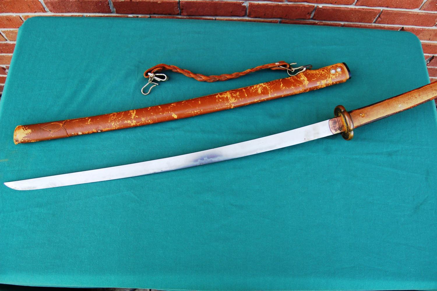

peterd Posted November 24, 2016 Report Posted November 24, 2016 Hi I was under the impression that Hira-zukuri were the sharpest blades. The more acute the angle the sharper the blade. Shinogi-zukuri reach full thickness at approximately 2/3rds of the way up. Hira-zukuri are not at full thickness until the top the blade. Like hollow ground (cut throat) razors Please fill free to educate me However i believe they are more likely to crack in tempering and in battle. Here mine 27"shinshinto blade, gimei 1 Quote

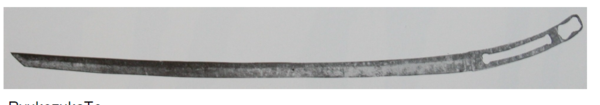

Carlo Giuseppe Tacchini Posted November 25, 2016 Report Posted November 25, 2016 Some very early blades might resamble what you refer to.Shōsō-in Depository have some... : Quote
