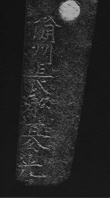

Paul Martin Posted March 18, 2008 Report Posted March 18, 2008 I just come across this and thought about this thread. It is from Katana no Kansho by Nakahara Nobuo*.....*Loosely translated,To call swords that begin with Bizen Kuni Osafune Ju chumon-uchi, and swords that begin with Bishu Osafune kazu-uchi mono has absolutely no basis and is nonsense.Best Quote
Jean Posted March 18, 2008 Author Report Posted March 18, 2008 Hi Paul, I am very surprised by this sentence : Quote To call swords that begin with Bizen Kuni Osafune Ju chumon-uchi No it is called Gimei, the syntax according Honma Junji (and all examples I have seen on papered swords) is "Bizen Kuni Ju Osafune ...." There may be exceptions but Honma Junji has never encountered one ... There was a topic about this and "Bishu Osafune...." mei viewtopic.php?f=3&t=2531 Quote
Paul Martin Posted March 18, 2008 Report Posted March 18, 2008 I was just testing to make sure you were taking notice :D If you read the original Japanese I posted, it reads correctly ( I did say it was a loose translation :D ) Also, Chumon uchi was a relatively unknown smith, often called Chu by his good friends. Best Quote
