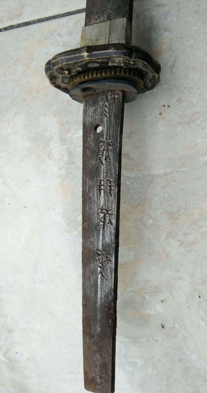

truelotus Posted November 7, 2016 Report Posted November 7, 2016 yeah, it is easier to ask ...could anyone help ? thank you in advance Donny Quote
obiwanknabbe Posted November 7, 2016 Report Posted November 7, 2016 Hard to read upside down but it looks dremel cut. I smell chinese copy. Others please chime in. Kurt K Quote
Gilles Posted November 7, 2016 Report Posted November 7, 2016 It does't look like Japanese kanji to my humble opinion. Quote
truelotus Posted November 7, 2016 Author Report Posted November 7, 2016 dear all thank you for your inputthis was belonged to an old gunto in indonesia, whilst I am aware that there are lots of chinese made gunto out there, the koshirae of this one seems genuine. The owner said he sanded the nakago parts to see the kanji without knowing itI still believed the sword is genuine, though the nakago is somewhat dubioushere's another in correct position Quote

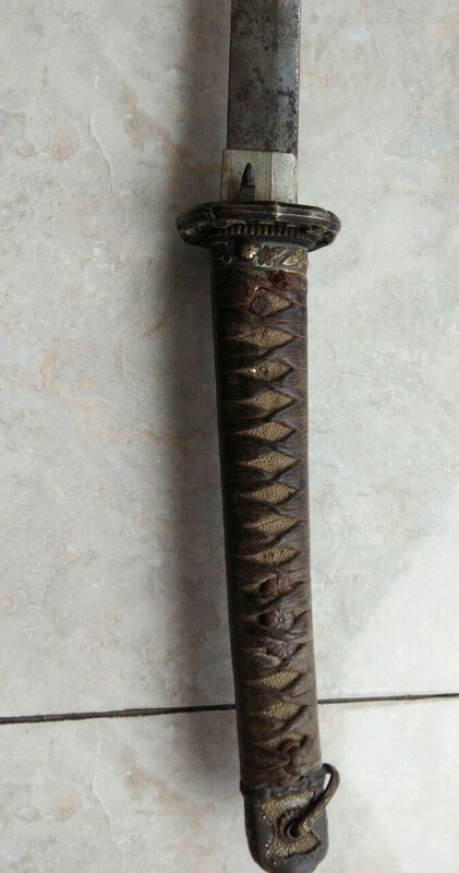

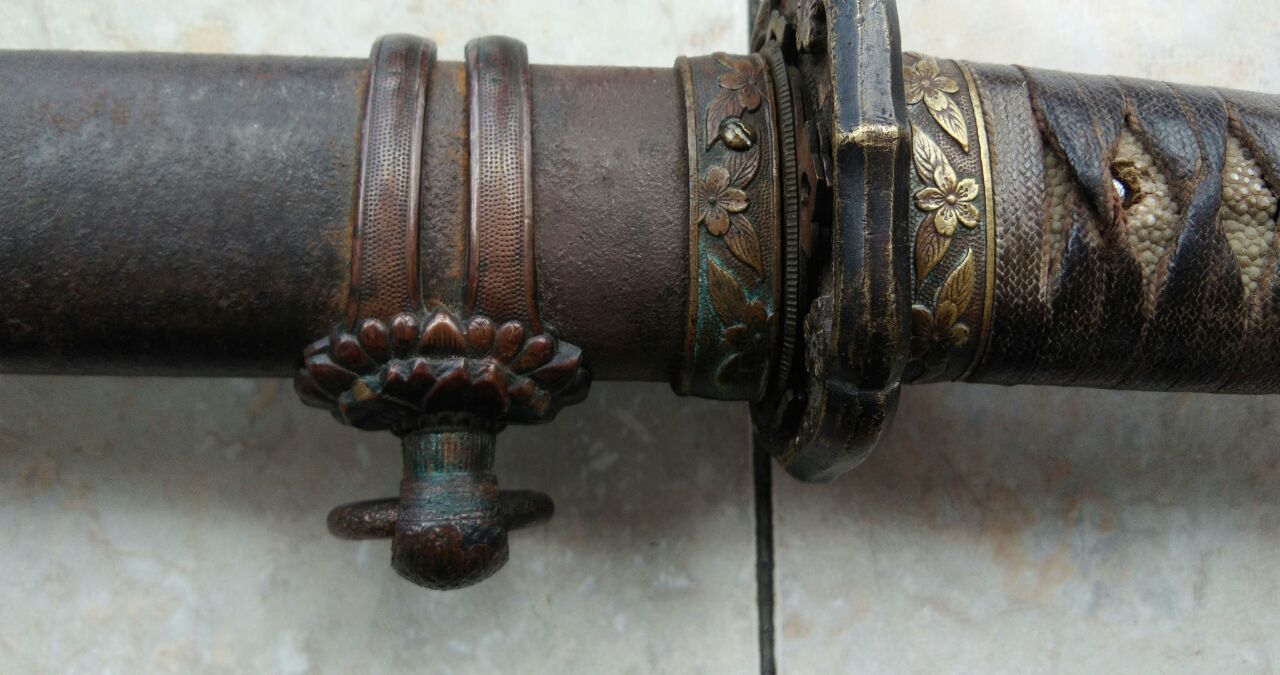

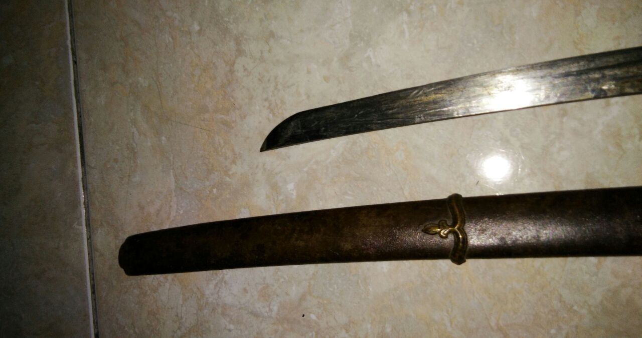

truelotus Posted November 7, 2016 Author Report Posted November 7, 2016 here's the rest of the swordwe can see clearly the koshirae is of true type 98 shin gunto, missing only ishizuki (scabbard tip) Quote
truelotus Posted November 7, 2016 Author Report Posted November 7, 2016 On 11/7/2016 at 8:28 AM, Jean said: Strange kanji chisel strokes... agree, Jean ... the whole package seemed allright, as there are no Indonesians capable of making gunto koshirae, so basically the chance that this was fake is somewhat low but I cannot say about the mei, looked weird to me, also Quote
truelotus Posted November 7, 2016 Author Report Posted November 7, 2016 this just crossed my mindis it possible that the sword was actually MUMEI, then someone with too much time, wanted it to be more expensive and carved something on the nakago ??Donny 1 Quote
Stephen Posted November 7, 2016 Report Posted November 7, 2016 bingo Donny, and a crappy job he did 1 Quote
truelotus Posted November 7, 2016 Author Report Posted November 7, 2016 On 11/7/2016 at 10:13 AM, Stephen said: bingo Donny, and a crappy job he did F*** !! I really hated when someone did that to a nihonto ... truly destroyed the sword !!!! no wonder it looked very odd Quote

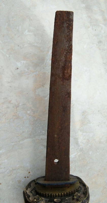

ROKUJURO Posted November 7, 2016 Report Posted November 7, 2016 Donny,to me, the blade does not look genuine. There are not enough good photos of the blade itself to support my feeling, and the corrosion is quite bad, but I see a NAKAGO with a wrong shape - SHINOGI not clear and in an unusual position - and wrong YASURI ME. There are genuine GUNTO with a kind of erratic filework, but mostly not that bad. The MEI is not in a good position in relation to the MEKUGI-ANA.It would help to see clear photos of the naked NAKAGO with everything stripped, especially the HABAKI. If HA MACHI and MUNE MACHI are on a level, it might nonetheless be a Japanese war-time blade.KOSHIRAE-wise, everything seems genuine indeed. Quote
obiwanknabbe Posted November 7, 2016 Report Posted November 7, 2016 Agreed jean. The file work looks completely wrong. The habaki is most certainly not made for this blade. If anything, its a VERY late war sword with genuine fittings assembled around it. Kurt k Quote

truelotus Posted November 18, 2016 Author Report Posted November 18, 2016 thank you for all of your inputI already received the sword, and it's a mumei shinto blade in gunto koshirae - true nihonto in quite good conditiontoo bad someone (incredibly stupid one) carved kindergarten-kanji-version of mei on the nakago Quote
