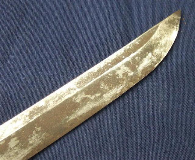

Peter M Posted February 4, 2008 Report Posted February 4, 2008 Hello all, I am looking to encroach on the good natured and immensely informed people of this forum to make comments on the following Wakizashi I have agreed to purchase from an ebay seller. http://cgi.ebay.com.au/ws/eBayISAPI.dll ... 0206961020 The seller lists it as; “It is minced with "BISHU-OSAFUNE-KATSUMITSU". This sword is a work of the Muromachi period (1392-1491) of Japan. I think that this is work of "JIRO-ZAEMON-JO-KATSUMITSU†I did a search for the JIROZAEMON KATSUMITSU and found the following information from http://www.sho-shin.com/sue2.htm Any and all comments are welcomed and greatly appreciated thanks Peter M Quote
Ichi Posted February 4, 2008 Report Posted February 4, 2008 I'm at work and can't access to my books. According to the attached registration, this sword was registered on Dec 17, 2007 and issued by Okinawan Prefecture. It means that this sword was found recently. The length is 54.3 cm and 1.5 sori. "Museum Class" ? I doubt it. Quote
Jean Posted February 4, 2008 Report Posted February 4, 2008 Peter, Few chances to have a museum class sword with mei beginning by "Bishu Osafune ....". Should have it been a museum class sword, Katsumitsu should have at least chiselled the nengo, put is personal name "Jiro..." The mei (signature) should have been something like : "Bizen koku Ju osafune Jirozaemon no Jo Katsumitsu (saku)" and the date "nengo" chiselled on the other side of the Tang (nakago) But that a general rule, there always exceptions (but scarce) Quote
Peter M Posted February 4, 2008 Author Report Posted February 4, 2008 Hello, Thanks for the replies. After my quick search and with your inputs it would indeed be a bit of a stretch to label the sword smith as JIRO-ZAEMON. I would like to ask a few questions 1. can the mei be translated? If so what is the translation? 2. Given that the OSAFUNE school was a prolific sword producing area, practically in Wakizashi during this mid to late Muromarchi period, would it be too much to at least ascribe the piece to the dates that are listed in the auction? 3. Are there any doubts concerning authenticity? The papers that come with it are, to my limited understanding, just registration papers, however these papers are only issued to Nihonto? Erol thanks for your reply, Any chance you could dig up any information you might have? I know it is a huge ask!!! :D :D :D Jean thanks for your reply. Can I ask for further clarification of your statement; “Few chances to have a museum class sword with mei beginning by "Bishu Osafune ....". do you mean that as the area was prolific the production numbers alone would decrease the value? I will probably have a few more questions as I read through replies so please bear with me. Quote
Jean Posted February 4, 2008 Report Posted February 4, 2008 Hi Peter, Blades with mei (signature) beginning by "Bishu Osafune ...." are generally considered like being mass product swords during this period (Warring states) cf. following link. http://www.wsu.edu:8080/~dee/TOKJAPAN/WARRING.HTM Ten thousands of blades were forged during this period - Bizen (Bishu) being the most prolific for mass product swords, followed by Mino (Noshu). However, even if the mei begins with "Bishu Osafune ..." : If there is a nengo (date) on the tang (nakago) : it is better If there is an original hi : it is better .... Now to date this sword is almost impossible, it is a typical uchigatana made to be wielded with a single hand, I shall say probably late 15th/beginning 16th century. Starting Tenbun nagasa (cutting edge) was longer. It is compatible with Eisho era (1504) The mei reads "Bishu Osafune Katsumitsu" : Katsumitsu (swordsmith)of Osafune (Village) of Bizen (Province) Suguta (shape) looks like Bizen sue koto and nobody (right in his mind) is going to chisel Bishu Osafune on a sword (no added value ...). Quote
pcfarrar Posted February 4, 2008 Report Posted February 4, 2008 Looks like the sword was taken to WW2. It's lost its leather combat cover, I guess the solider hid the sword after the end of the war. I think it's quite a good buy for $600. Looks like it will take a polish. Suguta (shape) looks like Bizen sue koto and nobody (right in his mind) is going to chisel Bishu Osafune on a sword (no added value ...). I have a friend who had a koto wakizashi signed Bishu Osafune ... suriage. He tried to get it papered and it came back gimei. I've also seen a fair few shin-shinto Bishu Osafune gimei. Bishu Osafune mass produced blades were very popular because of their excellent cutting ability. There's a write up about it the JSS/US sue koto book. I think this made them a target for gimei. Quote
Jean Posted February 4, 2008 Report Posted February 4, 2008 Thanks Pete, I did not know that Shinsa could be so good as to determine from "Bishu Osafune" without the swordsmith name that the blade is gimei. Sue koto Gimei Bizen blades I have come across had "Bizen koku Ju ..." mei, or at least a nengo together with Bishu Osafune. If mass bundled swords were in fashion for Bizen cutting ability, I am not sure it is the case nowadays. I was assuming the blade is koto so I have ruled out shinshinto (nakago, hada, suguta, nagasa... are quite different). The mei seems to be quite old (from the same period as the sword), but only shinsa can confirm it or not . Which leads me to think that even if it is Bizen, at 95%, it can be a Kazu uchi mono. I say "it can be" because of the lack of polish. It could be after a polish a real gem. All in all, price+polish+shinsa = 2,5 k$ (more or less) - before doing anything I should have a window opened by a polisher. The Nakago patina has suffered to .... But, if the sword takes the polish as it is katana so why not... Quote
pcfarrar Posted February 4, 2008 Report Posted February 4, 2008 Sue koto Gimei Bizen blades I have come across had "Bizen koku Ju ..." mei, or at least a nengo together with Bishu Osafune. If mass bundled swords were in fashion for Bizen cutting ability, I am not sure it is the case nowadays. I can't remember exactly as I'm away from my books but its something about the edge going soft. Giving them the name "sweet" cutters. Quote
Peter M Posted February 28, 2008 Author Report Posted February 28, 2008 Hello all, First I would like to extend my thanks to the members off this forum for the above well thought out and informative posts. As I hate to read through posts and finally get to the end only to realise that the story has been left “hanging†so to speak I will post an update. I received the Wakizashi from the eBay seller kofudo_jp on Friday of last week and finally had the chance to have a look a Nihonto in person, a truly inspiring event shall we say. It arrived at my place of employment just before I was to give a lesson on Japanese military expansionism prior to WWII, so I had the chance to show it to a class of really amazed young students. Some students in my class are of Japanese ancestry and I was lucky enough to get an interpretation of the registration documents that came with the piece. I guess I can now claim it on tax!!! I have contacted a Nihonto restorer that is semi local to show the blade to sometime in early march to seek a further opinion on the restoration side of the project. This brings me to my first question. I have read through the following post made here on the topic of separating pieces of Japanese swords for individual sale with the pros and cons viewtopic.php?f=3&t=1681&st=0&sk=t&sd=a&hilit=preservation&start=15 With this post in mind…would it be justifiable to, and I can’t say restore in an archeological sense of the word, to purchase the remaining fittings (from the same approximate era) to bring the sword back to a semi state of originality, or just have the restorer make the new fittings direct. From the prices that the restorer lists for his services I believe the overall price would be roughly the same so the economic argument seems to me to be moot (???). Second question As visible in the pictures from the first posts link the blade has patches of oxidization in parts (perhaps being generous here). Some parts with no rust show the hamon quite well, and you are all going to hate this next sentence. The hamon is “wavy†which is an esthetic bonus for me :D . Anyway question is given the time frame to polish what is the best method of preservation of the blade until the polish can be done. The only thing on hand at the moment is rifle oil I am saddened to say, however I will be getting some medical mineral oil and some isopropyl as another forum has advised for maintenance after the polish has been completed. Any and all input is gratefully accepted Many thanks Peter McVeigh Quote
Peter M Posted February 28, 2008 Author Report Posted February 28, 2008 Oh yes one more question please I understand that the blade i have purchased is Kazu uchi mono. Is the classification of this blade solely based on the mei or are there any other "give always"? especially in terms of construction. From my uneducated eye the blade itself, were the oxidation is not present, does not show any "grain" hada (?) and appears like a mono steel blade. Question Is the category of Kazu uchi mono ascribed soley on the mei or are there “manufacturing†tell tales as well. And if so what would these be? Thanks Again Peter McVeigh Quote
Jean Posted February 28, 2008 Report Posted February 28, 2008 Peter, As long as you have not brought your sword to a polisher, nobody can say if the blade is kazu uchi mono or not, there is always a chance that it is a fair blade. On the French Forum managed by Kitsune there is a post it on Kazu uchi mono: http://token.alldiscussion.net/koto-f6/ ... n-t490.htm You can google it for translation Quote

Peter M Posted February 28, 2008 Author Report Posted February 28, 2008 Thanks again Jean, Still have two questions left for any that want to take a stab at it (my very first online pun :D ) 1. What can I do to preserve the blade prior to polish 2. Given that no real analysis of the blade could be conducted until after the polish should I be hunting for parts to make the blade complete with antique items or should I use new pices manufactured from the polisher or alternate store? Regards Peter Quote
Stephen Posted February 28, 2008 Report Posted February 28, 2008 peter i think a light oiling is all you need, IHO just a shirasaya is all for now, the poilsh will tell if you need to go forward. Do a good research on the togi youll want a well trained one for a first calss blade. Quote
Jean Posted February 28, 2008 Report Posted February 28, 2008 Peter, 1 - Ask the polisher to have a window opened in order to see if it is worth a full polish. Meanwhile, oil it slightly in order to prevent rust expansion 2 - Were I You, I'll wait the polisher answer before undertaking any fitting purchase, unless you prefer to get a complete set of fittings which could be used on your next peurchase, should this blade not being worth it. Take care Quote
Peter M Posted February 28, 2008 Author Report Posted February 28, 2008 Thanks again, the penny just droped!!! Jean, When you said early on in this post as well as just now, see if the polisher can "open a window" I assumed you meant open a slot in thier polishing schedule for my blade. Please correct me if I am wrong, you are saying to polish a small part of the blade to see what a full polish could bring. I got there (to my mistake) by the "Window of opportunity†I think I will wait to see what the polisher opinion is before further purchases. Thanks for the advice Jean Stephen I was thinking of a polisher in Brisbane Australia, as I am only an hour south. I have asked to see (via email) if I could drop by in a few weeks to have a look at how he works and hopefully ask a few questions. the link to the site is below http://www.jigokustudios.com/ I dont know of any others in Australia Will use the minerial oil I mentioned earlier in the meantime Thanks Stephen. Thanks again Peter Quote
sencho Posted February 28, 2008 Report Posted February 28, 2008 Please correct me if I am wrong, you are saying to polish a small part of the blade to see what a full polish could bring. Peter Exactly right Peter.... Also as Stephen says, do some research on polishers before you pick just one.... generally cheapest is definitely not best in the polishing process, but it is good to be informed by polishers at home and abroad. Plenty of knowledgable people in Aus, so ask lots of questions! Cheers Quote
