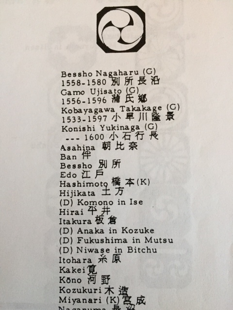

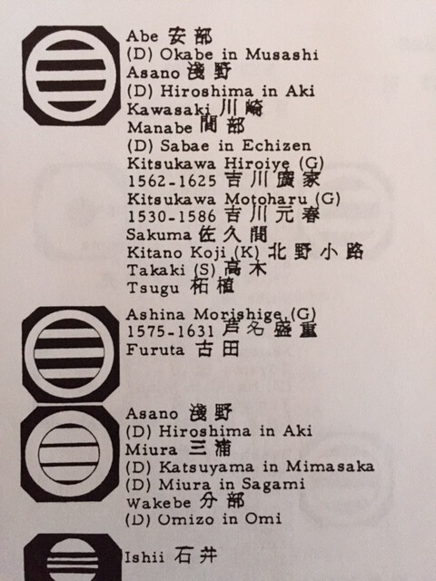

uwe Posted October 16, 2016 Report Posted October 16, 2016 Hi Bojan, Ian is basically right. Almost no chance for pinning down the families (clans) if there is no further information about the particular armor (-parts) bearing the mon. Not to disappoint you completely, here are some possibilities.... The kabuto: The dou: The fugikaeshi (second kabuto): Guess, now you can imagin why Ian not named any specific family 2 Quote
DaveT Posted October 16, 2016 Report Posted October 16, 2016 Sometimes you can pair a mon to a clan. For instance the Hosokawa made use of the etchu style which is very distinctive, same applies to the Date with the oshu/sendai style and the Ii with their red Hikone armours. Stepping aside from that its near impossible to marry a mon with a clan.As the others have said, they were used too widely by so many. 2 Quote
Bugyotsuji Posted October 18, 2016 Report Posted October 18, 2016 Yup, sadly I have to agree with the above. I have a beautiful wakizashi koshirae covered in the sideways Mitsu Hikiryo Mon on your Do above. "Miura?" Hopefully wagging my tail, I have shown it to several Japanese sword experts but they all seemed to shy away from naming any one family. 1 Quote
